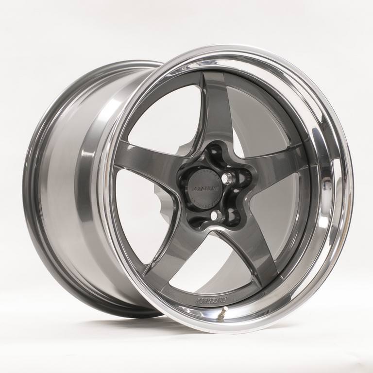

      What face finishing is that last wheel ? ☝��
      Sep 2012
      Dayton, Ohio
      1,406
      Quote Originally Posted by Bigoil View Post
      This GF3 Open Lug is Gunmetal.
