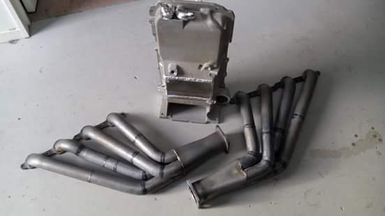

      Yeah I went ls7 style drysump on my 408 yeah it's a lot of work and cost associated with it. I did it to be different and add a bit of cool. I modified a ls7 oil pan. factorName:  FB_IMG_1511979355351.jpg

      Damien

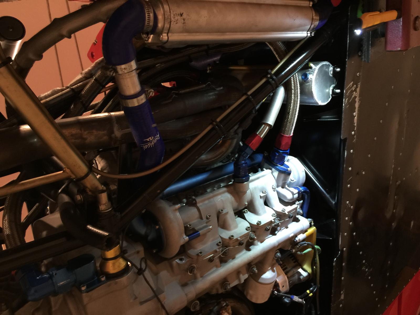

      Here's mine

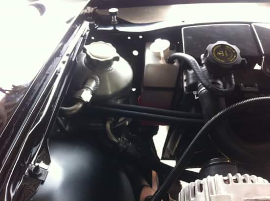

      Here's a proper dry sump setup :

      I'm a big fan of the Dailey Engineering pump/pan set-ups. They make a really good durable pump and the plumbing is simplified with their billet pan.
      Here's what my 5 stage looks like but their 3 stage works well for most.
