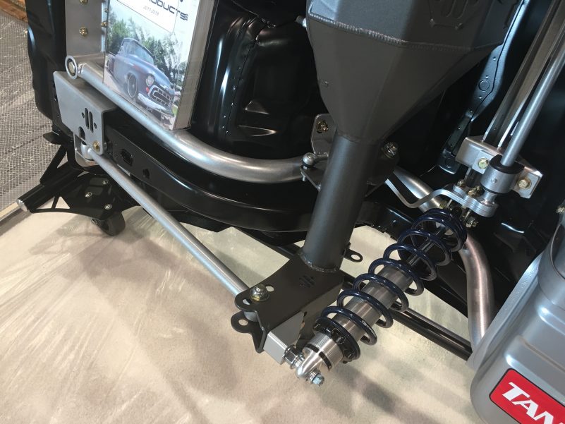

      To showcase the new design, I wanted to post a few pictures of the install on our customers 1978 Trans Am. This car is a solid driver with the factory V8 and 4 Speed.

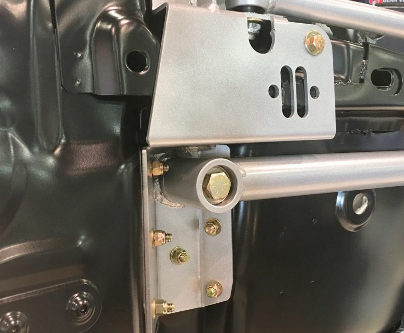

      The lower links and forward mounting points of the Unicradle index off of the front leaf spring eyes and bolt through the floor pan. The silver tube located inside of the OEM frame rail (at bottom in this photo) accepts the shock crossmember and adds structural rigidity to the rear suspension.

      Lower links mount to the front brackets and allow plenty of room for wide tires. For a 100% bolt-on installation, Currie Enterprises sells “Crate” rear ends with ridetech brackets already welded in place. The rear, lower link points are adjustable to tune roll steer and instant center. The kit accepts coilovers or ShockWaves®.

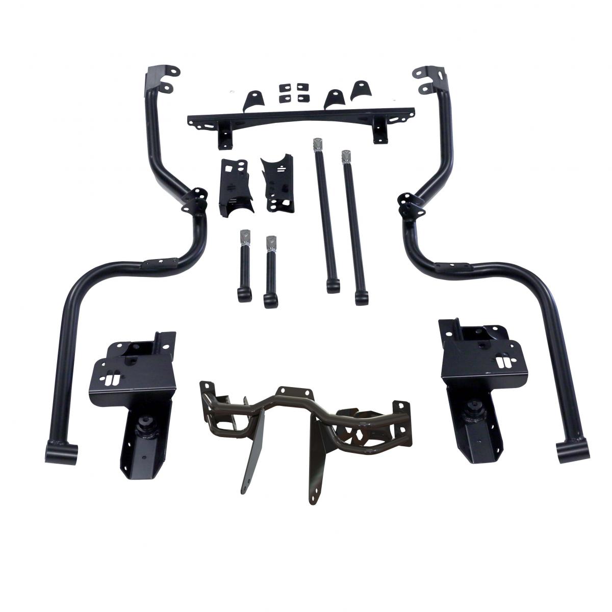

      It’s all here. The “unicradle” rear subframe rail, the lower link, the triangulated upper link (look closely) and the sturdy forward bracket that indexes of the front leaf spring mounting point.

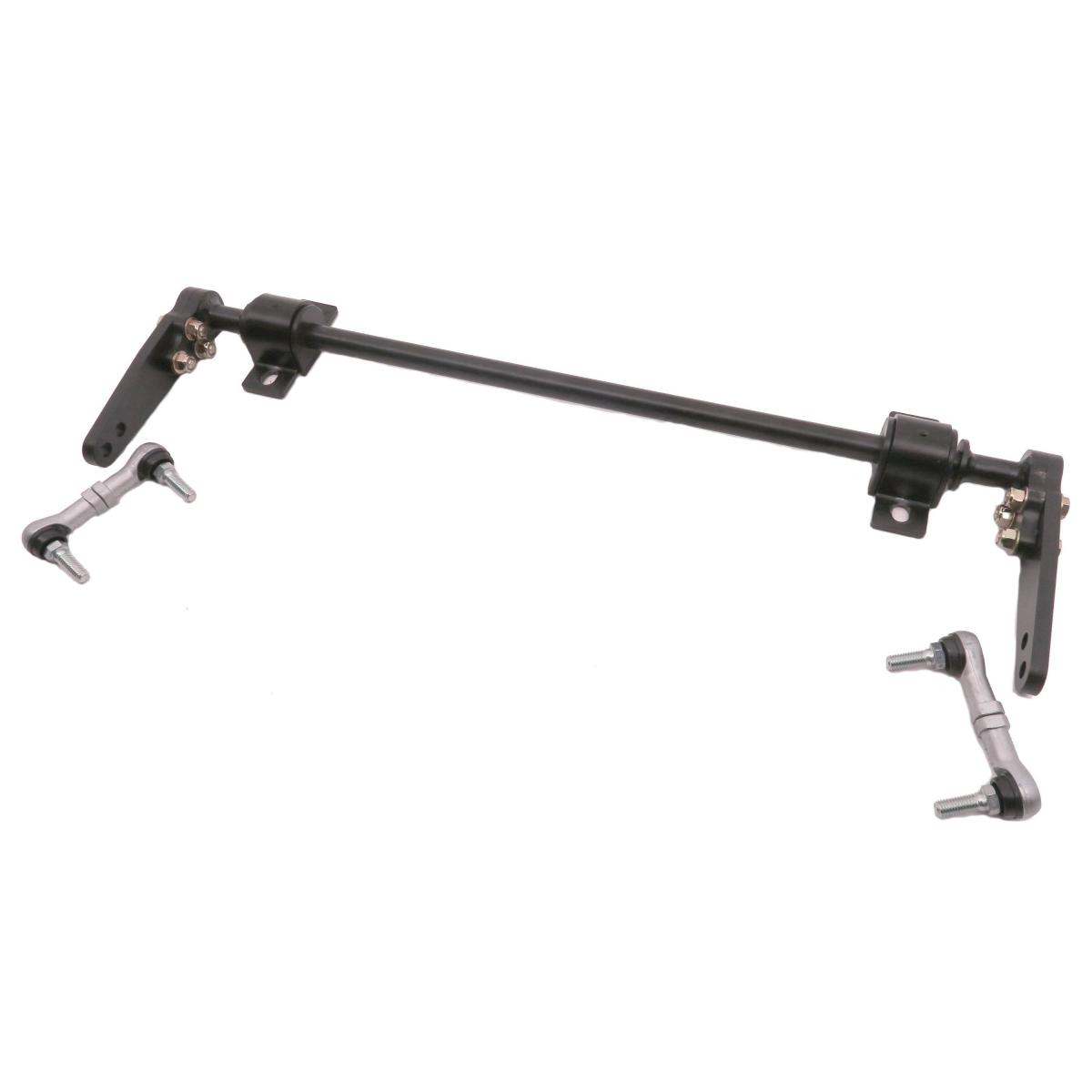

      The rear sway bar is a work of art and is adjustable to suit your driving style, The familiar RideTech icon is laser cut into the bracketry throughout.

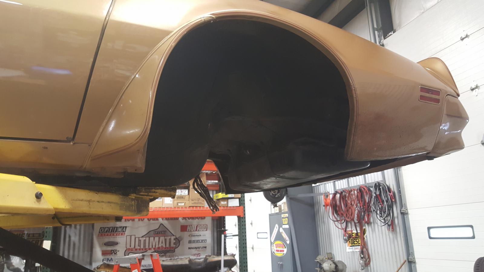

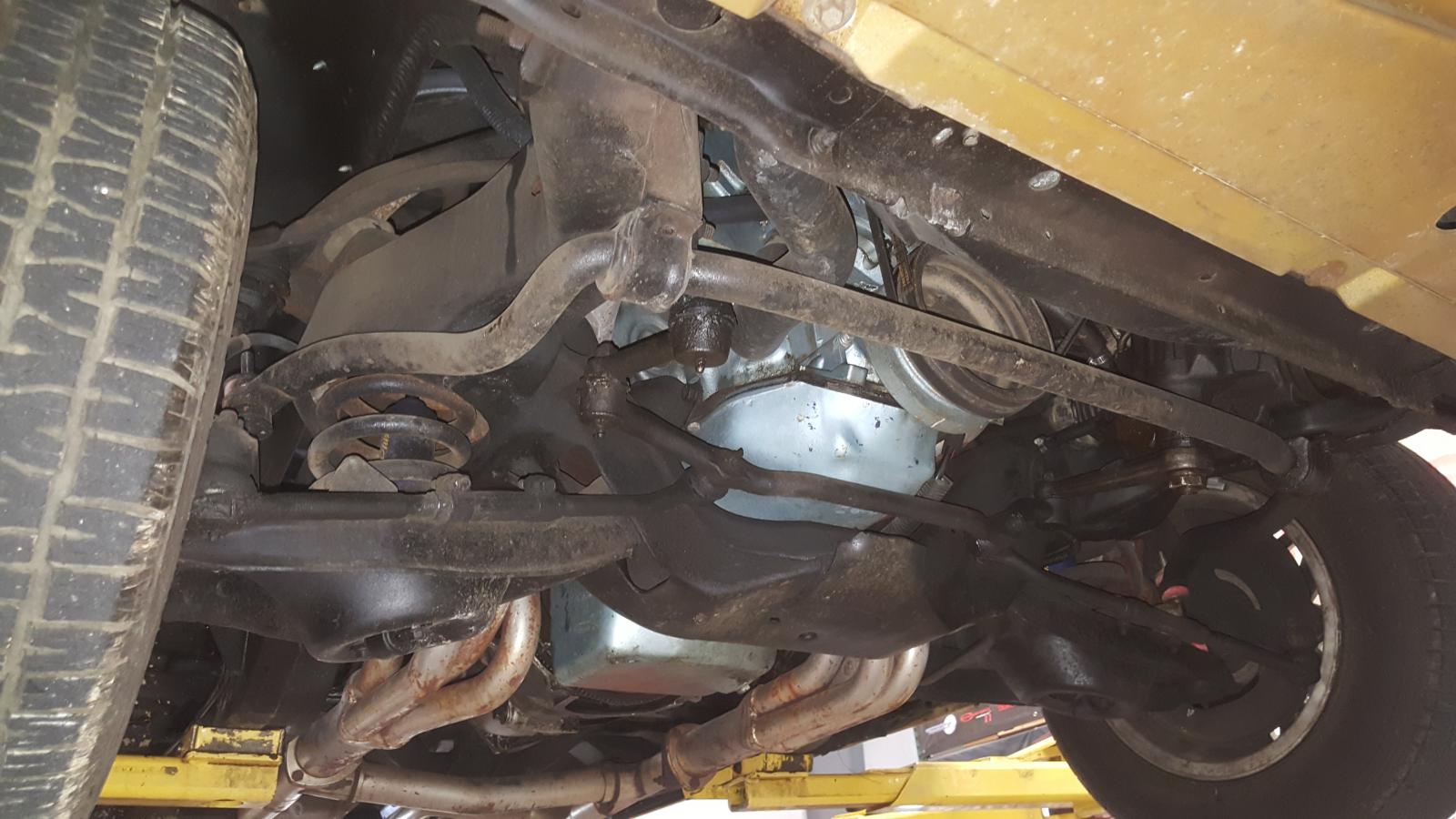

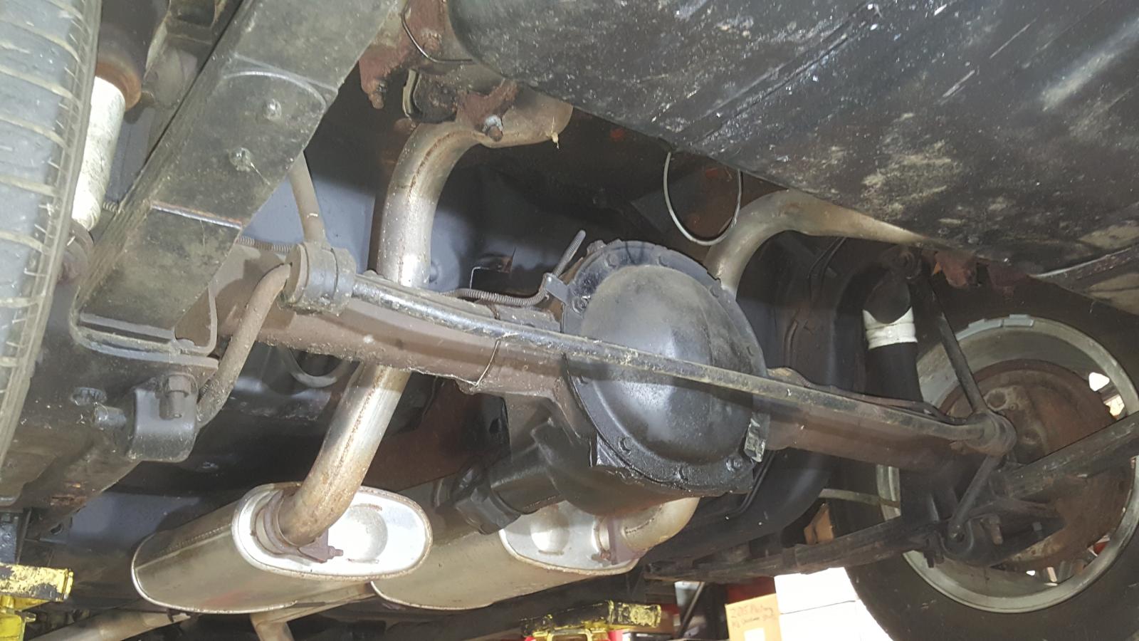

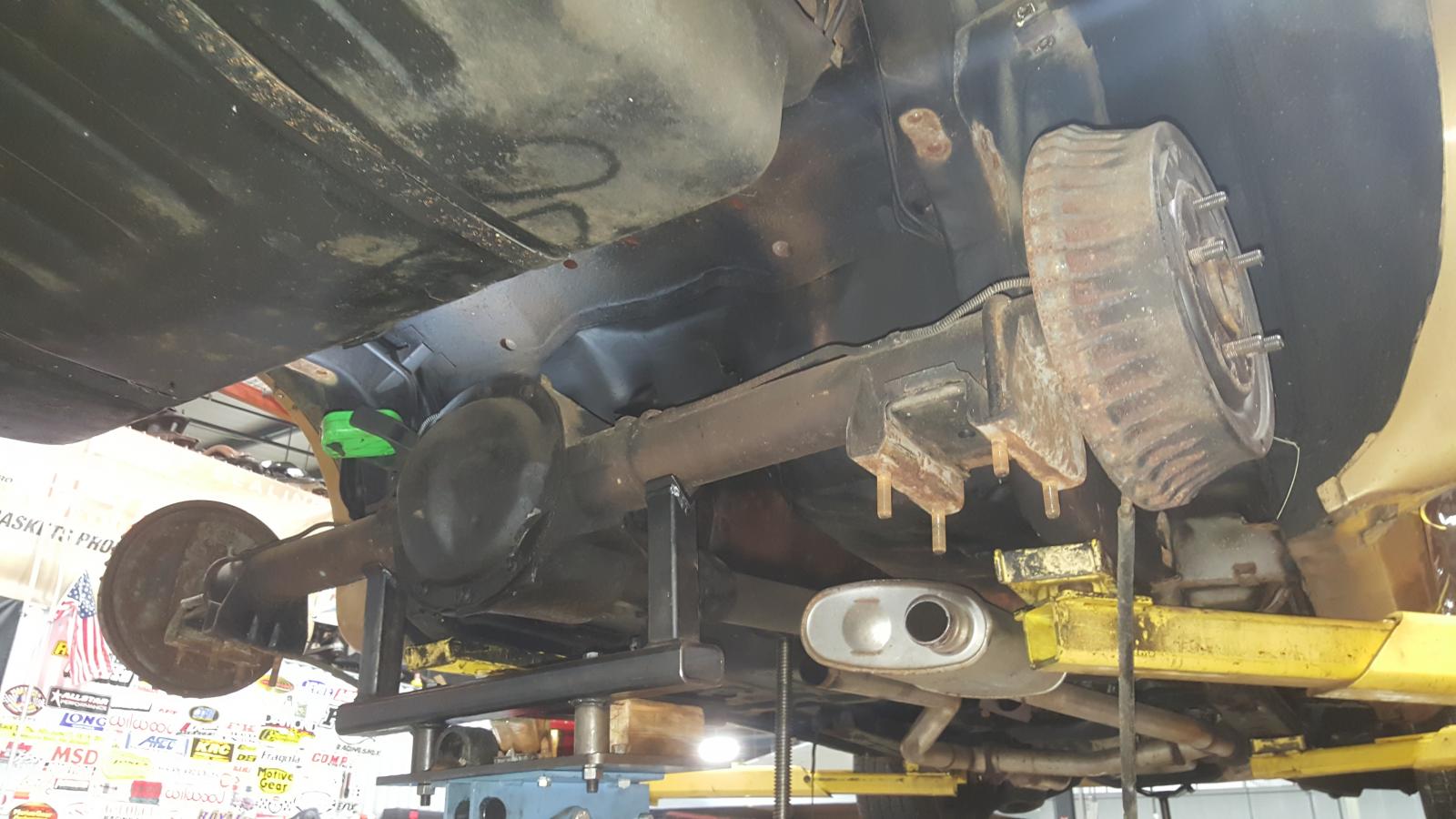

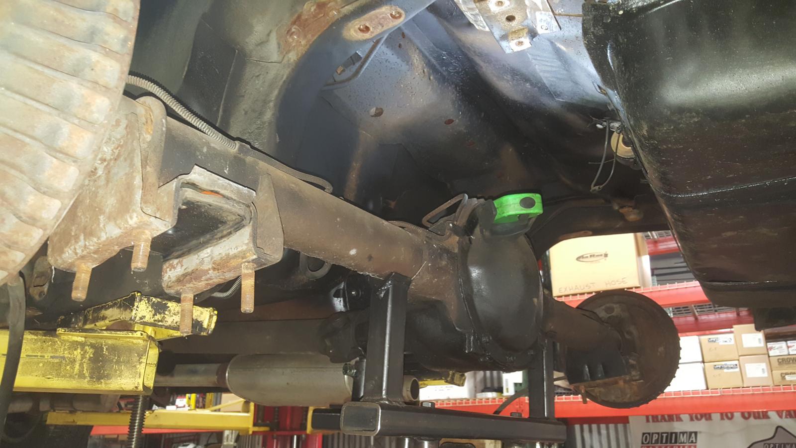

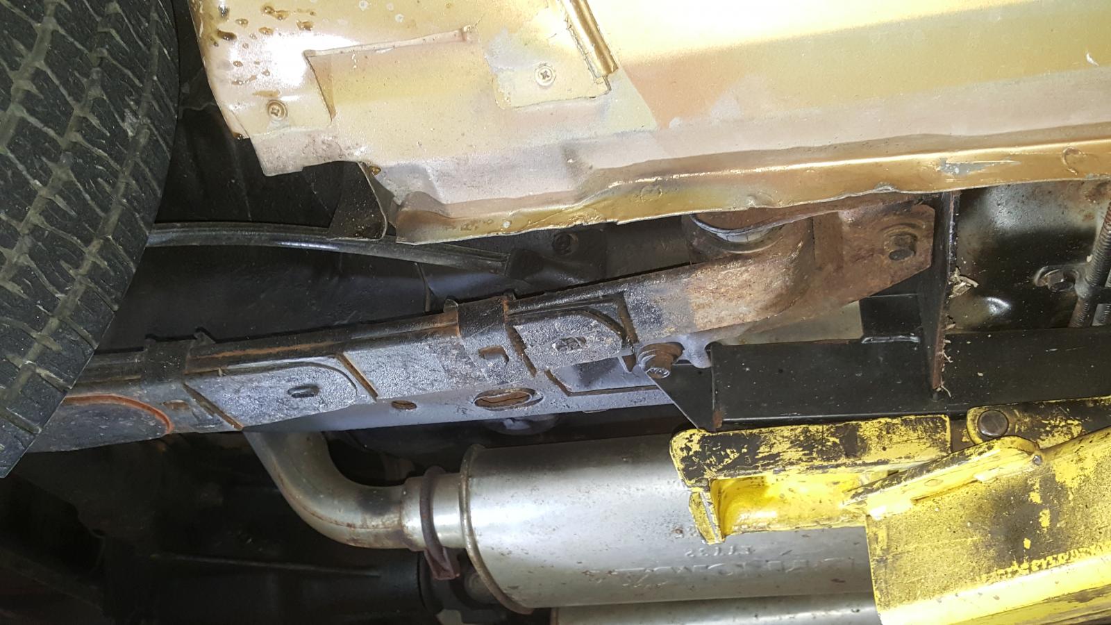

      With the car on the lift and some preliminary measurements taken, we began disassembly of the rear suspension. With the car being pretty solid to begin with, it came apart rather easily.
      The new ridetech 4-Link will re-use the factory differential. We will set it aside for now.

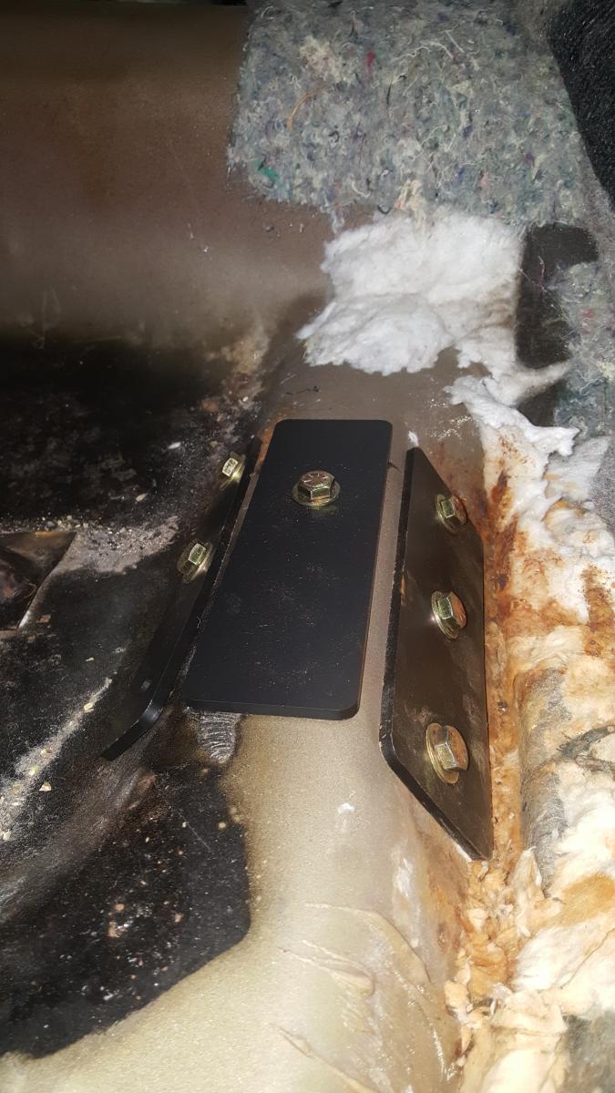

      The front frame rail mounts are secured to the car using Grade 8 hardware with backing plates on the inside of the floor pan. Because of the low profile design and placement of the brackets, these components are unnoticeable once the interior is reinstalled.

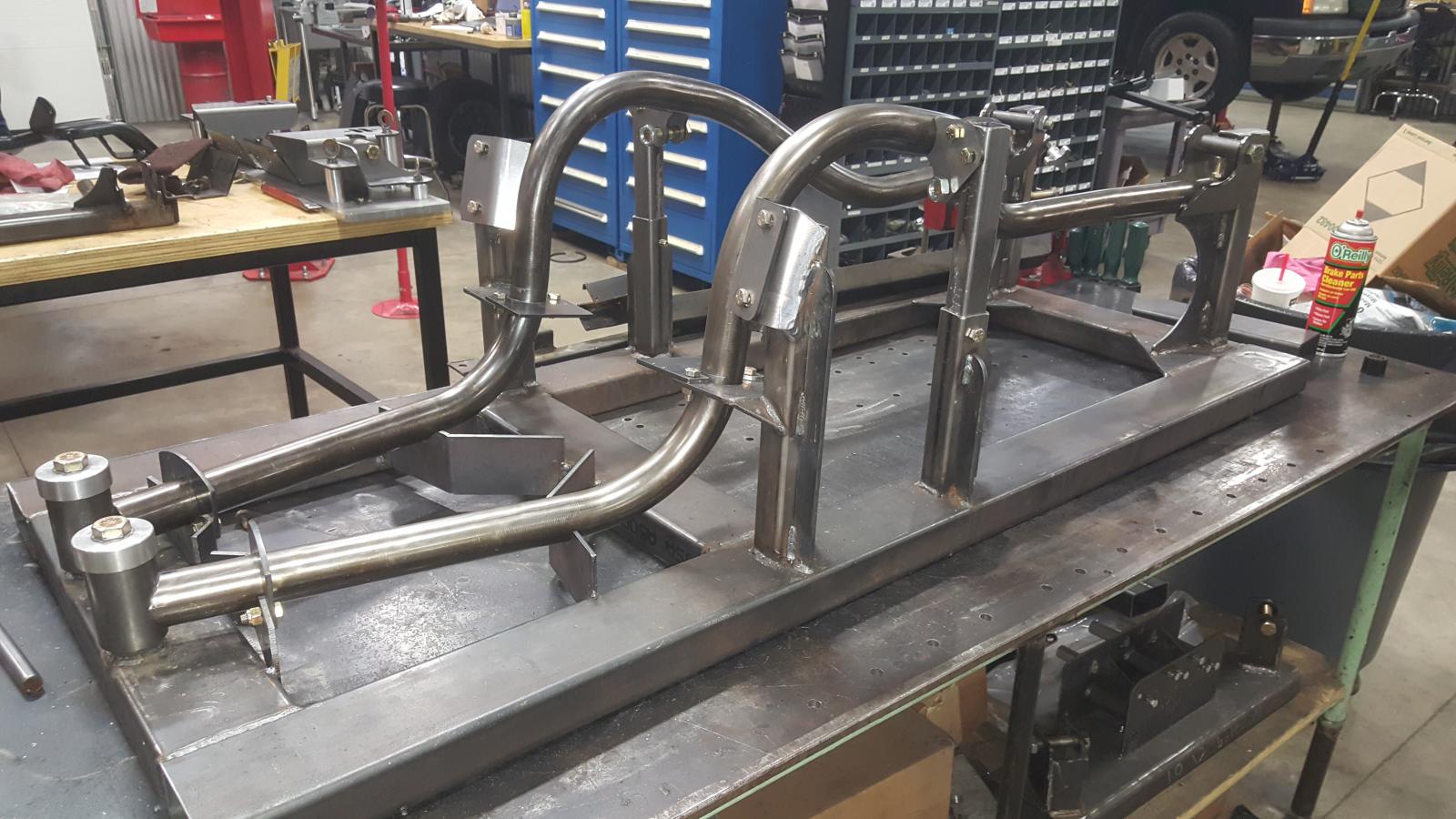

      Before I get into more detail about the installation of the kit, I wanted to share how the product was developed as well as CAD drawings from the R&D process of the 4-Link.

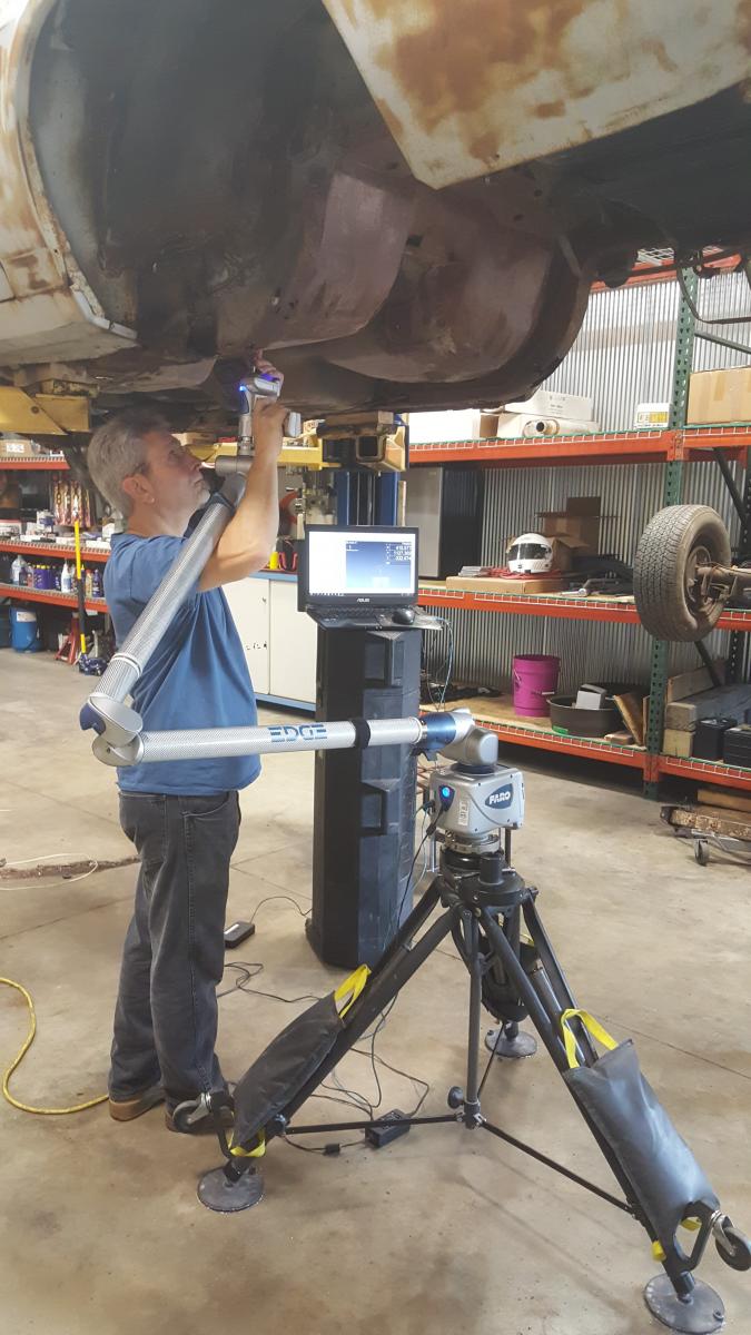

      Knowing that there were a couple of different floor pan variations throughout the years, the engineering department studied multiple 2nd Gens in house to ensure all variations in stamping could be covered with the new kit.
      To ensure that these manufacturing variations were accounted for, we brought in multiple cars with stock floor pans for verification. Below is a picture of a 1971 Camaro pan being mapped using a laser scanning head on a Faro arm. This combination turns the scanned object into a precise digital image that the engineering department can use for future reference.

      Working with the models created by engineering, our fabrication division will then begin the assembly of pre-production components for use on in-house R&D vehicles.
      Name:  2nd Gen Parts Lay Out.jpg

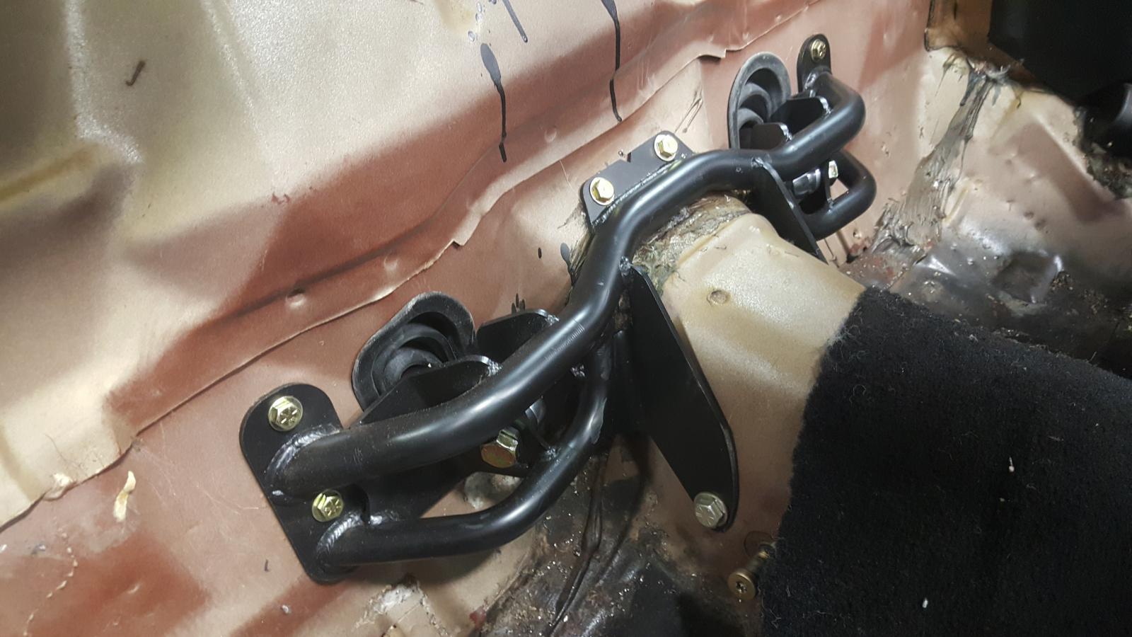

      After getting the lower links installed, it was time to move back to the interior to install the bulkhead and upper 4-link bars.
      The bulkhead installation is pretty straight forward with only slight modifications needing to be made to the floor pan. In addition to being able to adjust the anti-squat % with the lower bars, this setup also allows some adjustment on the front mount of the upper bar. The bulkhead under the rear seat has vertically slotted holes with an excentric plate that will allow for 3 different anti-squat adjustments based on the vehicles intended use.

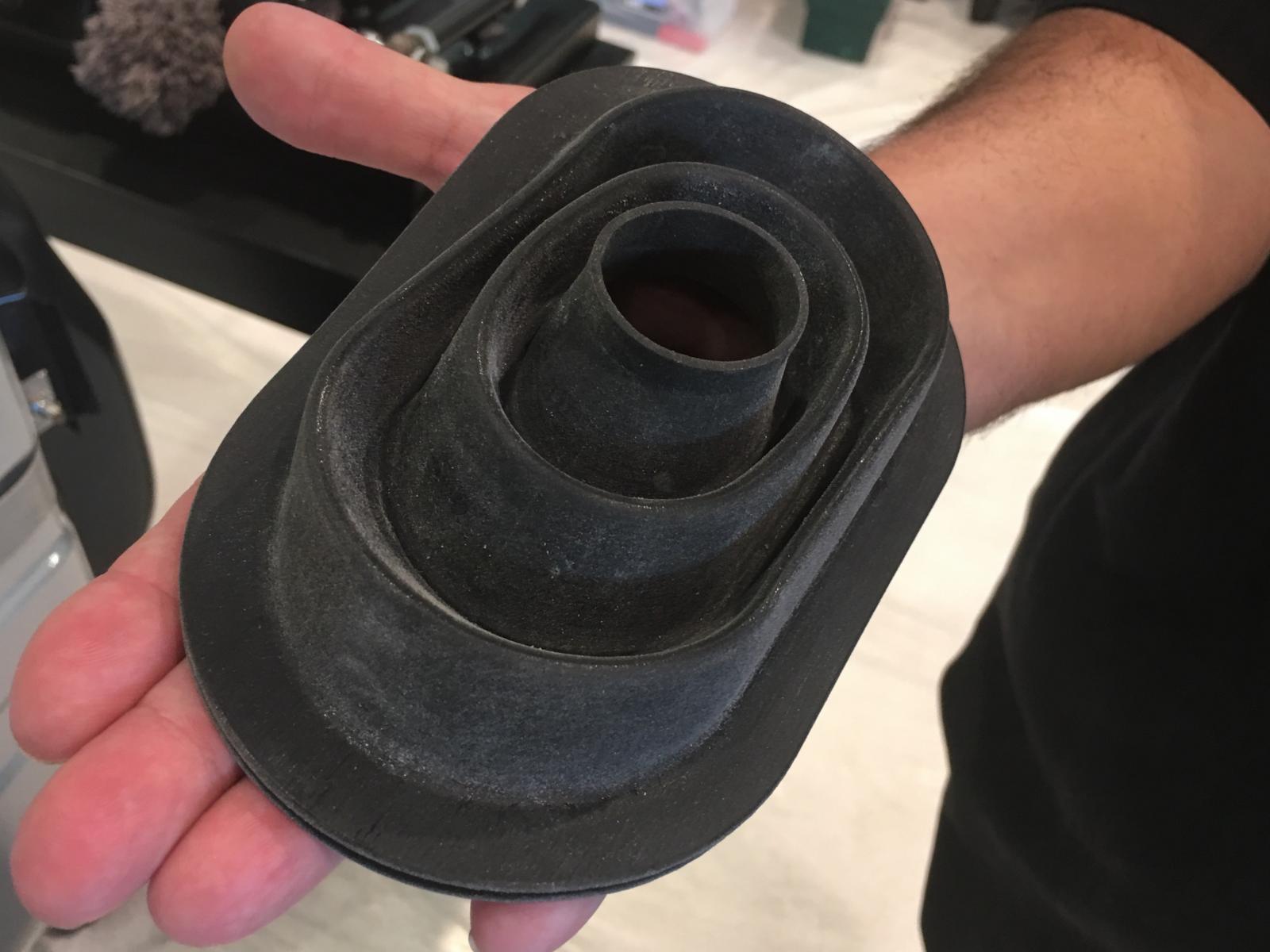

      These trick rubber boots will be included in the kits as well. These help keep debris, exhaust...and tire smoke out of the passenger compartment.

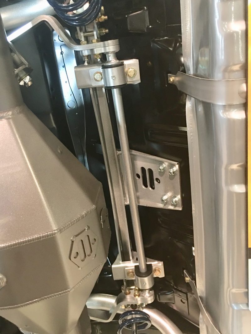

      Before the differential was mocked up for welding, we went ahead and installed the rear sway bar.
      While the rear sway bar is an option and can be added at a later date, installing it while the rear end housing is out is ideal.

      Name:  Rear Sway Bar.jpg
      Name:  Sway Bar Installed.jpg

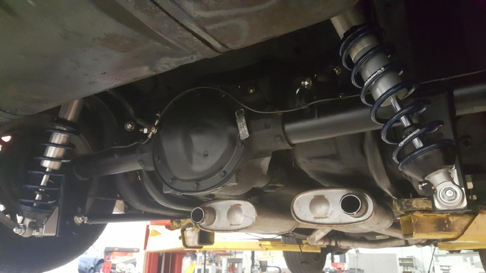

      After welding the 4-link brackets onto the axle tubes, we mocked the rear end up in the car to ensure that everything lines up the way it should. We hit the welds with a little paint to cut back on oxidation. Once fitment on all components are verified, the car will be taken back apart and detailed out to showcase the new suspension.

      With all of the components welded and dressed up with some chassis black paint, we reassembled the components back under the car and set it back on the ground for a few preliminary ride height measurements. Its looking pretty good! Without fine tuning the preload on the shocks, we are seeing about a 2in drop on this particular car. Even with the factory 15in Snowflakes and taller sidewall tires, the fitment in the wheel opening looks pretty good. It should look killer with a nice set of 17 or 18in wheels and some sticky, low profile tires.
      We are planning on routing the exhaust back through the new 4-Link so we can retain the factory style exhaust tips. They seem to be a staple in the aesthetics of these TAs and we want to make sure that's a touch that isn't lost.
      The front suspension is still stock in this photo, I promise we aren't trying to build a gasser.
