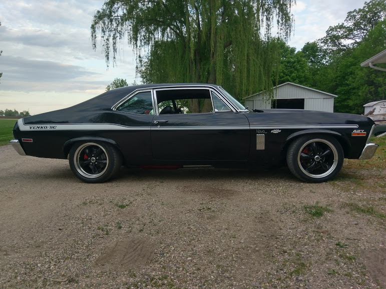

      A little update on my version of a "what if" the SCCA lifted the displaced limits and Yenko threw his hat into the ring.
      Here's a quick buid break down.
      71 Rally Nova
      408 BBC, would eventually like to get a 427
      Aluminum heads, intake
      Mild cam
      Fi Tech throttle body
      Tremec Tko 600
      Dse mini tubs
      17" torq thrusts with 315's out back and 225's up front
      12 bolt rear end with Moser axels, 4.33 for now, switching to 3.73 this winter
      Disc brakes all around, will upgrade to a big brake kit eventually
      It hasn't seen the track yet but will very soon.
