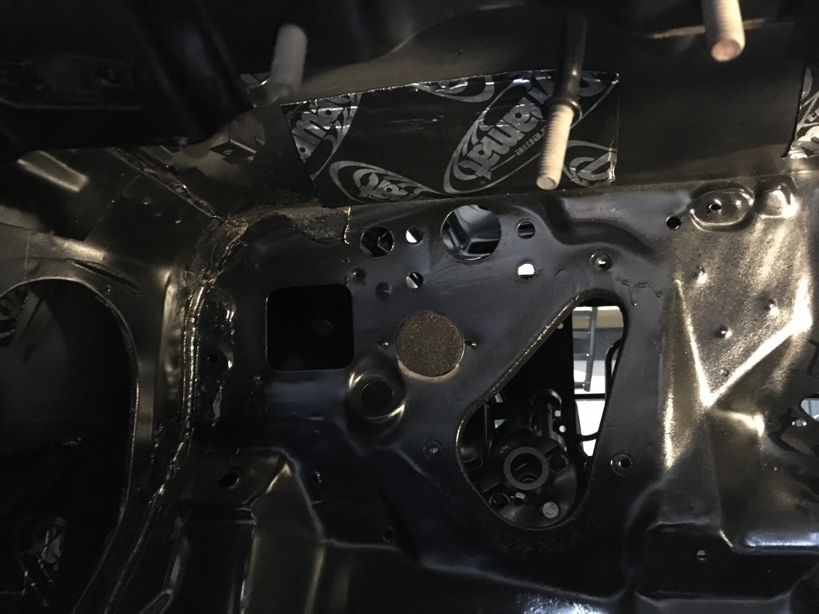

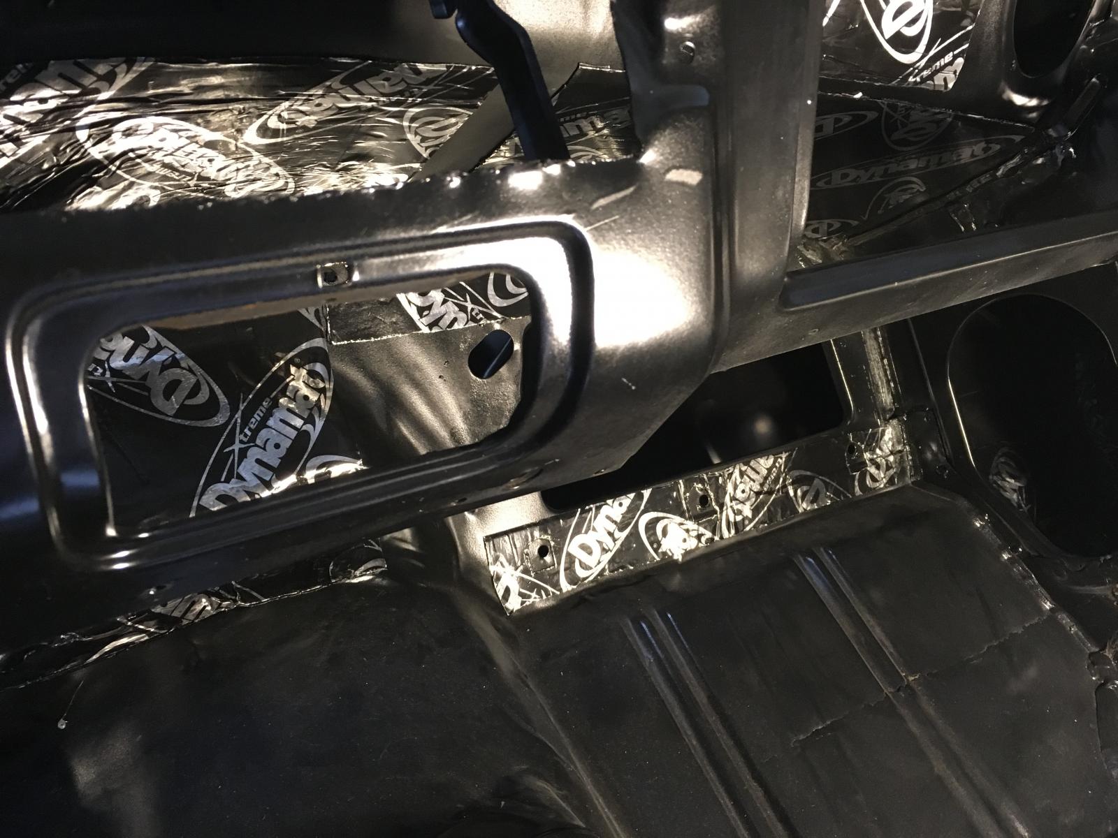

      Got my pad and about to install it and the column. I covered about 60% of the firewall, inside of the upper dash panel, etc with dynamat extreme. I see people with 100% coverage but that seems excessive. Am I mistaken and should cover more of it? I think even dynamat says you really only need 25% or something to stop panel vibration. Thought I’d check in before I go further, last chance type thing. Lol. Will try to post a pic soon.
      Jul 2014
      McKinney, TX
      24
      About 80% coverage on right and middle.

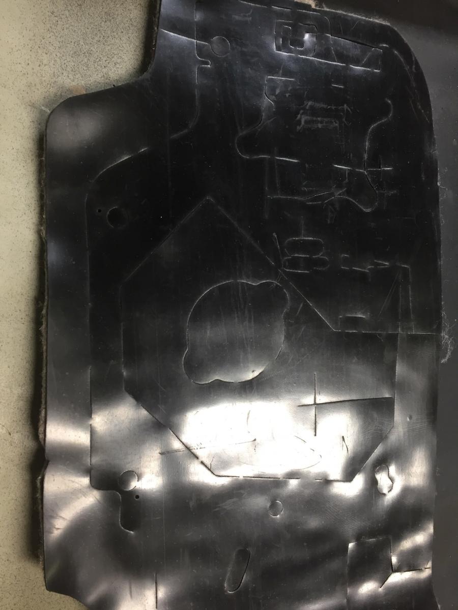

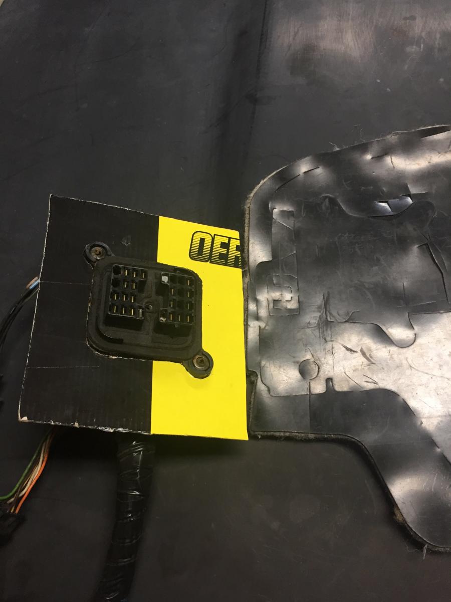

      Got my firewall pad. Needless to say I’m quite disappointed. There isn’t a hole cutout that fits the fusebox (only right side cut). And there’s a million other useless cuts. Seems like it was made to fit several models except mine. Any one know of a good firewall pad for a 68 that has a heater delete?

      Yes part of it is there. There are also cuts for a fusebox that is taller and rectangular. Only the top right is actually cut correctly for mine (square). It’s more like a multi-fit pad. I made a template of what the cutout should look like if it were to fit well around the box with no gaps. Will post a pic in a bit. When I cut it correctly it will be a bit of a mess that needs glued or tapped back together. So I think I will get some Mass loaded vinyl and glue as suggested above to seal all the cuts I won’t be using. Other than needed holes I’d prefer the the rest is a solid with no cuts or gaps. Maybe overboard... not sure.

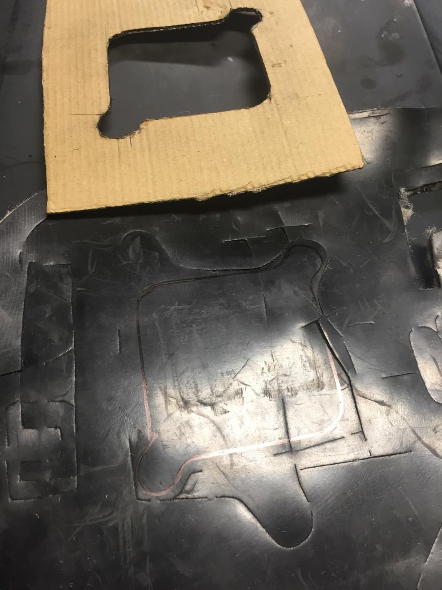

      Here’s my template on the box...
      Here’s my template drawn in black sharpie on the pad. You can see all the cuts that are not used and/or don’t fit. Some are ok. When I cut this hole correctly it will get weak around all those extra cuts. Again maybe overboard... but if I’m going to build the entire car from the ground up just want to do things the best possible way. Labor of love I guess. Lol

      The pictures don’t always seem to be right. This is the one I bought...
      https://www.classicindustries.com/pr...parts/c3a.html
      But take a closer look and notice the fuse box cutout is wrong in the pic. It’s the long tall rectangle cutout. Not to mention what I received was just stamped with no cutouts (actually that’s a positive since if cut it would be wrong). Most pics on Ricks, Classic, etc seem to show the tall rectangle cutout and not the accurate square box. That just confuses me more. It’s a journey. Lol
