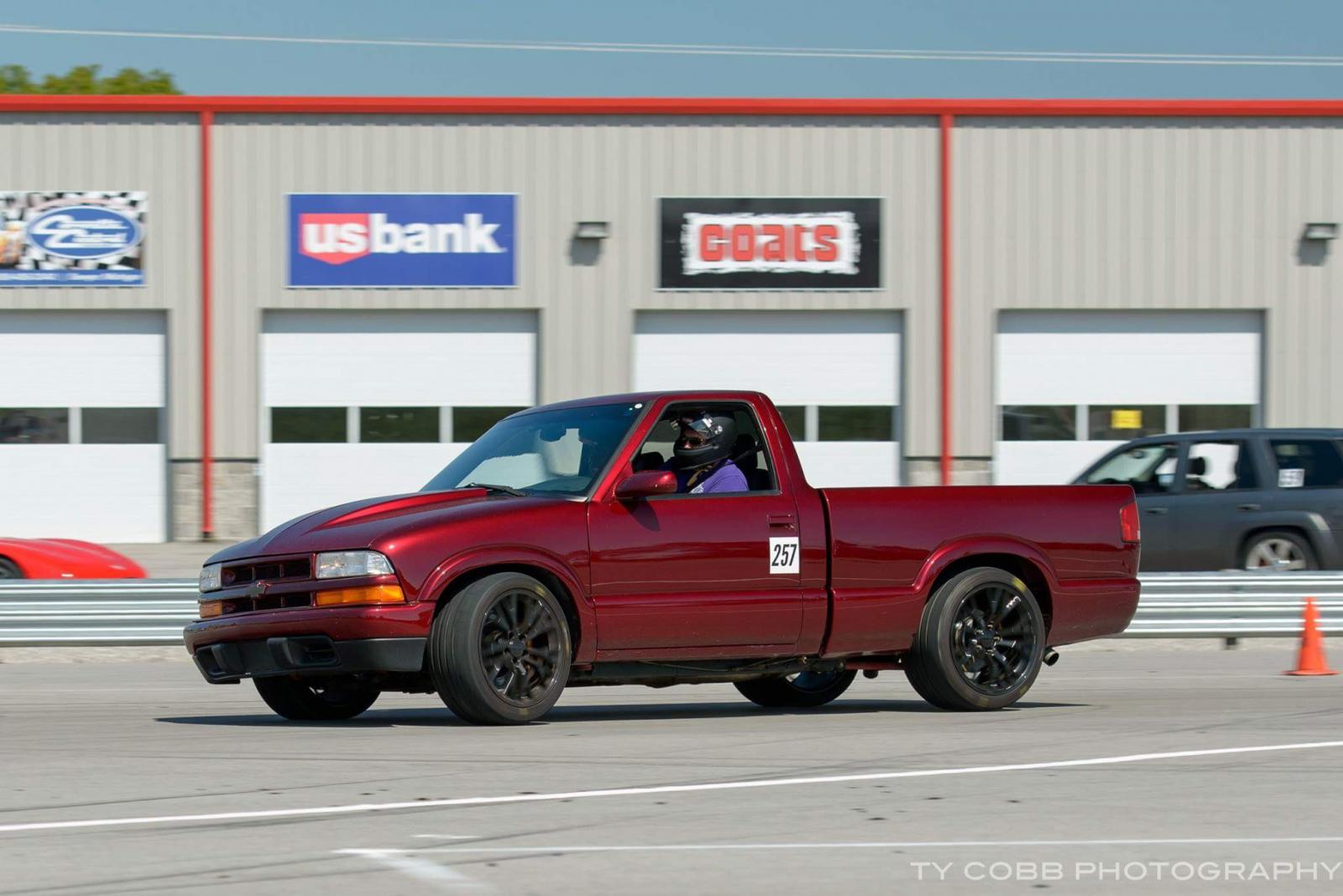

      I made my own cross member. You will have a solid engine combination. I was at ls fest in the brandy wine candy regular cab.Name:  FB_IMG_1506204985360.jpg
