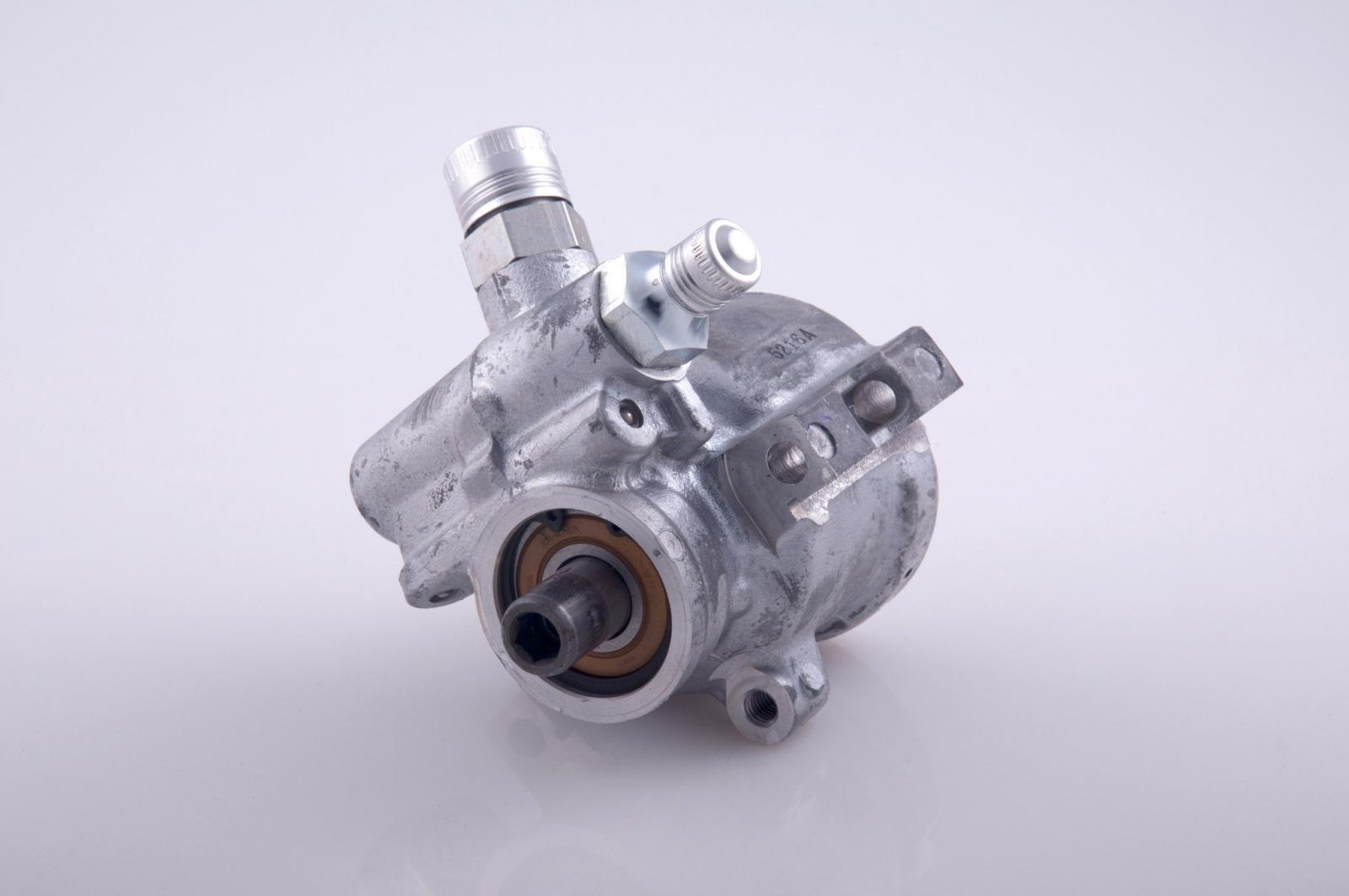

      Does anyone know what P/S pulley installer will work for a GM type II pump? I ordered a used one on E-bay from snap on, but it's the wrong threads. Name:  pump.jpg

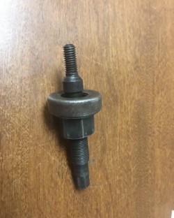

      Just FYI. Threads are 3/8-16 UNC and SnapOn Power Steering Pulley Puller Installer Tool part number CJ113B101 is the correct tool.
