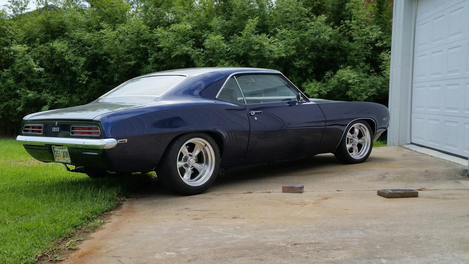

      I would love to see a picture of how the car sits now. Your plan sounds pretty good. I am a LS fan so I agree with the previous comments. What about safety? Roll cage? Fuel cell? Suspension ideas?

      Nov 2016
      Sulphur, La
      613
      let's see if this works...
      Nov 2016
      Sulphur, La
      613
      Car has the typical stuff right now: Bear 13/11" brakes, tubular front suspension, etc. It also has R&P steering which I am not a fan of.
      I do not plan to add any safety items other than 3 point seatbelts.
      Car is mini-tubbed already.
      I would like to do an LS3 but I feel like a new "hot" swap is probably coming so I will hold off. I have all but a front drive to make the SBC a pretty decent setup.
