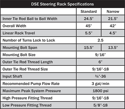

      Found this on DSE website, but with my current Billet Specalities Type II pump, it's 1100 PSI with 2.1 GPM it just doesn't work well. Sluggish brakes and low power steering. I'll try the 1800 with 3 GPM and see if it helps.
