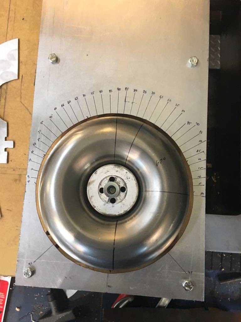

      That is a great idea here is what I use to mark the angles.
