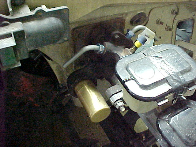

      The little gold cylinder in the middle of the pic is the pressure accumulation can. it will provide enough pressure for two or three stops if the engine or PS Pump dies.
