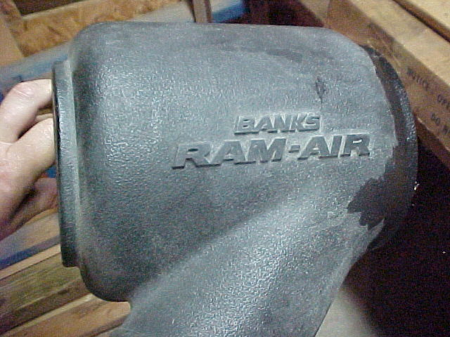

      The air cleaner is a Banks "Ram Air" unit with a large cone filter.
      This is the unit as mounted under the hood.... Not real pretty is it?

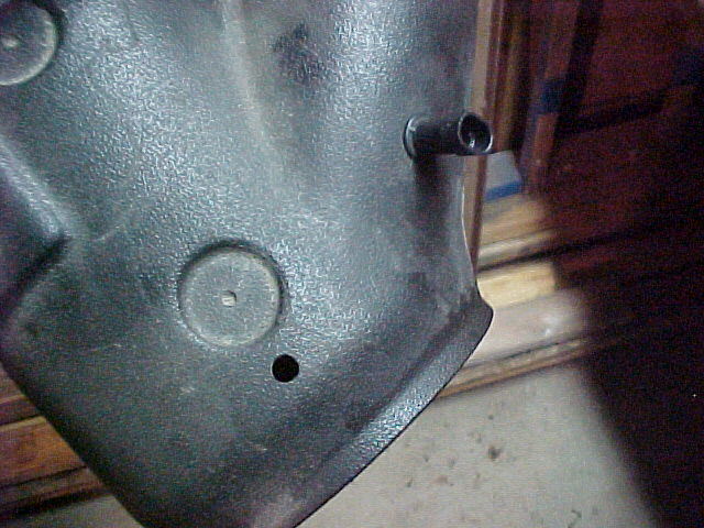

      Here is the IAC mounted in the air cleaner housing. That other hole was there as well

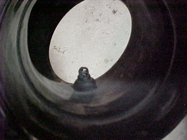

      Looking inside the air cleaner.
      I am thinking this is not the best location for the IAC. Shouldn't it be between the air cleaner and the throttle body? In the full air flow stream going into the throttle body? Right now it is just sitting outside the air cleaner trying to read the air flow from random drafts and minor gusts that "just happen" to blow across it... The blow molded housing seals nicely to the top of the cone filter but the bottom has a decent gap that does NOT seal. That will draw air out of the IAC's vision also... I think this is causing a lot of the idle quality problems and I am going to rectify it... Some how.

      This is the Intake Air Temp sensor. Probably fine right where it is.
