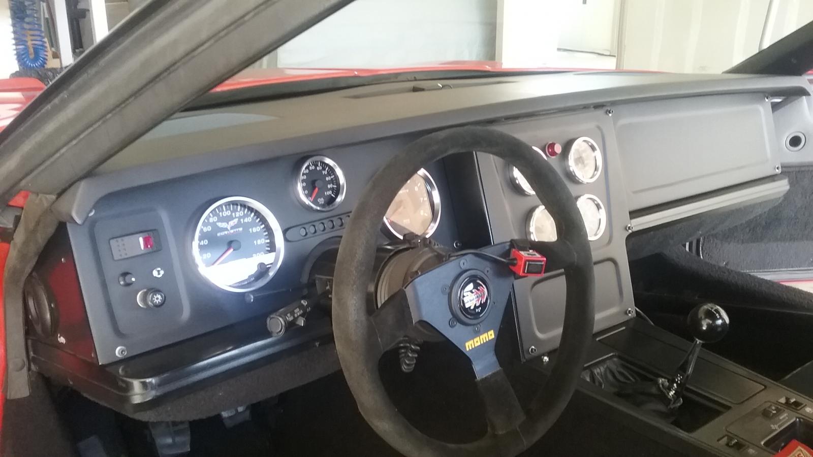

      I love my Speedhut gauges and the GPS Speedo. I'm still trying to get the Fuel Gauge level in sync but, I think the most of my problem may be the sender. I replaced the sender and it read totally different than the last sender. I think it is the lousy cheap Chinese part that is causing all my problems so I was able to find a new GM Fuel level sender. I'll have it in next week.
      Here is a picture of my custom dash that JCG Restorations and Custom did for me.
