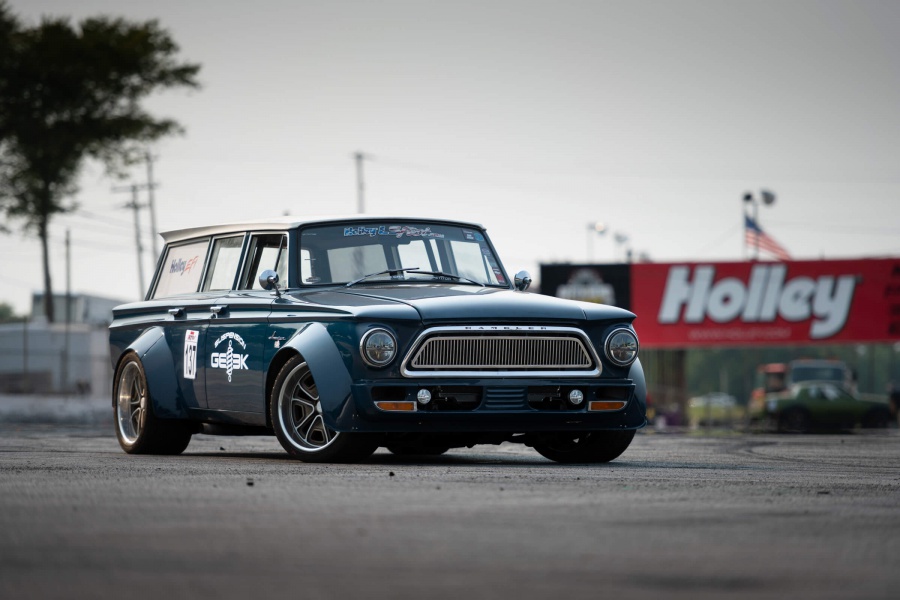

      I have run many of our cars on both carb and EFI ... Suzys Rambler ran a edelbrock intake and Carb, then a holley intake and holley carb and now its terminator X driven... carb is a little more forgiving when you have some not so great components....
      I installed the terminator X stealth system... on her 6.0 engine, and at start up it had a stumble and back fire issue.. this car had been raced for 2 years hard never an issue.. so first I back thru the fuel system... pump pressure, filters, regulator all great, stared checking the ignition system, tested each coil, perfect, replaced the 2 month old MSD plug wires and the stumble was gone, as a carb car it never had a stumble or back fire, as an EFI car it didn't like what was already working ... and we run her car pretty hard
