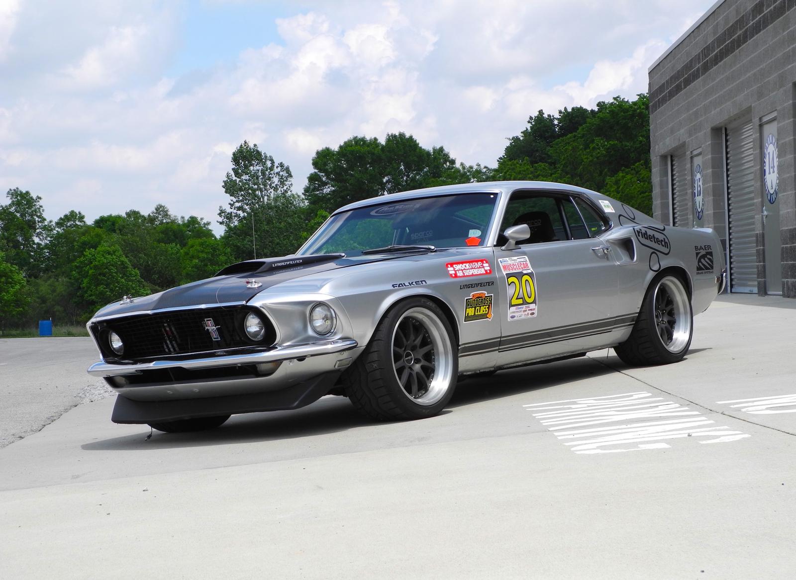

      By eliminating the strut rod and adding the spherical bearing mount, it allows better movement and allows more adjustment. Bret's silver '69 has been a great test car on the street and track over the last several years. He's had our TQ Shockwaves on it since day one but still uses the same control arm as the coilover system. It handles like a slot car but is something you can hop in and drive wherever and not have to go to the chiropractor after .
      Name:  1-RideTech_69_Mustang_0515- - 1.jpg
