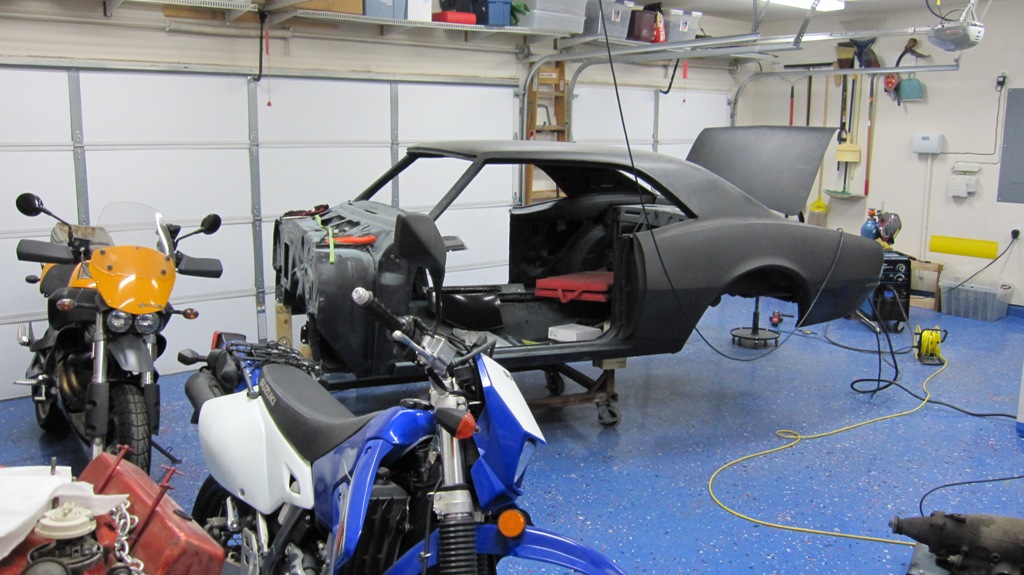

      Nov 2011
      Wylie, Texas
      302
      Nice color choice. I did mine back in 2007 using the U-Coat It system. So far none of the epoxy has lifted but I have scratched the hell out of it and it's not as shiny as it first was. But even those scratches don't go all the way to the cement, and I love how easy it is to clean up spills.

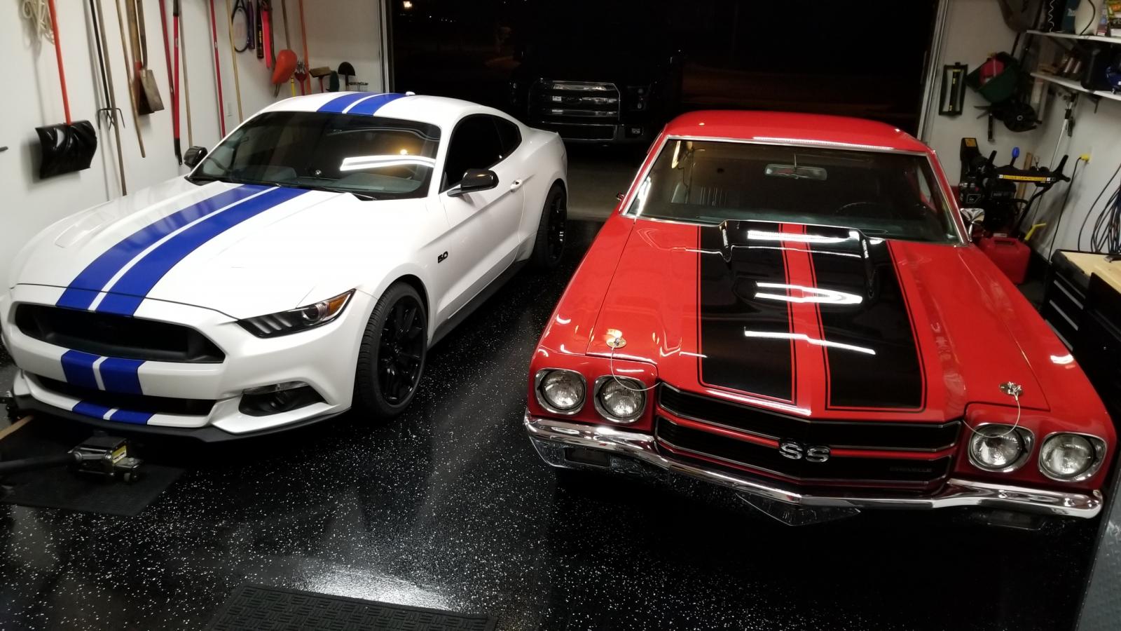

      Mar 2018
      24
      this one was professionally done
      I would add that filling in the expansion joints in the garage makes it look even better and makes clean-up that much easier. I love my color too
