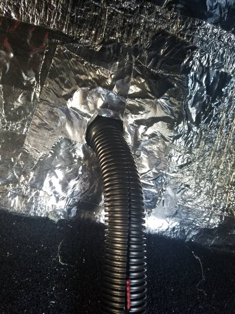

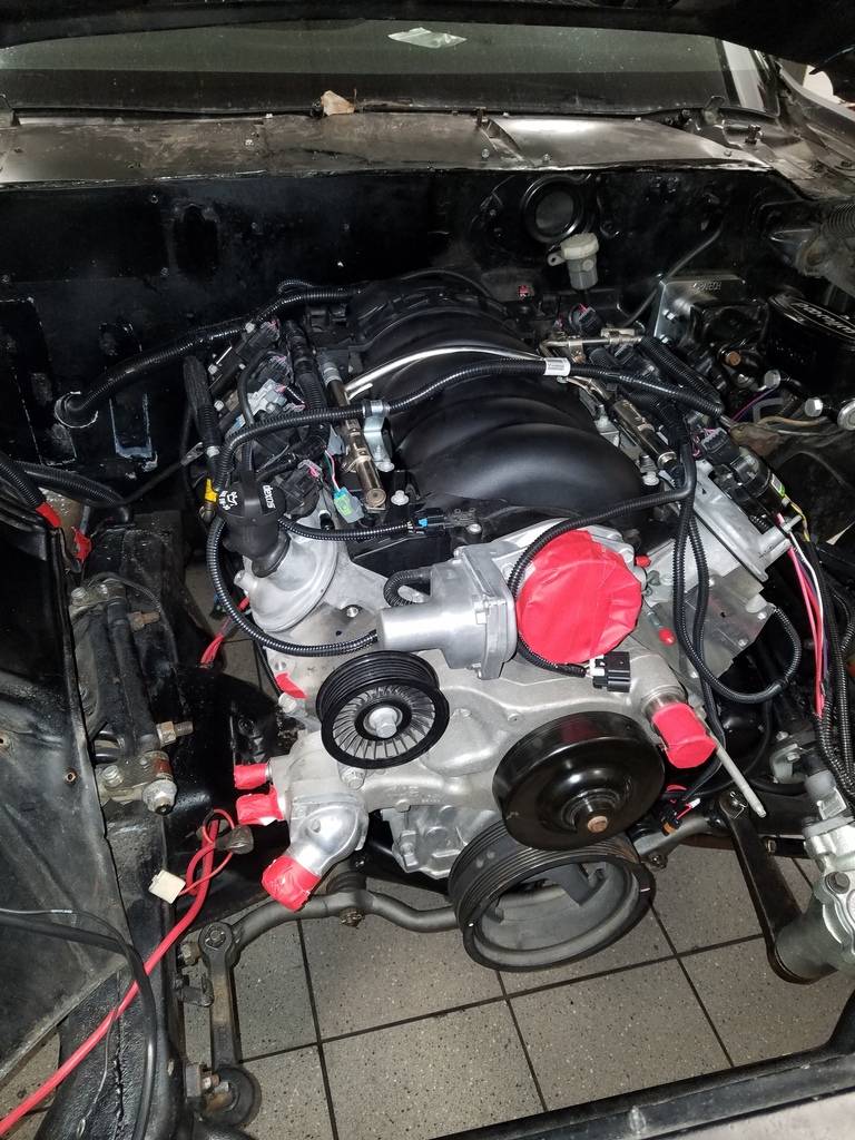

      I have a 1979 trans am getting an ls2. My question is my wire harness was made to run inside the car. It is on the passenger side it says to cut a 2" hole to run the wires. I may be blind but I'm having a hard time locating a good spot to run the harness. Does anyone have any insight ?

      You can hide it by putting the hole in the side of the trans tunnel

      That's a good idea. I wish I would have done that mines not so clean but works...
      I just made a hole on the firewall.

      Good ideas I'm gonna look into the tunnel spot I suppose the ecm can be hidden under the dash als. Any pictures of the tunnel hole?

      Hell of a lot of work and not sure what your budget is but some guys have cut the harness and added a mil spec connector

      I found some mil spec type connectors I'm going to run on my car. Better price and uses a "standard" style crimper. http://paradiseracing.com/?post_type=product&s=Bulkhead

      Yeah just like those ...run one in the tranny tunnel and then whenever you need to do work ...ie detail engine bay, swap motor etc the harness is a easily removed

      It will only damage the ecm if you screw it up. I was using the the Molex XRC 31 pin connectors but have switched over to the Delphi HES 47 pin connectors. Mouser and Waytek have both. I spent a boatload of money on crimpers, though.

      Sorry, I looked through my site and I don't have clear pictures. It was on the left side near the firewall at about the 2:00 position if you think of the tunnel as a clock with 12:00 top dead center.

      The Molex really only come in one size, the Delphi has several options. Also, the 47 pin means getting a LS harness in 2 connectors instead of three. There wasn't a huge difference in money between the two but the Delphi gives us more options. Some sizes can carry 12 ga wire and 40 amps.
      I have the Molex branded crimper and bought a Rennsteig and several die sets to do the Delphi.....all from Waytek. If you are careful they both can be crimped with weather pack style, non ratcheting, one step at a time crimpers. We do enough of these that it wasn't worth the time to not have the right crimpers.
