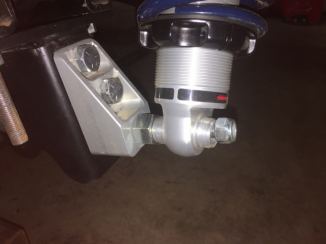

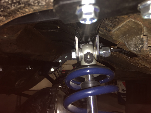

      Looking for a little help with the lower mounting of the coil-over. The top spacers go into the eyelet but for the lowers don't. Either I don't have the correct ones or they mount a different way. Hopefully someone can clear this up for me and show me the correct way before I tighten everything up.

      Pretty sure you are missing some bushings for the lower mount. My car is in the upholstery shop or I would take a look.

      The lower spacers are installed backwards right now, they both need to be flipped. The lower (5/8") spacers just butt up next to the bearing, they don't slide in like the upper ones do.

      Thanks! Wanted to make sure before I tighten everything down.
