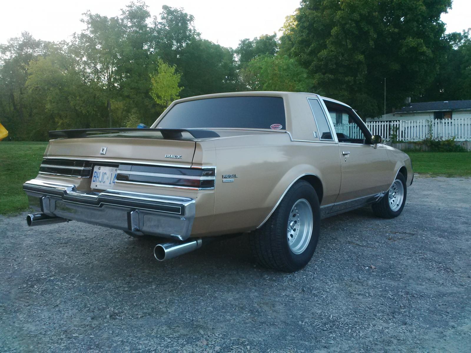

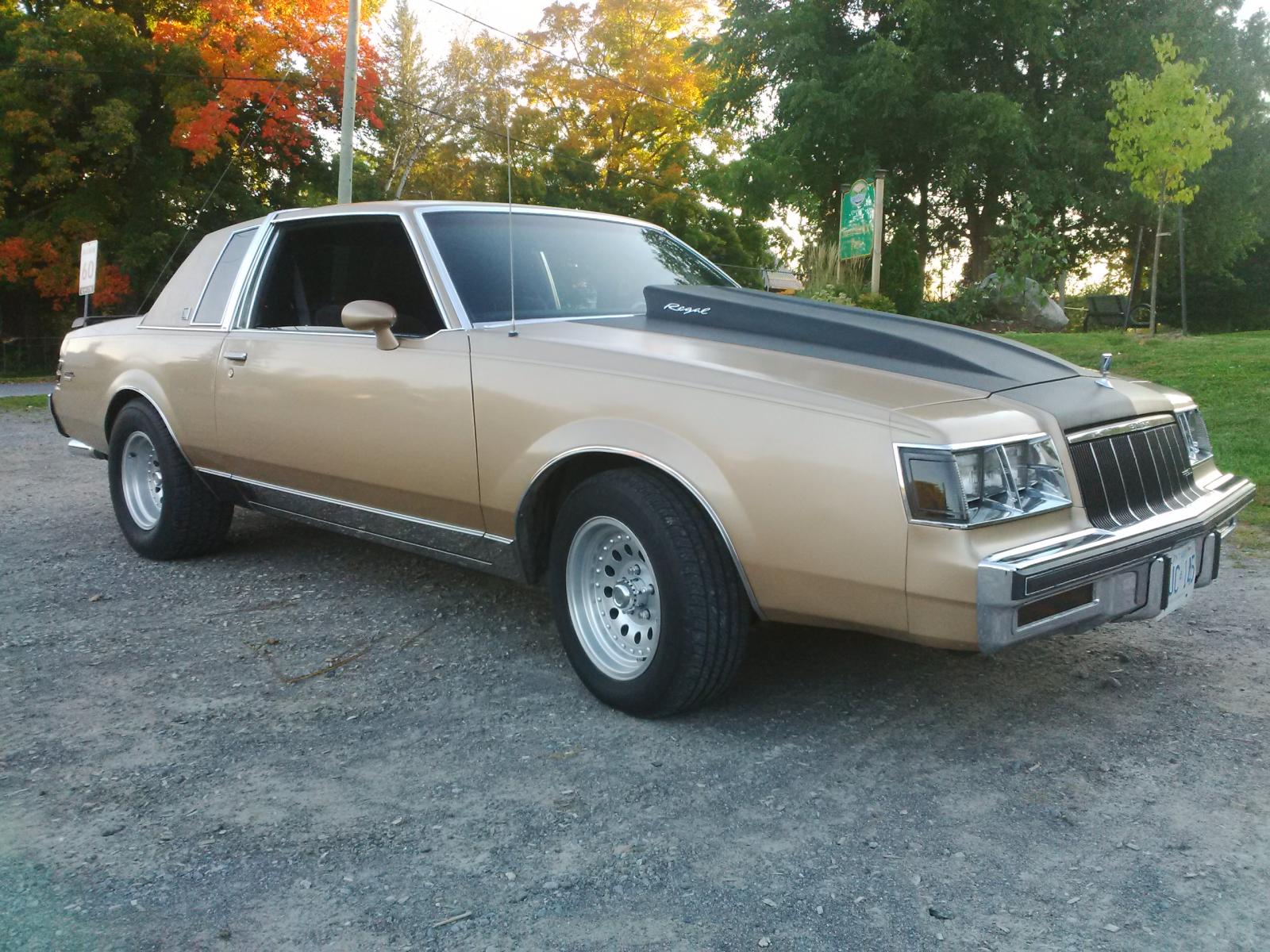

      By chance i am hoping someone on this forum can hook me up! Car is in hiding for the winter but i want to order new rims and tires.
      Its 1985 Buick Regal Limited, stock rearend and no frame notch.
      I am going to order the torq thrust 2 wheels, i was thinking 17" 8 wide fronts with 245 45 17, and 17" 9.5 wide rears with 285 40 17.
      I have read that not all G Bods are the same, so some one with similar year and make maybe has the numbers i need for back space.
      It currently has 275 60 15 rears and i think 215 65 15 fronts....
