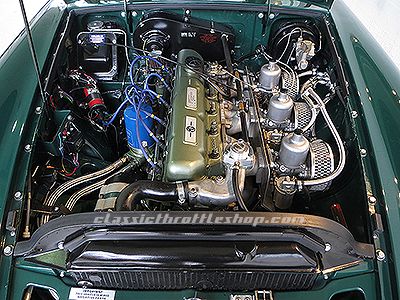

      Engine is a 2.9l seven main bearing 'C' series engine, derived from the 4 main 'C' series used in the Austin Healey 100-6 and 3000.
      Bore: 3.28
      Stroke: 3.5
      The engine was only used on MGC's (8998 produced) and Austin 3 liter sedans (about another 10,000 produced), so the engine is uncommon, but not particularly rare. I've picked up a couple spares watching ebay over the last couple years
      Nothin', and I mean NUTHIN' on this engine is cheap. Developing it even for vintage racing is causing significant internal redesign. with a deck height of 10.25", 3.5" stroke, and 6.6" rods. Piston compression height is about 1.9"; rods weigh 1100 grams each; flywheel was built for a cement truck. Going to a 7.2" rods to get compression height and piston weight down, thinking we can get close to 8 lbs out of the reciprocating assembly. Another 20 from the flywheel, even with the stock diameter single pate clutch. Engine weighs like 650 lbs.
      Don't want to spin more than 7000 with the stroke length being what it is. The target is to come close to the 275-290 hp the fast guys n the UK are getting. You'd think that w/ 7 mains, it would be OK, but there are only aluminum backed bearings available. Hot oil pressure is 55-60psi at rpm- there are high pressure relief valves (Oil pressure relief valve is mounted in the block) for 75 psi- I'm considering running an external wet sump pump like a Peterson to keep the distributor/oil pump drive gear from shredding- I am required to run a distributor based ignition.
      Most guys are running three 40 or 45 DCOE's, I will be running 3 HS6 SU carbs.
