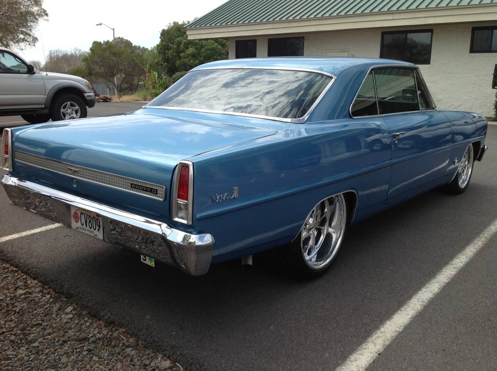

      I had a 19x10 with a 275 tire on the back of my old 67 Nova. It was converted to a 4 link and mini tubbed to the rails. I could have gotten a 295 tire on there as there was room to spare.
