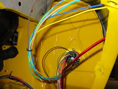

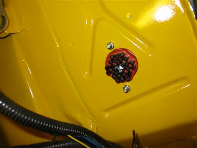

      I used the American Autowire 22 port bulkhead with the Highway 22 harness. I ran the wires through the kick panel and the bulkhead through the cowl behind the fender.
