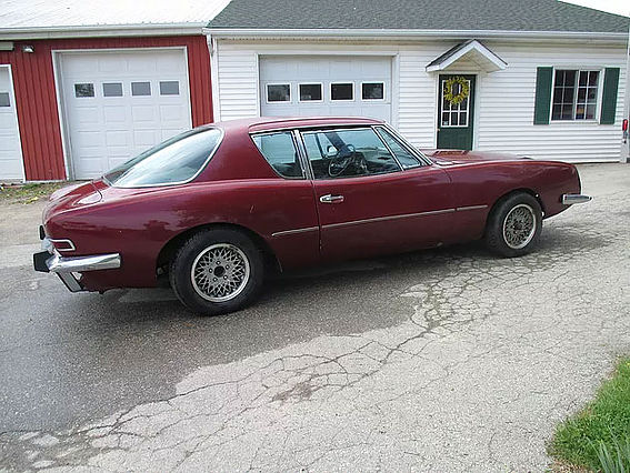

      With the car now receiving some attention in the body shop, we finally have some time to get everyone caught up on our next Studebaker build. As with our last project (https://www.pro-touring.com/threads/...r-to-track-car), my father is entirely responsible for the build. My role is limited to helping to share his progress with everyone here. But before getting directly into the build, a bit of background to set the proper context for this project.

      The body was lowered onto a dolly and moved to the other side of the garage for removal the entire interior and doors. Knowing major surgery was about to begin, a grid of internal structural 1" square tubing was built to maintain door opening dimensions, and alignment of front and rear sections of the body in both a vertical and horizontal plane. By incorporating 1.25” square tubing over the 1”square tubing, dimensions could be maintained while having the ability to move (telescope) the rear section of the body forward once a section was removed.
      With the internal structure complete, cut lines were marked on the body, 8" out of the roof and middle of the fender above the wheel opening, and 4" out of rear quarter window, as well as 4" behind the rear quarter window. Up front, the front wheel was moved forward 3" to cut down on the front overhang to promote a 50-50 weight distribution and to provide space for the steering rack in front of the engine.
