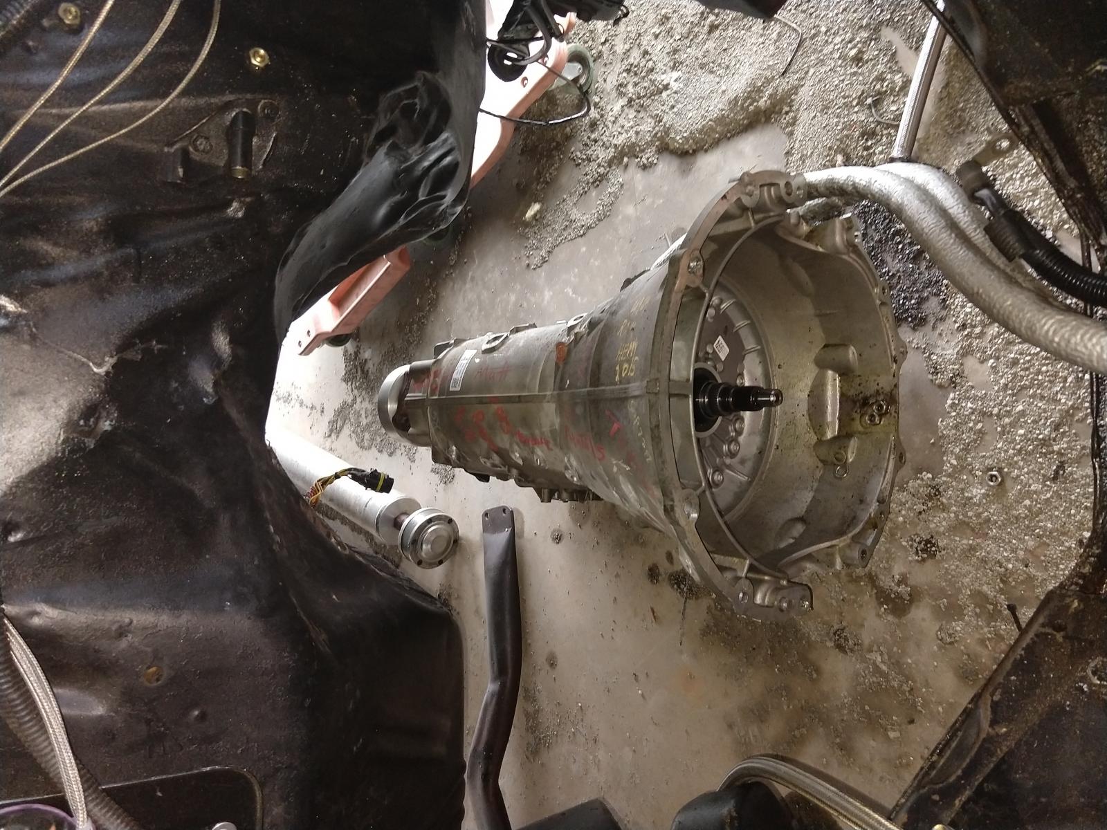

      pics
      this shows how a ls wheel is too big to fit inside of the bellhousing.
      I've been running a 153 tooth plate however i had to modify the starter for it to work.
      I'll be using a 1" spacer / adapter next time so the flexplate doesn't have to reach into trans

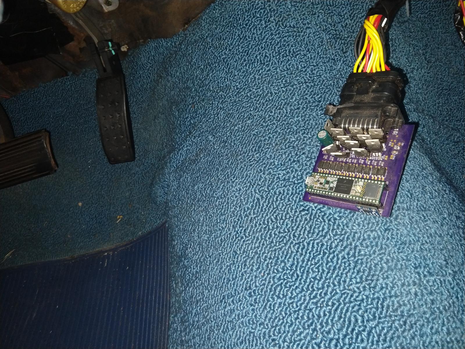

      the computer i'm using. if i had to do it again i'd just buy the pcs controller or similar

      this kinda shows it's size, i did have to open up the tunnel a little and will open it up more for the driveshaft going forward
