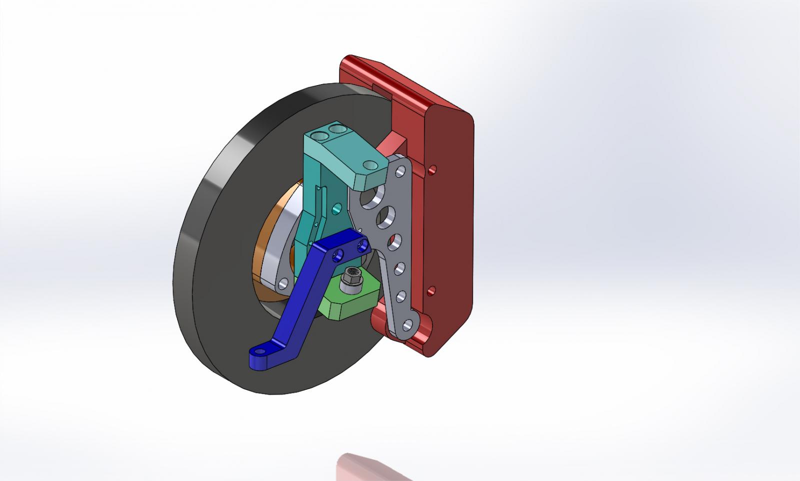

      Something like this. It is possible to do it, but it does take time. I probibly have close to 30hrs design time, another $3-400 in material ( all 4140 ) and luckily I have a friend with a CNC, otherwise it would have been a ton to machine. All said and done, I'll bet your looking at $3000 to make a set. I made mine so I could run Dodge Ram SRT10 hubs and brakes on the front (15" rotors).
      Yes, that's the ticket there tin-man. A bolt-together spindle.
      The 30 hours of design time should not be an issue for the average enthusiast. This is a hobby after all. Designing parts is supposed to be fun!
      The cost, I'm not sure. You went with 4140, a great choice and a strong material, but expensive to machine. 15 years ago I owned a small company making brake parts for BMW M3's. I had a kit that adapted Porsche 996 monoblock calipers to M3 front ends and the adapter bracket was made from 4140. Heat treated after machining. Yet there were other companies selling similar brake kits where the adapter bracket was just made from CNC'd 6061-T6, and they suffered no ill effects that I ever heard of. So was I just being too cautious? Who knows. Neither I nor any of those any other companies did an FEA check (finite element analysis).
      To wit, there are some very professional spindle kits on the market now in the Pro Touring arena where the steering arm is CNC aluminum. And even some where the whole spindle is aluminum. That would be a lot cheaper to machine. It would be more bulky though.
      Not pooh-poohing your design at all, it looks great. Just trying to point out that there are times where steel is absolutely required for a part. Either because of absolute strength requirements. Or because there is not enough room for the extra space that an aluminum part would require. But I'm not sure a spindle is such a part. I think aluminum is a viable material for a spindle, and it would bring down machining costs quite a bit.

      You are correct Dr. G, but my decision to go with steel vs aluminum was based on a number of factors. First I did run a simplified analysis program that is built into Solidworks called Cosmos which told me the 6061 Aluminum could not handle the forces that I used. Now granted the forces I used were based on a lot of assumptions that I and my colleagues came up with, mostly because we have no way to actually measure these forces. Second, the difference in cost of materials was negligible, as well as the cost of machining ( I worked a deal with a friend of mine ).
      Now, you could simply assume that if aluminum was good enough for Dodge to use on their spindles,( which I'm sure they ran FEA on ) on a truck that weighs in at close to 2000lbs more than my truck, it would be safe. But given the fact that my truck will primarily see street use in New England where the potholes have been known to swallow up small cars, I decided to go with the steel.
