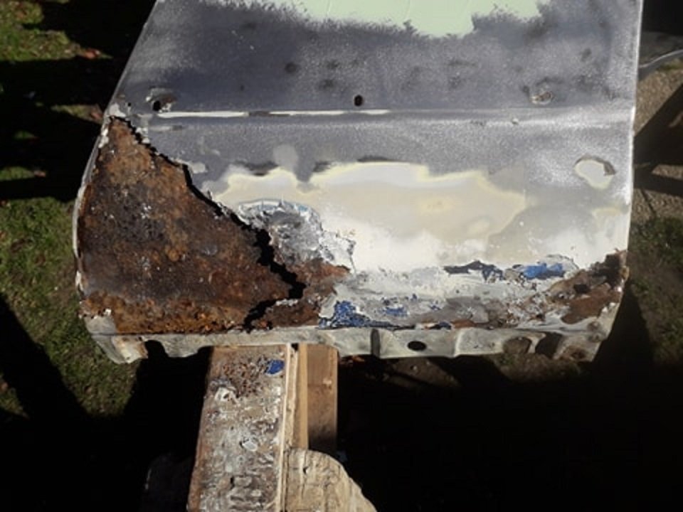

      I've a small issue with my passenger side front fender....lol and because I live in France I don't have a lot of choice, or I can repair it or I order a new one but shipping costs is about $600 so I will repair it
      The hole was filled with concrete....lol

      Concrete is the new bondo lol
      Oct 2016
      586
      Yes a friend told me that in 80s some guys filled the entire Renault r12/r13/r14 floor with concrete instead of replacing it....this is scary lol
      If you have french cars in USA, take a look at all rust points, it could be fun to see if there is something other than steel.

      Nice job on the fender,it came out nice.

      This is what I m using, professional product in France, but I ve not finished to work on that fender, the goal is to put as less bondo as possible to get a flat surface so I will play with the hammer now.

      It’s awesome to see all the work your doing on this car. I love the color change and I hope you saved some of that concrete so you can show people how not to fix a car.

      today I've just allmost finished the fender and put a light coat of black paint before sanding with 600 sandpaper

      Great work! That fender looks good as new.
