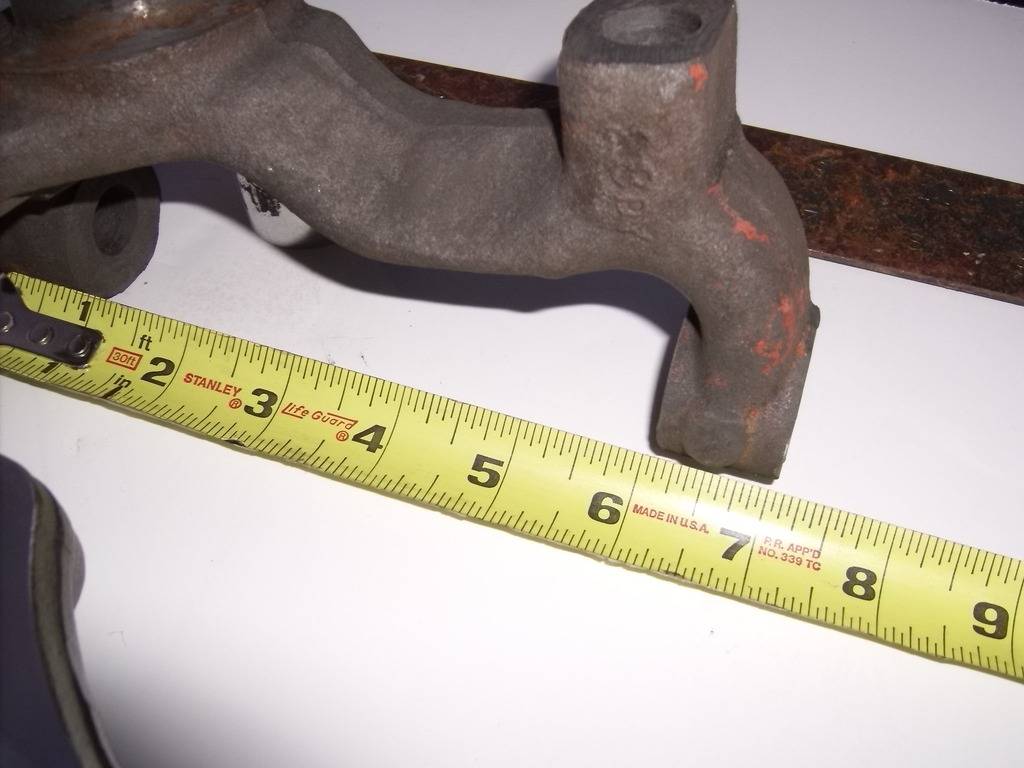

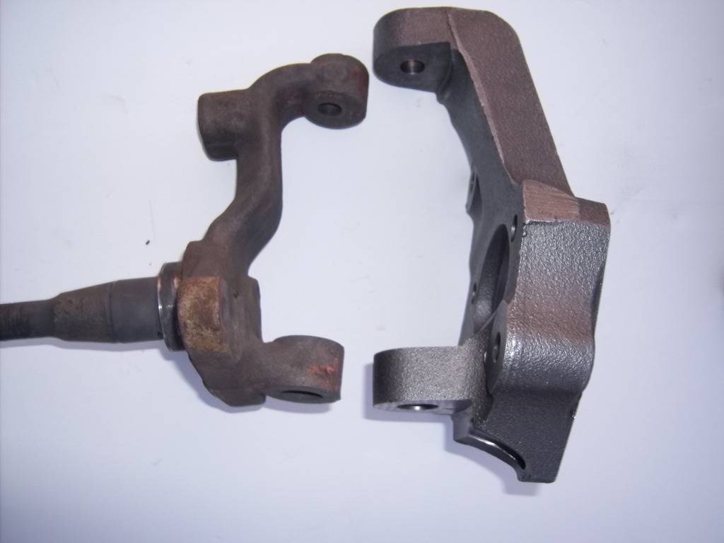

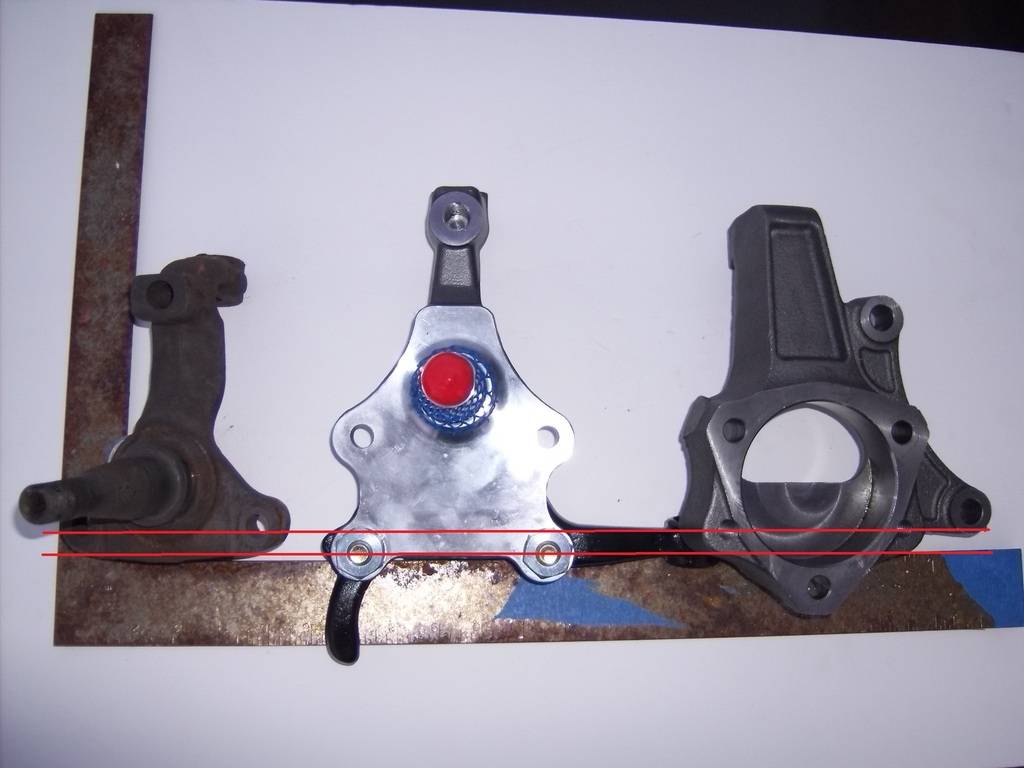

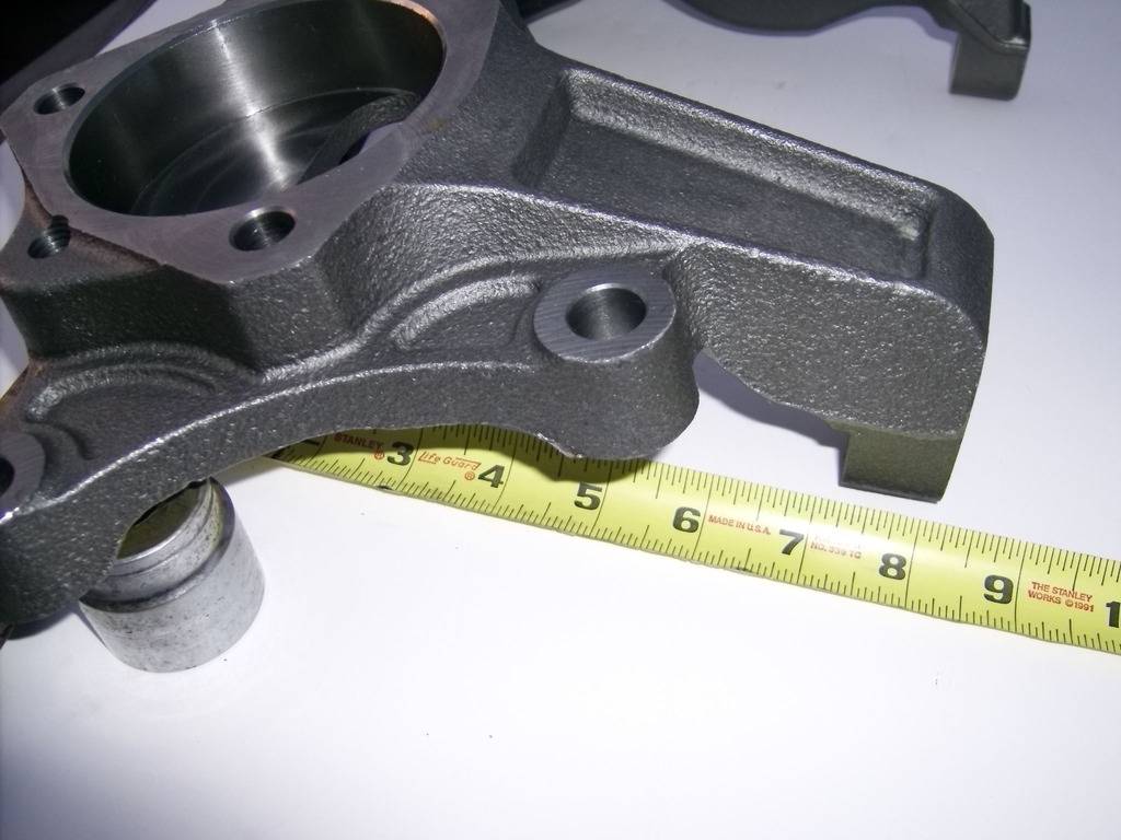

      here you can see the steering arm hole on the stock and the CPP are in the same location the Fatman/ridetech spindle the steering arm is dropped some to reduce bump steer, all three at sitting inline on the lower ball joint surface
      CPP vs Stock
      stock spindle height
      CPP height
      the CPP is a nice peice its a little heavy but preformed well and I do like using a bearing pack, its a cast part and surface rust easly even after it was painted a cast grey
