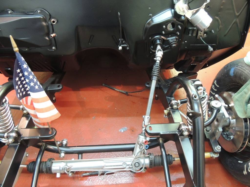

      64 Chevelle Build - Semi Schwartz Chassis
      After struggling with a very bad Sch****z chassis where nothing fit, I finally have it permanently mounted in my car. For something that was supposed to be plug and play, not one thing was correct on the chassis. From the steering, control arms, shock mounts to motor mounts and the chassis even hit the body. This took me an extra year+ to get to this point. This was AFTER the car was painted.....I had posted something last year and Mr Sch****z asked me to take it down and they would help me. The instant I took it down, is the instant they stopped talking......But, it is over and done with.........

      In this picture, the mounting screw for the clevis interferes with the steering/lower ball joint mounting arm when the suspension is in droop. That is extra nice as you are trying to turn into a corner and the steering gets hung up on a suspension bolt. I even used a button head scrw to help the problem.

      If you put the shock in does the suspension droop that far?

      That is at a little less than 2" of droop and there is about 2-1/4" to go. While it may never get that far down, it is the point that it can interfere and everyone knows if something can go wrong, it will.....

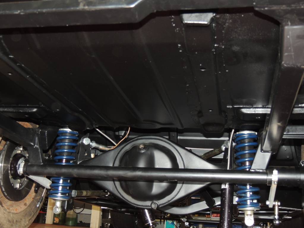

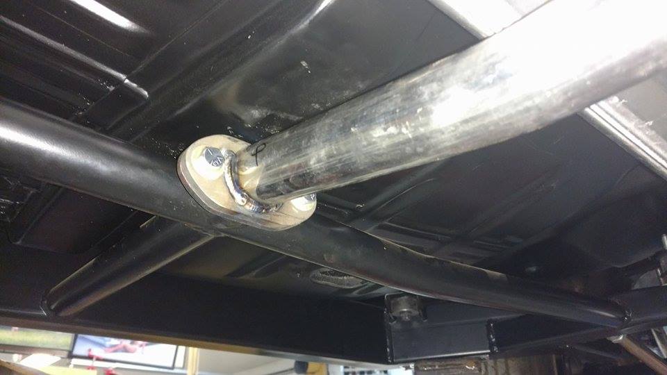

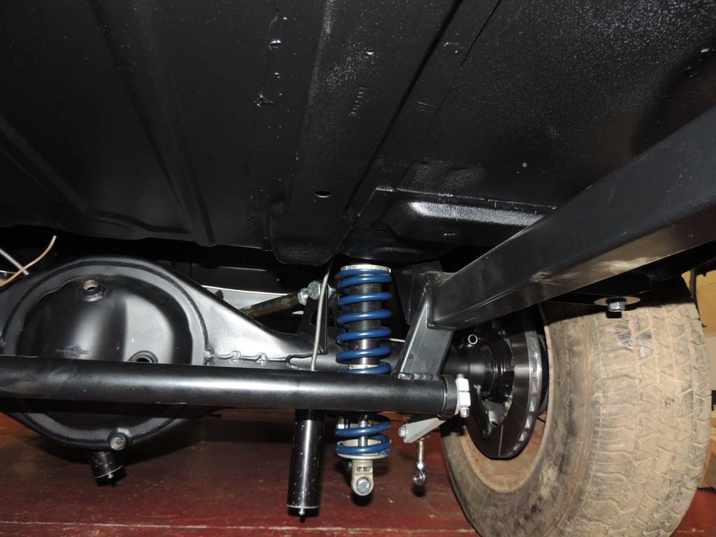

      More Schxxxtz fun - Frame didn't fit under the car, so I had to cut the back half off and repair the kick-ups so they would clear the trunk pan. By cutting the kick-ups off, the shock mounts came with them. So, I put a cross brace thru the frame to mount the shocks......
      First picture is where the frame hit the pan - Please note, this was a totally rust free car and no panels were replaced or not even a patch was added last year when it was painted.
      Second pic is how I did the kickup
      Third is the cross tube for the shocks..

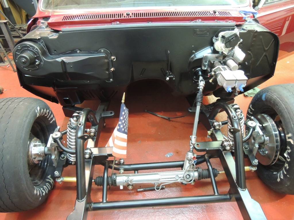

      First time on the ground with new chassis.......Been about 6 months on jackstands getting everything to fit correctly....

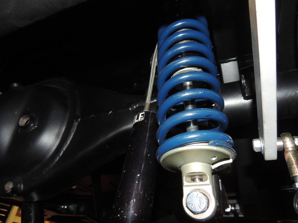

      Got My Penske Double Adjustable Racing Shocks Installed...

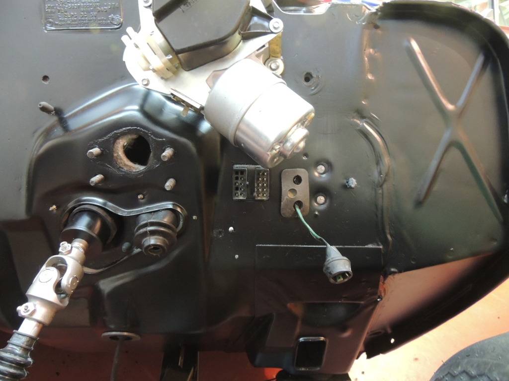

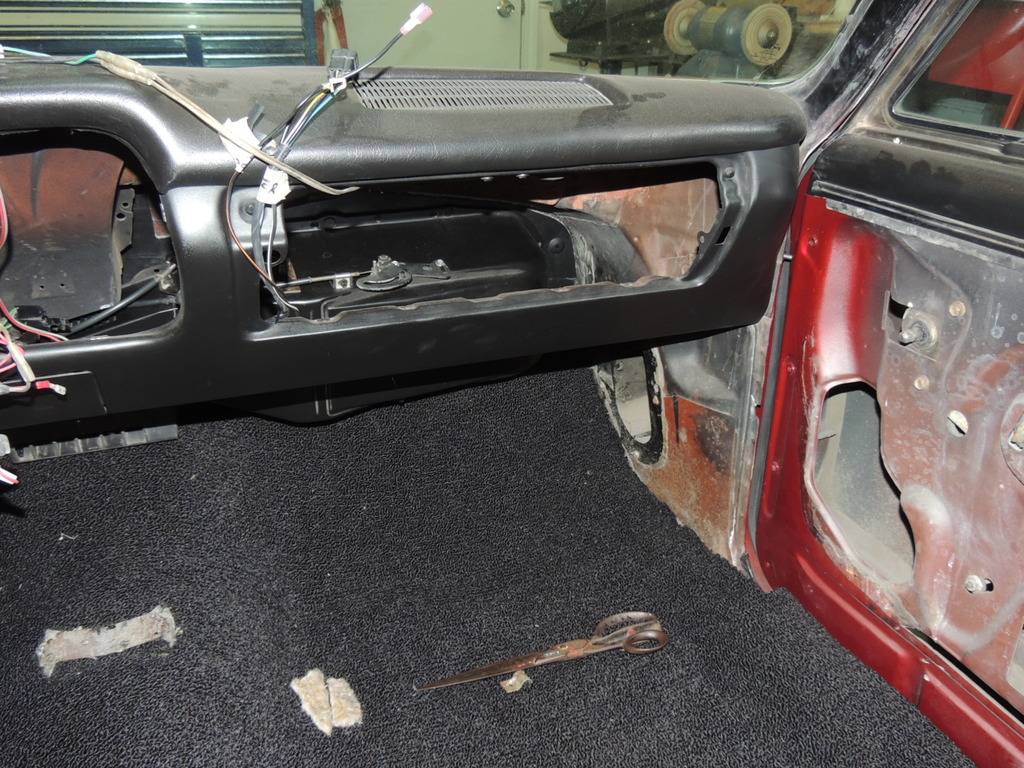

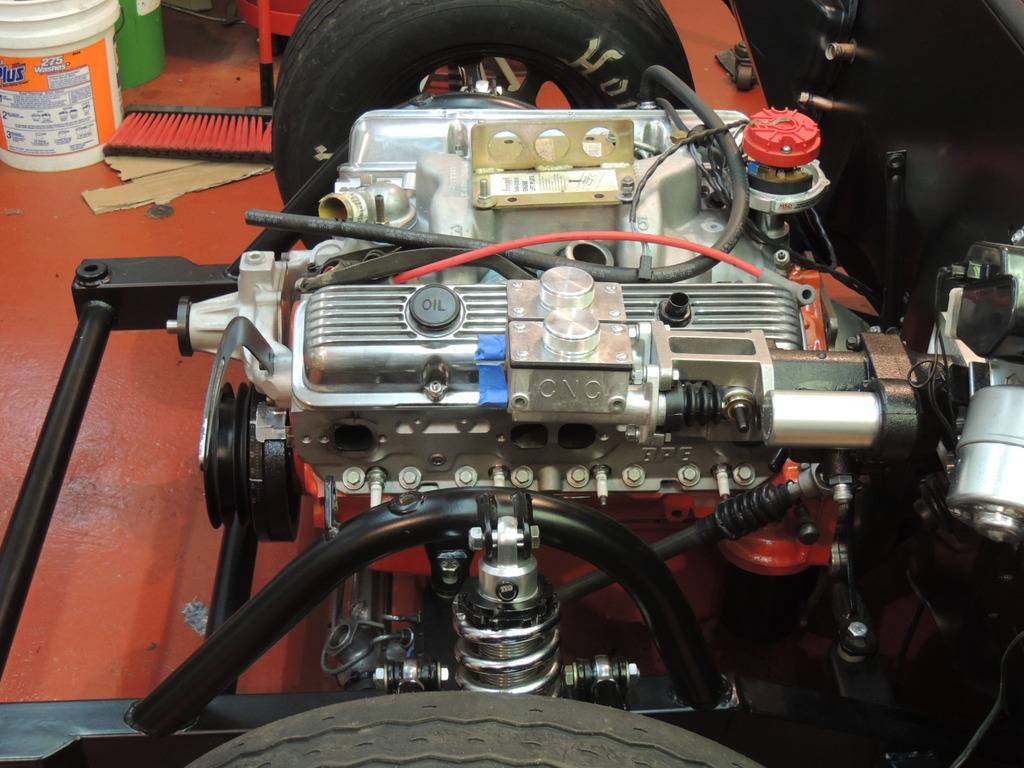

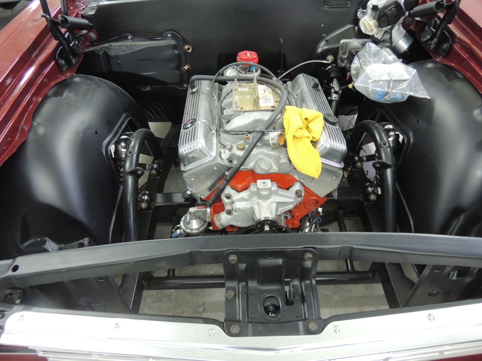

      Starting To Do Final Assembly, Finally!
      Starting to do final assembly, Finally!
      Firewall pad is in
      Carpeting is about 50% done. It is cut to size, but seats and belts aren't cut in yet.
      Steering column is in...
      Put a collapsible steering shaft to the rack...
      Heater Box is in...
      Hydro-boost is hooked up
      Dual Master Cylinders are in...

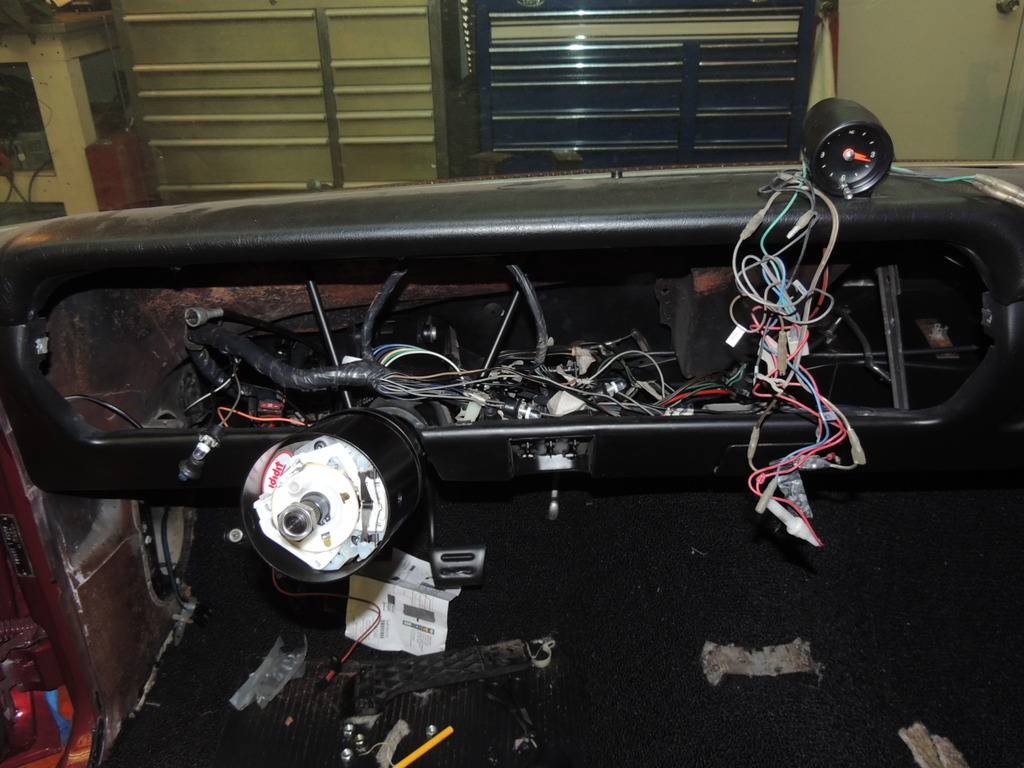

      Started wiring - What a mess...

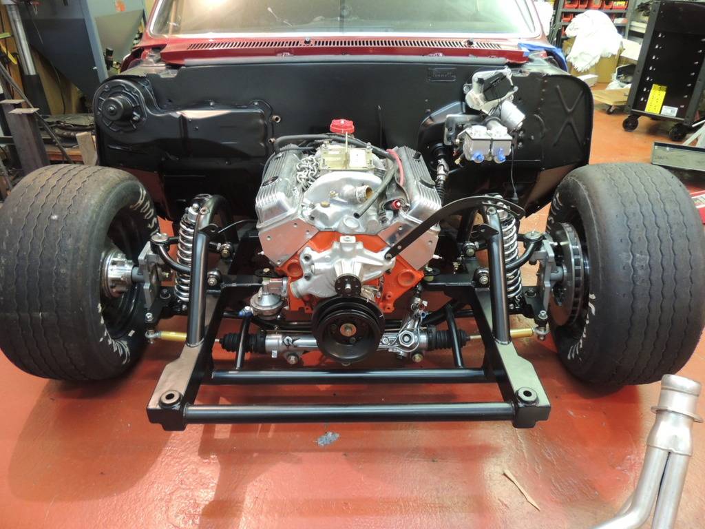

      A little further
      The intake, carb and valve covers are from my 72 Z/28 that I sold around 1980......

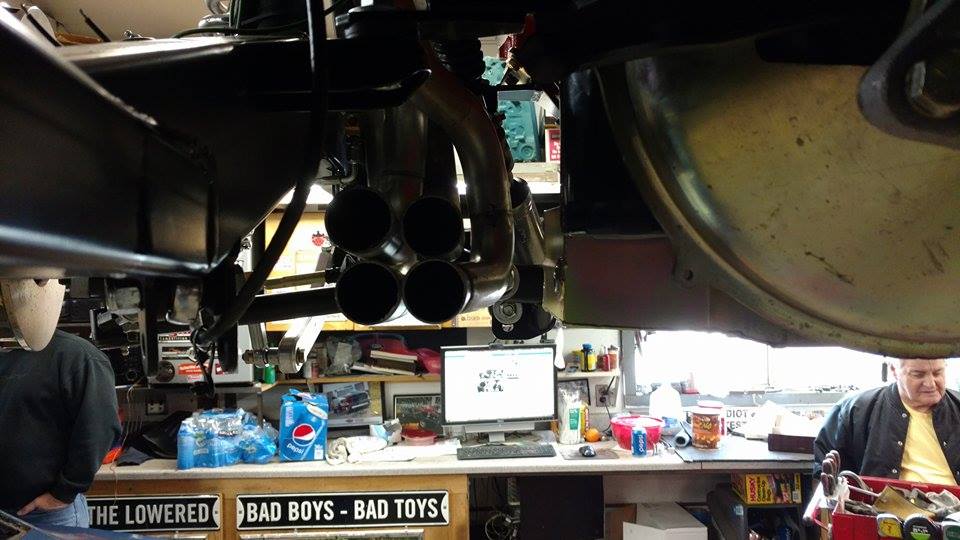

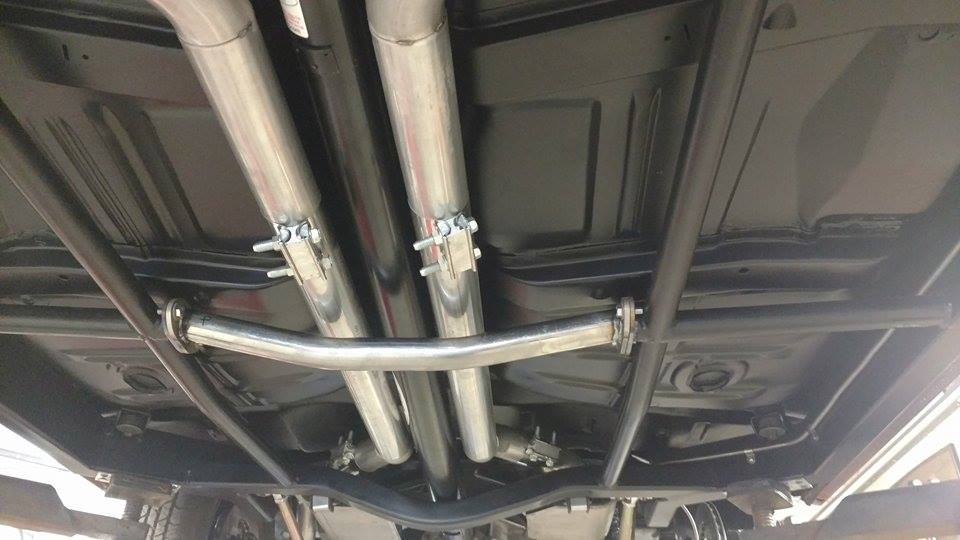

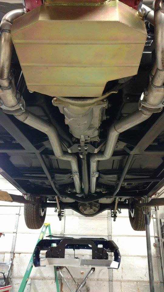

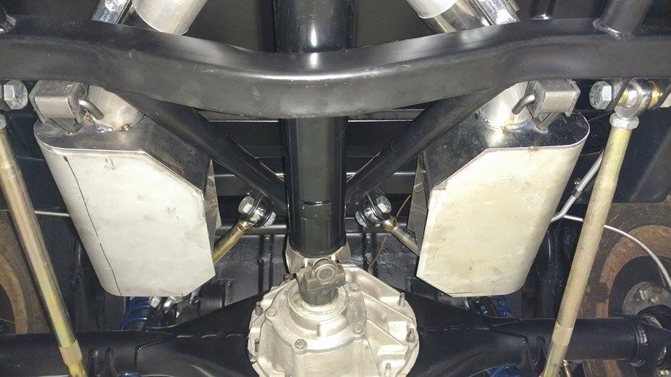

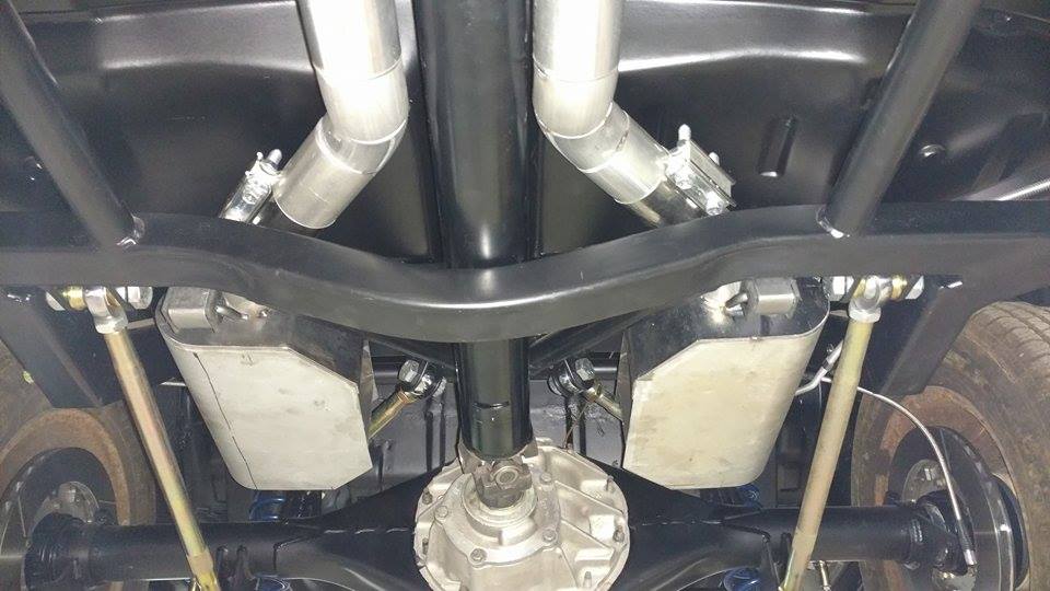

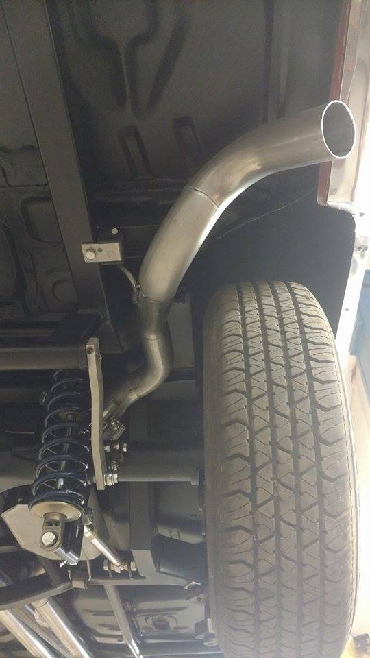

      After 1-1/2 years I can nearly see the finish line....Some header and exhaust pics at a shop...The header guy took my existing headers completely apart and gave me more clearance to run the plug wires underneath the headers and shortened them a bit so they wouldn't hang down so far. Now the headers and exhaust are close to bottom of the car and won't hit the ground...He had to extensively modify the mufflers and also make a removable crossmember
      The headers are now off to powdercoat...
      Then took the car to the guy who painted the car to have him install the front end sheet metal. I don't trust myself to do this and I am all by myself, so I don't have help, either...
      Headers are out being powdercoated....
