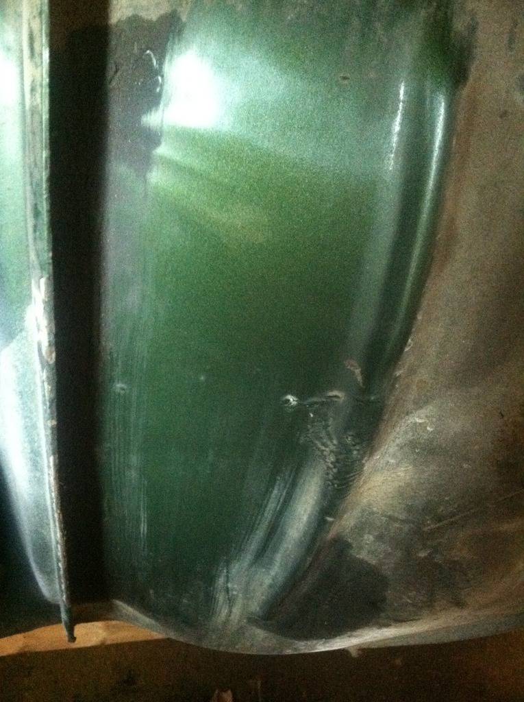

      The factory green paint.

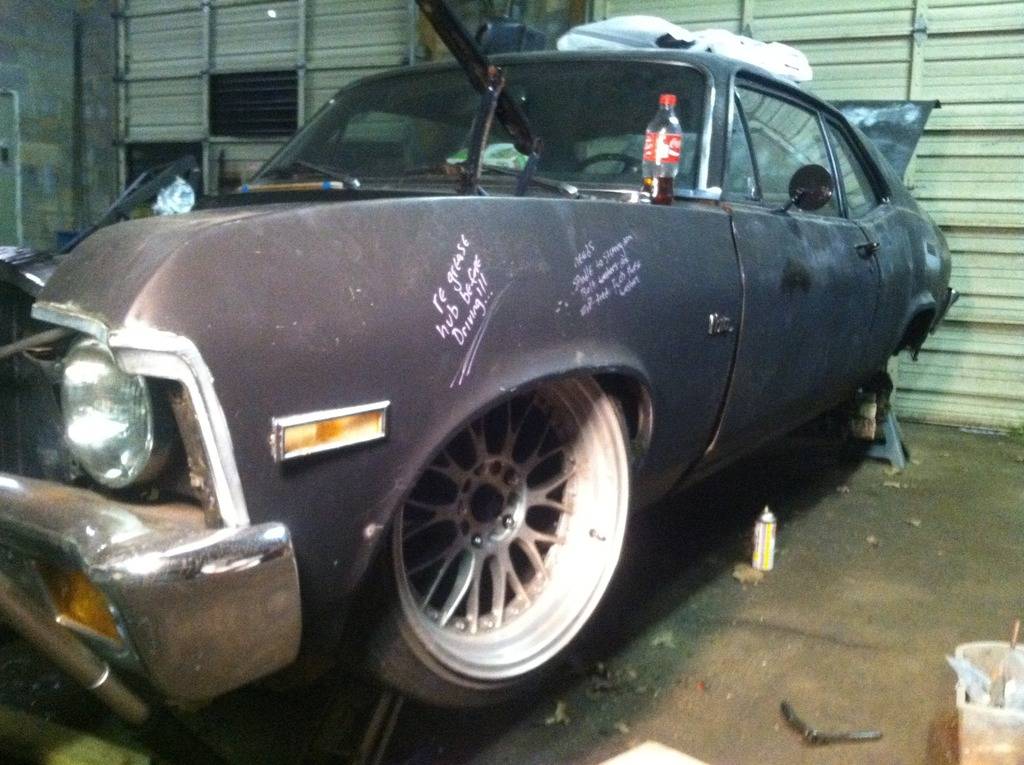

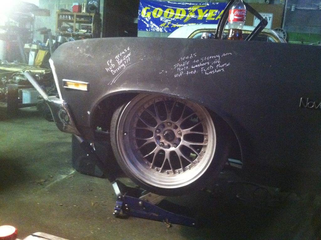

      First test fit of the wheels. The stretched tires will not be staying.

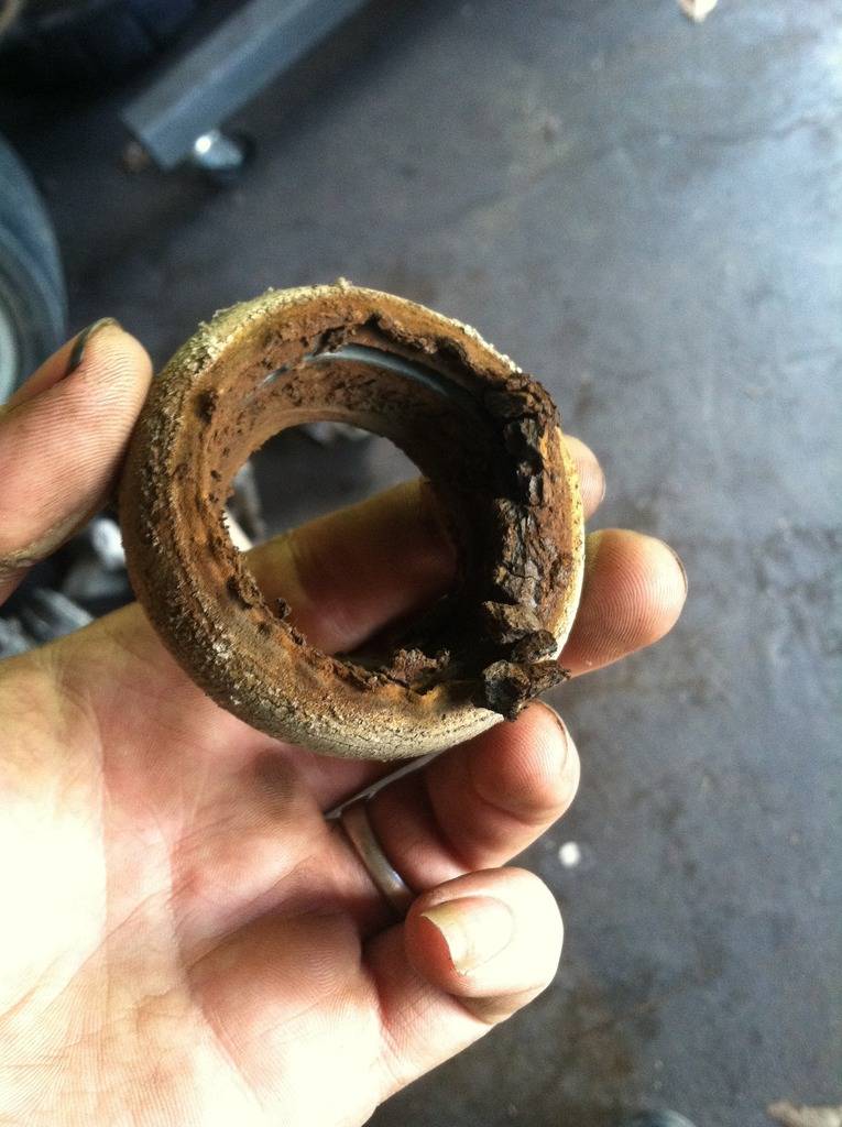

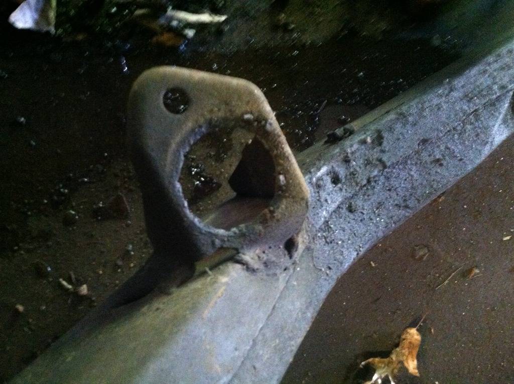

      Front subframe bushing (at firewall)

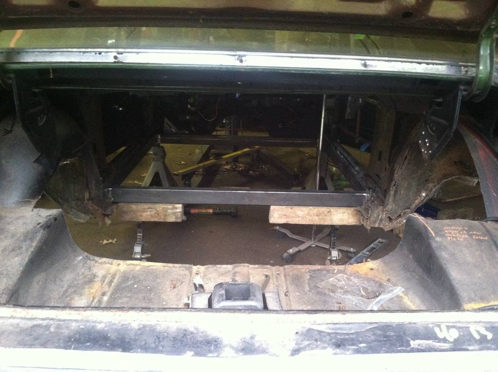

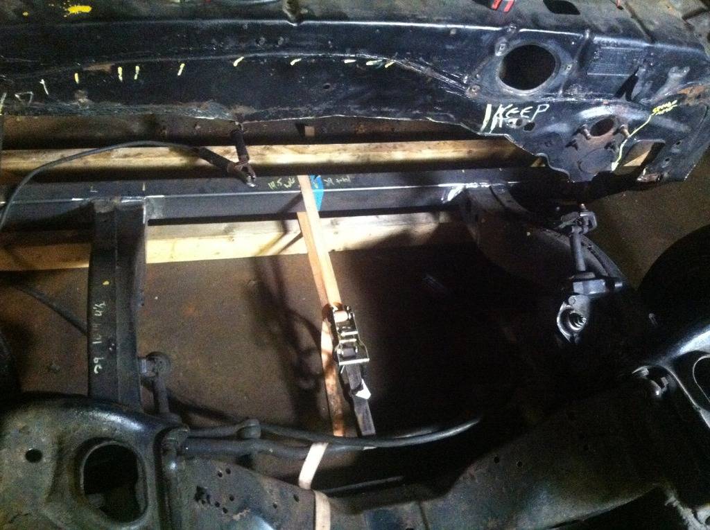

      The main portion of the frame. The perimeter rails are under the door sill. I will triangulate the corners when I do the cage. These rails are 2"x3" 1/8" wall.
      With the frame rails on the ground. To put it in perspective, I'm 5'6" :0
      If I were keeping the stock wheel openings, id be tucking lug nuts with the frame on the ground. All of this "frame on the ground" nonsense will be explained when I get to the suspension later.

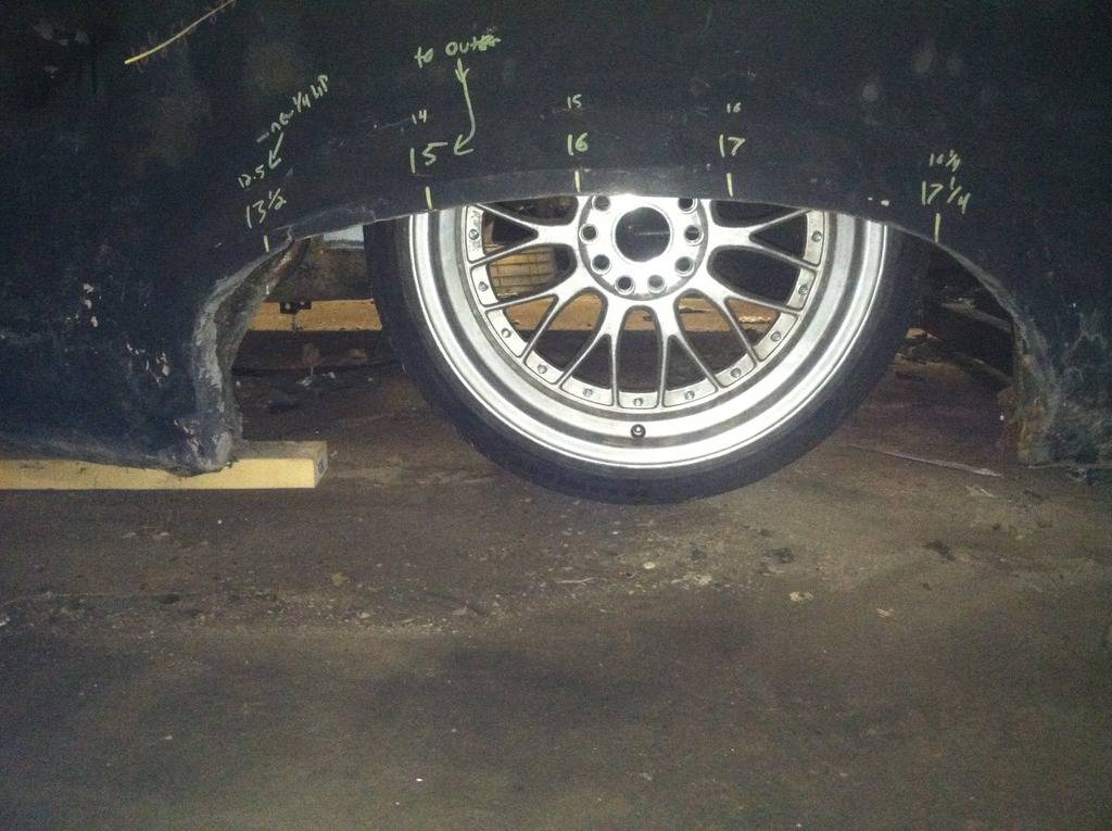

      This is at 3.5" ground clearance. This is also where I realized my desired 3" ride height wasn't going to work with the stock wheel openings. At this point, I sat down and drew up the "rendering" you will see later.
