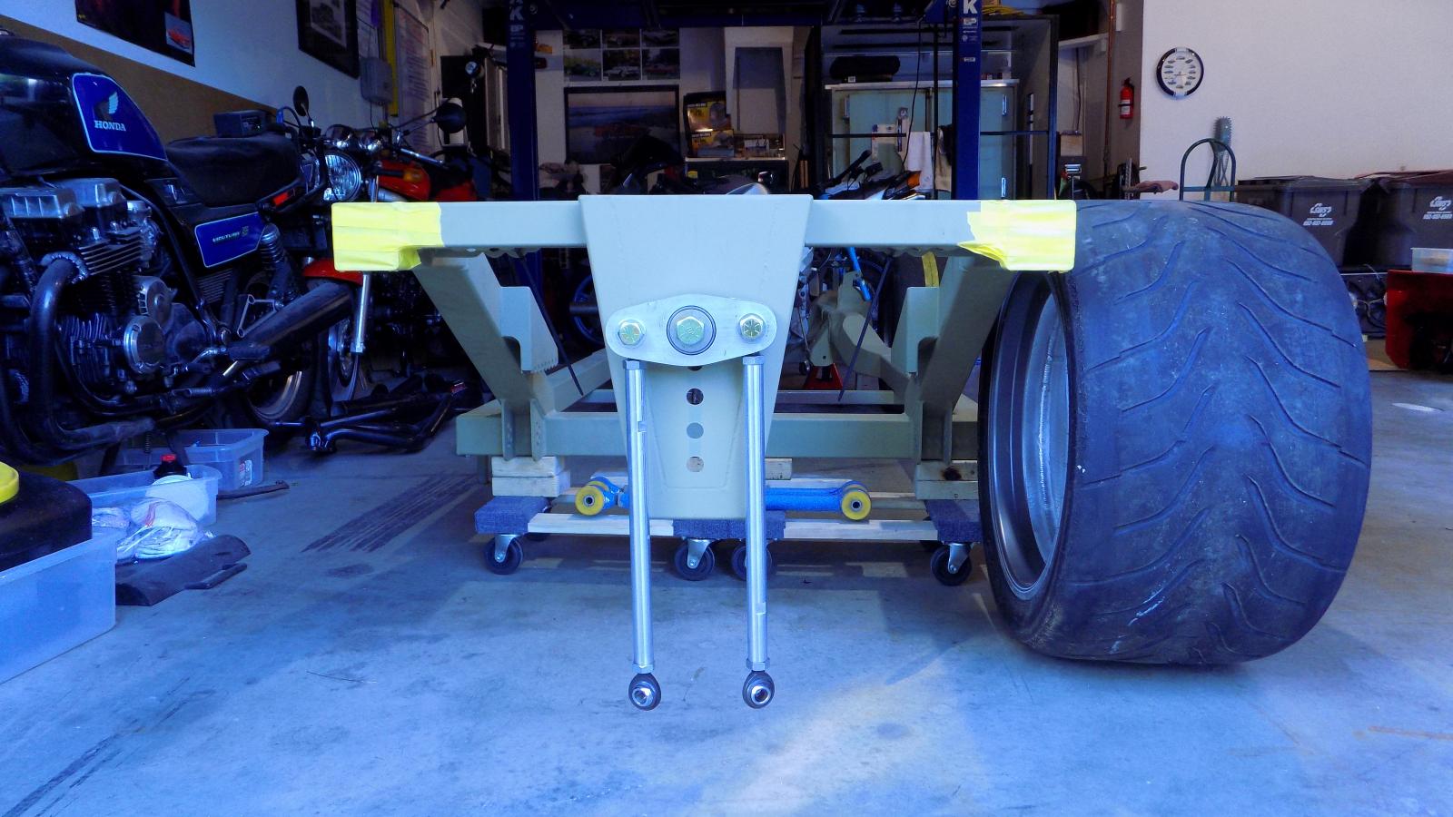

      Brought it home just before the 4th of July this year.
      Here's a couple shots showing the watts link and chassis mounting for it a little better and also a shot of some clearance issues that I'll need to address.

      The watts pivot is shown in the uppermost hole above. When everything is mocked up at ride height, it actually rides in the center hole.

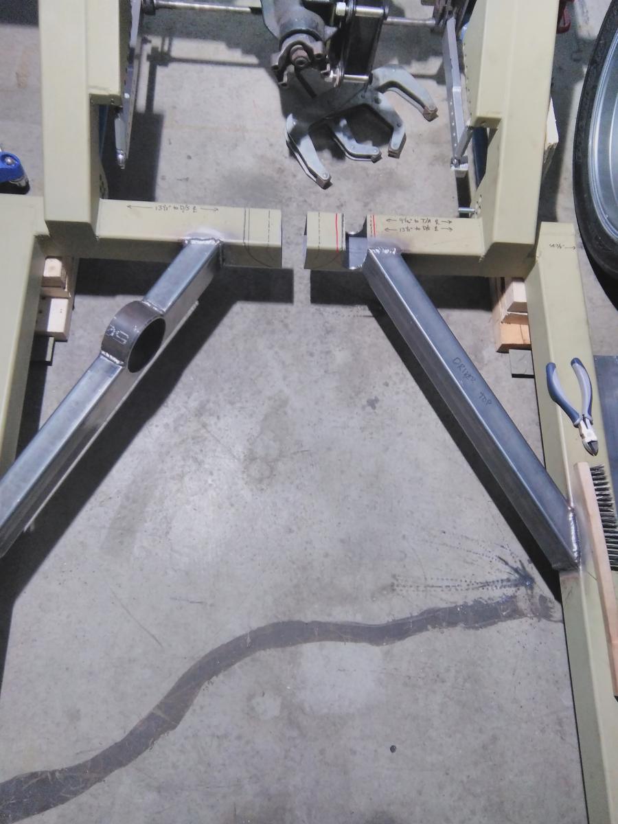

      Name:  need clearance.jpg
      Clearance for driveshaft and torque arm droop? Yeah, might be needing some of that.
      I can barely slide a quarter between the crossmember and the lower bar of the torque arm.
      I have a plan to remedy that.

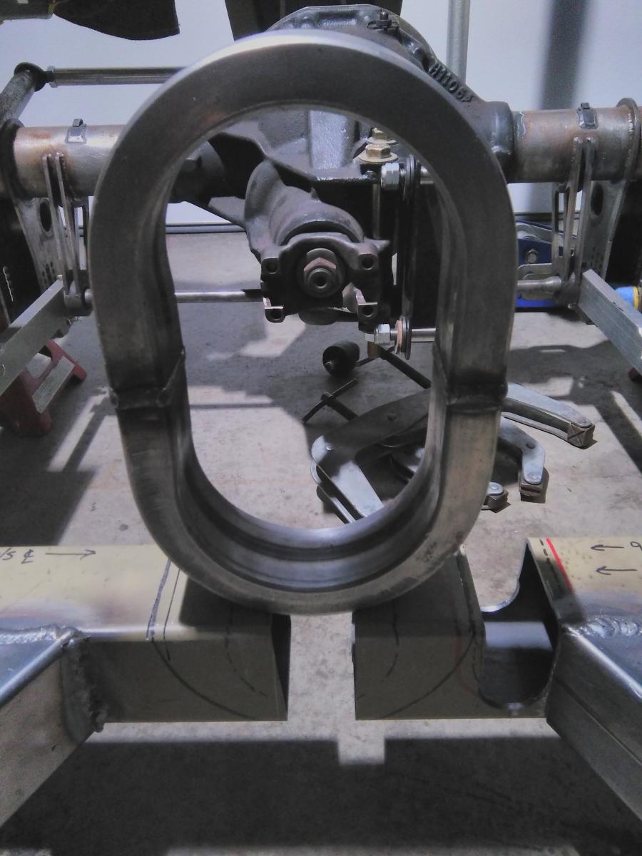

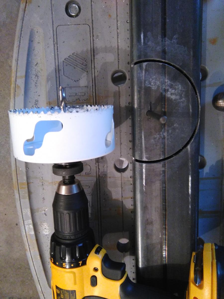

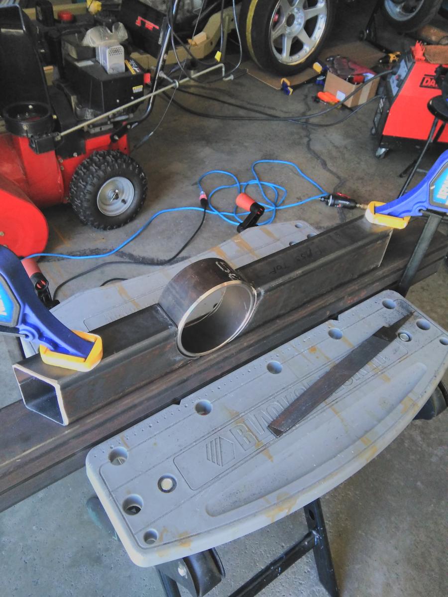

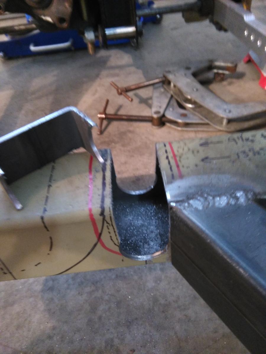

      Made a little progress on the lack of clearance at the rear crossmember issue. Scroll up to the last pic in post #21 to see where I started from.

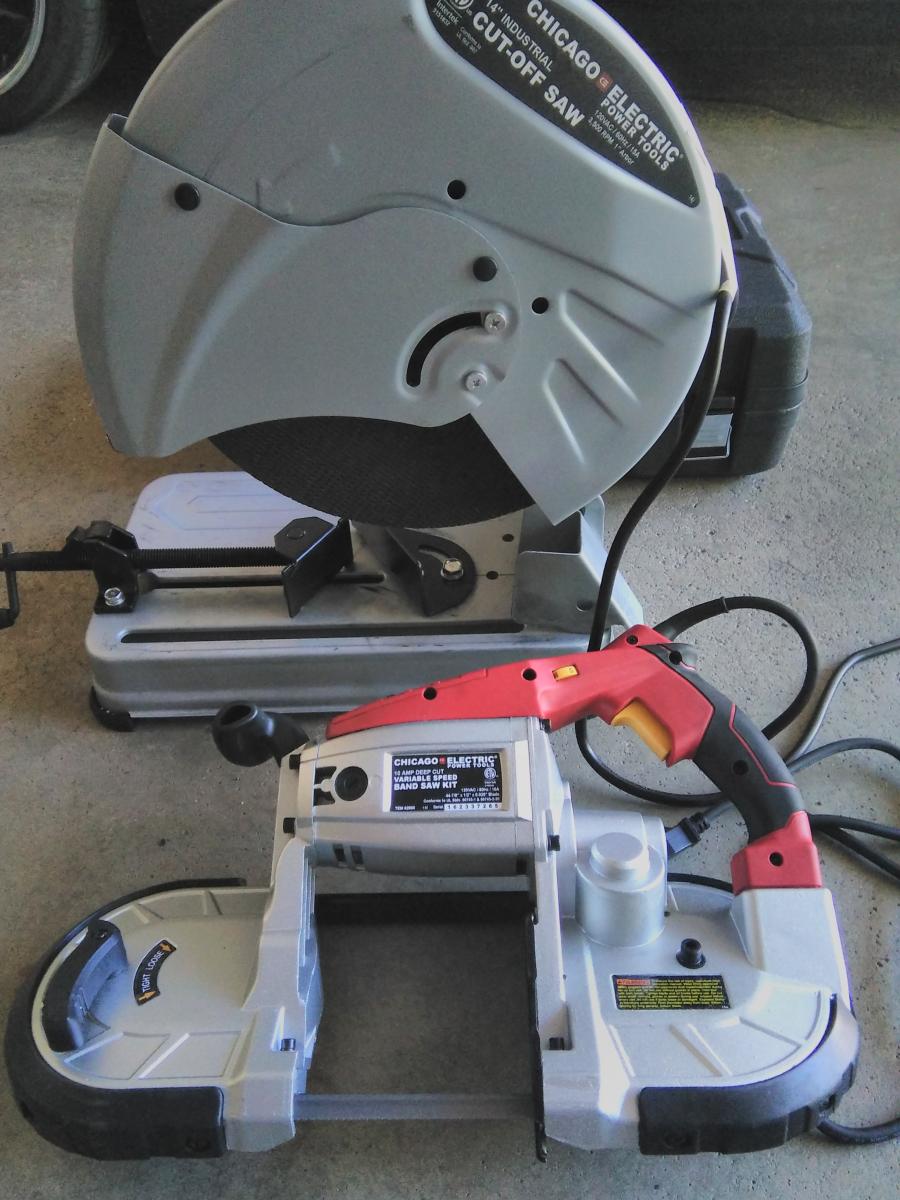

      But first some tools! One of the best parts of a build is that you can easily justify tool purchases.

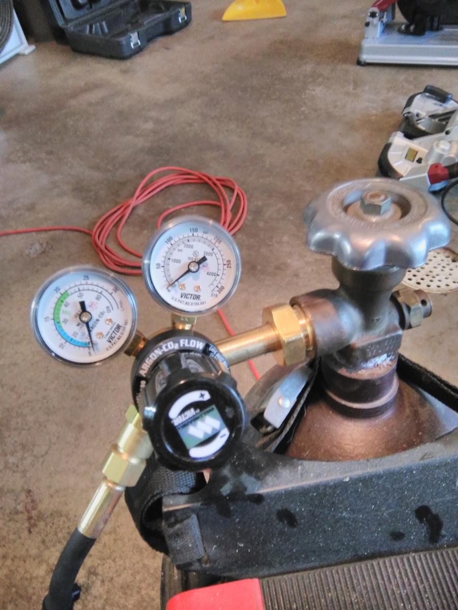

      New MIG regulator that replaced the original that blew out the diaphragm.

      14" chop saw and variable speed bandsaw. Yep, from Hazard Fraught. They get the job done.

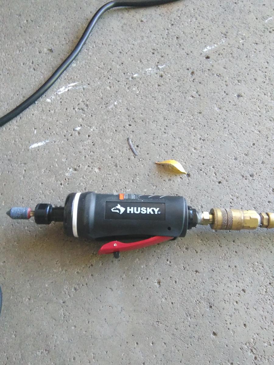

      1/4" shank air powered die-grinder.

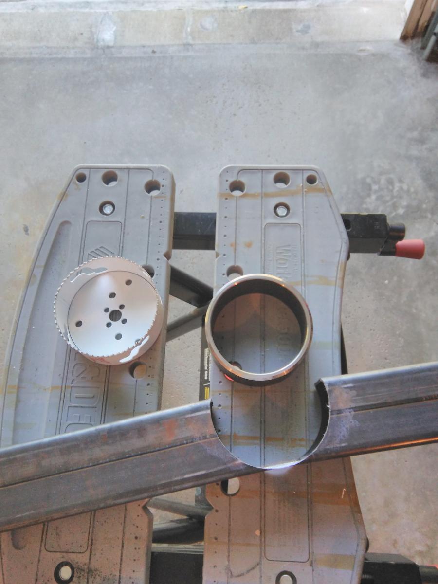

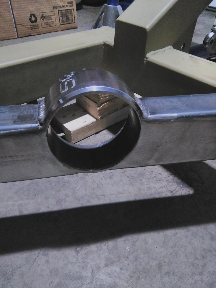

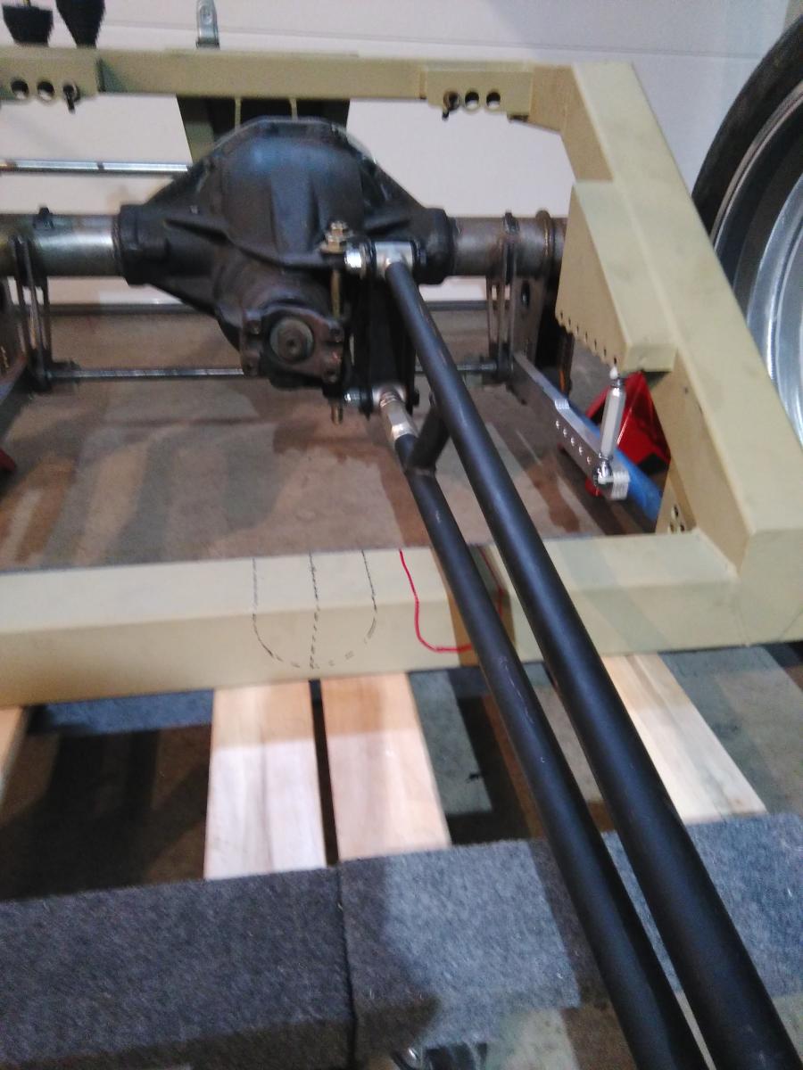

      Ugggh, pics got out of order. Anyway, still have to make a closeout piece for the torque arm clearance cut and finish the radius cutout for the driveshaft loop.
      Still not sure exactly how I want to integrate the 2" wide loop into the 3" wide crossmember..... suggestions?

      correction: I did get the d/s and torque arm clearancing in the crossmember done.
