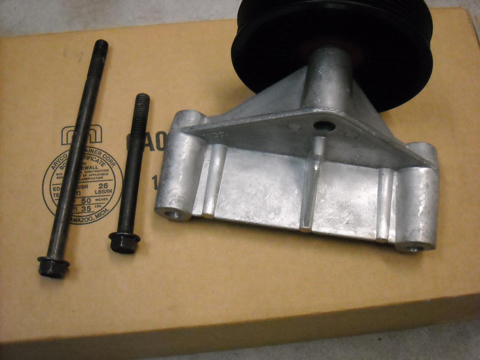

      I recently pulled off a serpentine system of a 1989 camaro to put on my 68. I ordered the smog delete pulley, it's the same smooth one that come with the gm kit. The problem I ran into is that the mounting hole is threaded and the bolt I have has a shoulder and goes all the way through and bolts to the head. The shoulder won't fit through the pulley bracket. I tried just using two bolts but it needs to be to long to fit into the bracket. I was thinking about drilling out the threads and just not having fore and aft resistance. Hopefully my pictures help. Its the long bolt in the middle of my pictures and the top bolt of the of the idler pulley in the assembled system.

      Drill out the threads, and cut a piece of pipe to fit tightly between the 2 brackets.

      Good idea. Thanks

      I was able to get the GM belt numbers off your picture, 6pk2470 88986814, which looks to be a Dayco 5060970 which is 97.05 inches long. I just got my smog delete pulley and the one I got already has the spacers built in and the hole have no threads. The second picture shows it mounted in the larger pulley bracket. I got mine from EBay and the part number is 10186167. Here is a link to a similar one http://www.ebay.com/itm/New-Accessor...xXjbs3&vxp=mtr. Hope this helps and its not too little too late.

      I wanted everyone to know that using the Dayco 5060970 97.05in belt along with the 4-1/2 in pulley that came with my smog delete bracket, the belt is too short. I just ordered a small 3in idler pulley like the in the picture at the beginning of this thread that I hope will resolve my problem.

      Smaller 3in idler pulley worked with the 97.05 belt.
