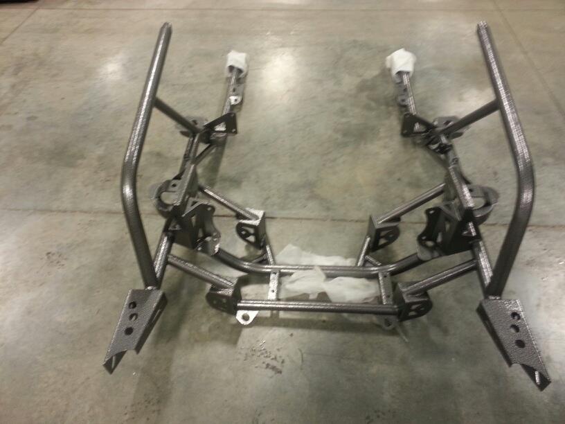

      I have a 68 Camaro that I am getting ready to start on. I am looking at the hotchkis tvs system that lowers the car 3 inches. My question is, I have run across a pa racing tubular subframe with qa1 tubular control arms. Would this work well with the hotchkis tvs system? Just trying to get parts together before I start the build. Car will be a cruiser maybe the occasional autox just for fun. Will have a built 383 stroker with Muncie 4 speed. This will kind of be a budget build, since my ZL1 has been getting a lot of go fast parts. Any help is appreciated.

      Is this the tubular subframe you're talking about? If so, that is a drag racing sub which is designed to be light weight and would be virtually useless for going around corners.

      Yep, that is the one. I will stay away from it then. I am going to purchase a subframe, and have found a new stock unit for about 1k. Are there any aftermarket around this price that are good? I don't need anything crazy, just something that is solid and will fit well.

      It sounds like your best option would be to go with a stock subframe that has been welded up and then install a ridetech Streetgrip or Truturn system. Whatever you decide, DO NOT buy no name suspension parts off ebay and DO NOT mix suspension parts from different manufacturers. Buy a complete kit like ridetech which is engineered to work as a system.
      You might keep an eye on the classifieds and see if anyone is removing a stock sub to install an aftermarket.
