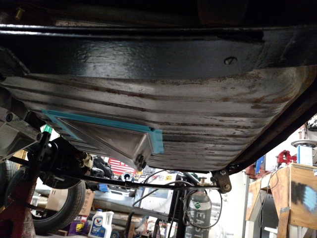

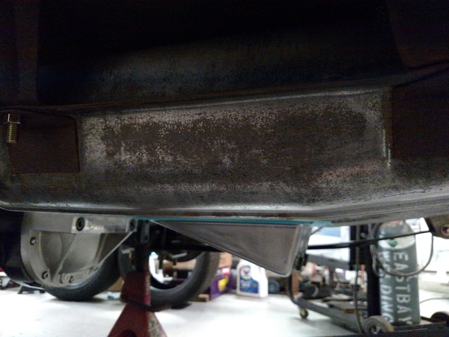

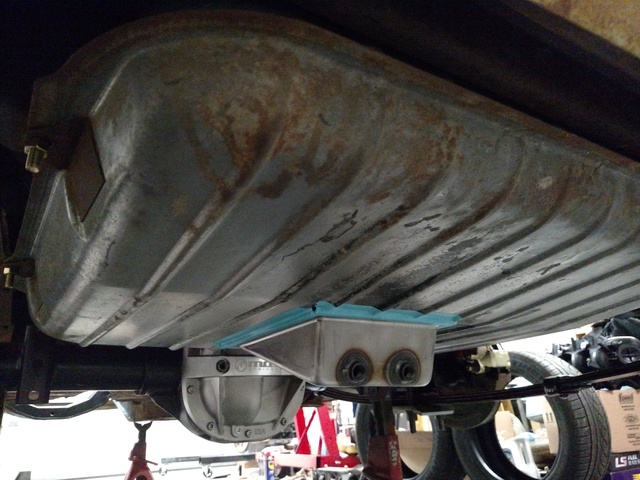

      Started mocking up the sump I'm going to add to the original tank. It's 3" deep but won't hang any lower than the center of the frame.
      I'll probably end up moving it a little closer to the front of the tank to get the best departure angle.

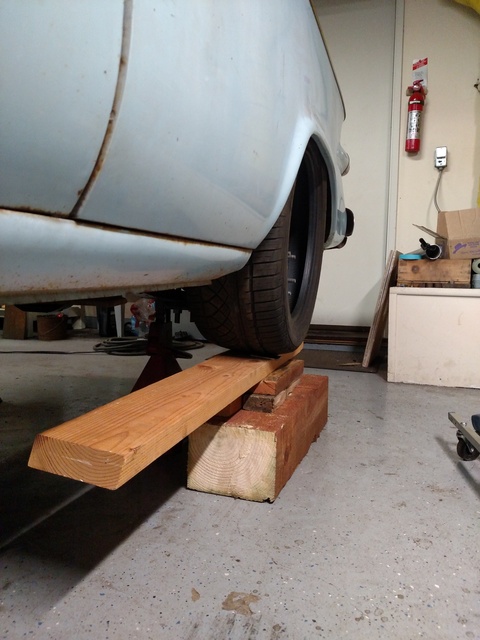

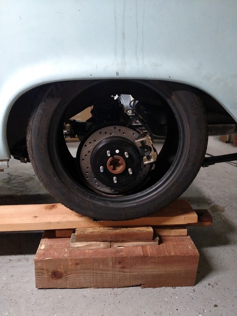

      Also mocked up the potential ride height at about 6.5"
