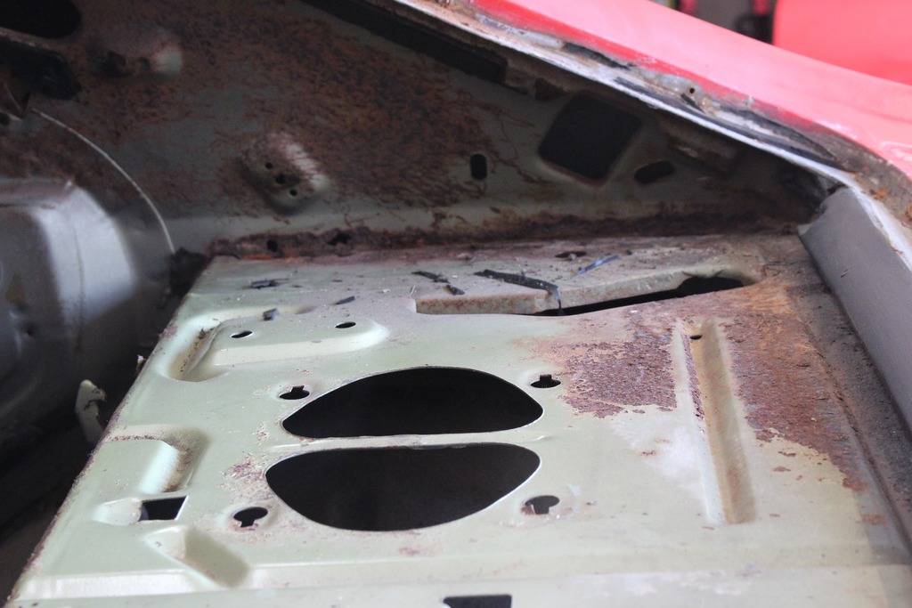

      Tear down complete. Next it's off to media blasting.
      Obviously, the package tray is toast and the passenger side rear floor pan needs replacing. Probably the driver side rear floor pan, too.
