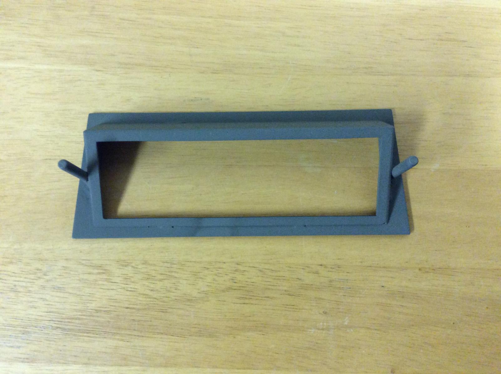

      I finally got this bezel ready for paint. Most of the single din installs I've seen stick out from the dash and I wanted more of a recessed look. I made this from 1/8" cold rolled steel. The round mounting lugs bolt to the two existing holes used to mount the stock radio and the bezel's threaded studs slide through the flat plates and tighten down. I'm going to paint the whole assembly gloss black to match the dash.
      Having owned the 67 for 40 yrs, I've tried a lot of the aftermarket radios including Retrosound, the am/fm repro etc. but none have the variety of functions and options as a simple $100 DIN head unit IMO.

      By far the nicest looking mounts for a 67/68 I have seen. If I had not just bought a retrosound for our firebird I would have bought one from you. Excellent work

      Thanks for the kind words. I didn't mean to imply they were for sale, way too much work doing it by hand.It's made out of five individual pieces welded together. It would be nice if someone could throw a block of 6061 on a mill and make them.

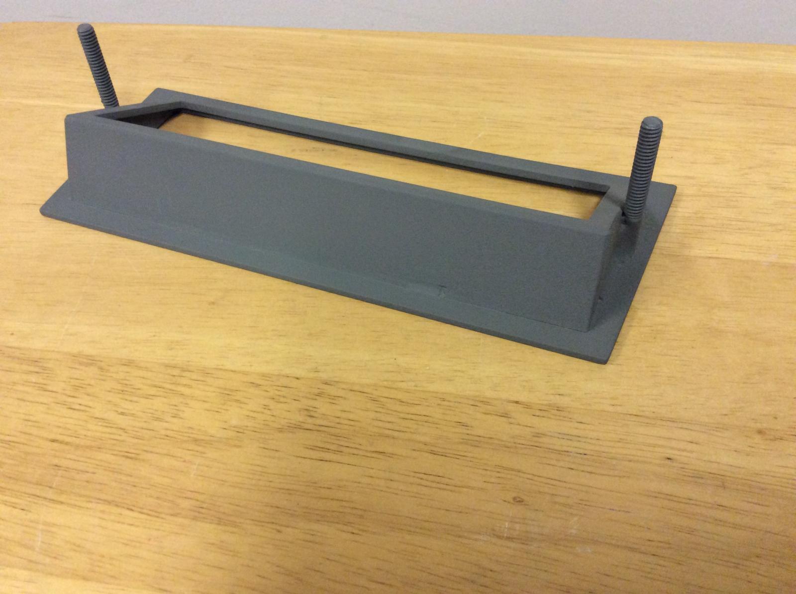

      Awesome Job, I was looking at doing something like this just the other night. I was struggling on how to mount it, It looks like to come up with a very slick solution. Any chance you could post a few more pictures of the back of the bracket? Thanks
Size:  170.8 KBName:  image.jpg
Size:  165.4 KBHere you go.
