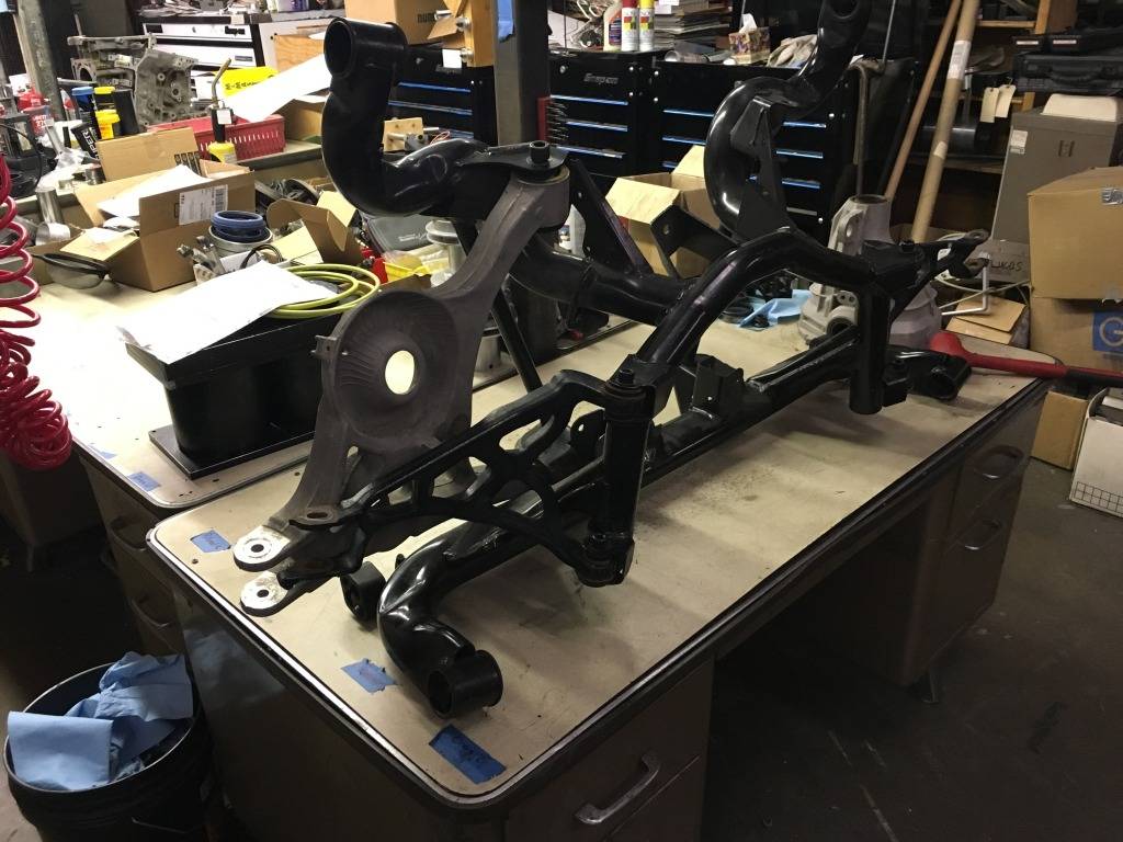

      Rear suspension is about to go in the car for mock up. Eventually going to build tubular control arms and change the geometry up after the car gets some drive time

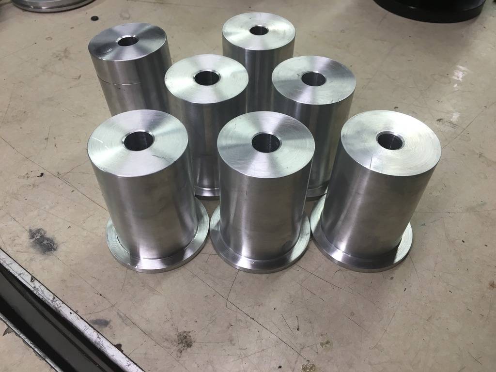

      Rear IRS cradle bushings that I made

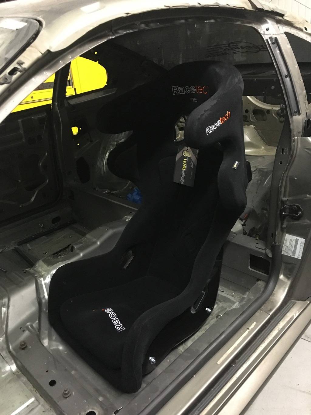

      New seat, money well spent!

      I read a lot of threads and guys say they want to race their cars etc. but nothing makes you look more serious than a ****in seat like that. Keep it rolling, I enjoy these mustangs and there aren't enough on here.

      Full containment baby! Thank you and that's probably one of the best compliments anyone has ever given me. Learned a long time ago that safety should be the most important goal when you're building a car.

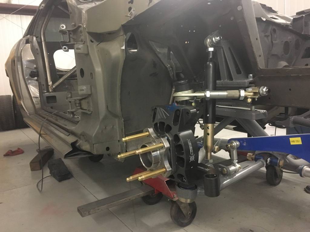

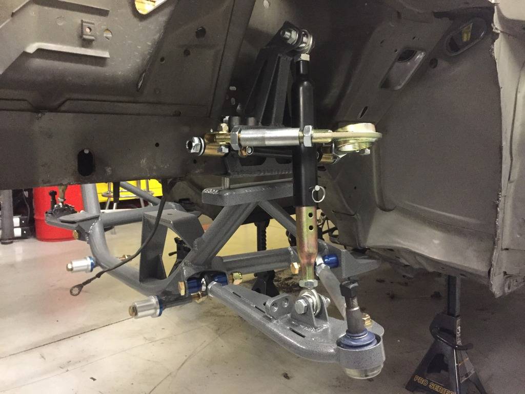

      Missed this first time by. What's the deal with the SLA front suspension? Aftermarket, or did you build yourself? Any details?

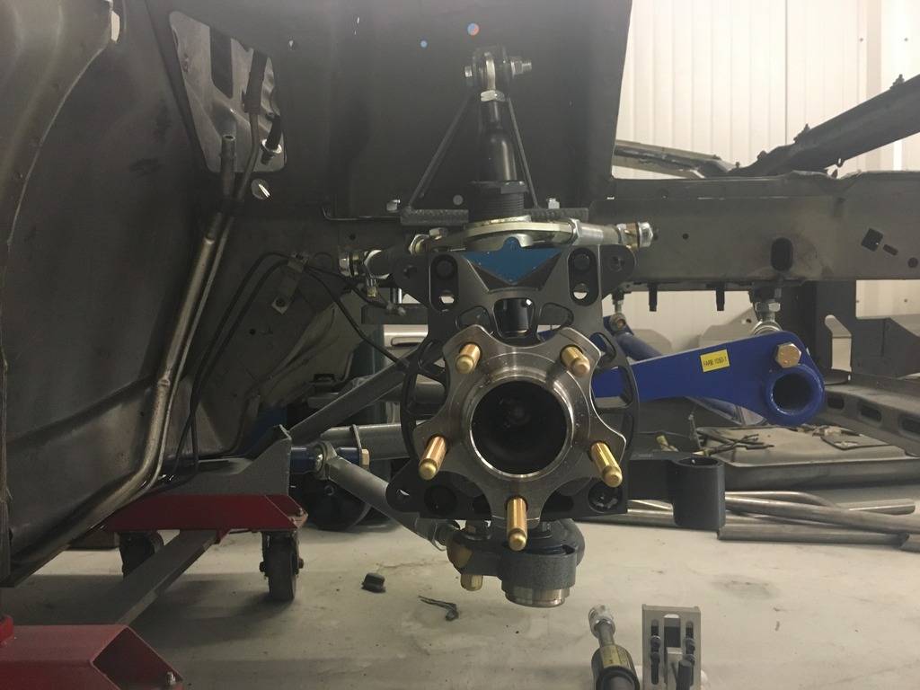

      The front suspension is from Griggs Racing. A few companies make SLA kits for these cars, but I've always wanted to try out the Griggs stuff. Trying to figure out which front upright that I'm going to use. Either use a Griggs, cortex or build my own, but haven't gotten to that point yet. Also, going to run a nice set of 3 or 4 way shocks from either JRI or Penske. What else would you like to know?

      Nice build - good start going. I am currently doing a 1997 with full Griggs World Challenge set up. I need to start a build thread.
      What front hub assemblies are those?

      Those cortex spindles are beyond sexy. Itll be a shame to cover them with whatever aluminum hat 14 inch rotor you choose. Killer car. I'll be following along for sure.

      Thanks guys! Are you keeping the stock front hubs or going with aftermarket on your GR40 build? These are cortex hubs and I couldn't be happier with them. Lots of modularity so the options are endless. I'll be bummed to cover them up, but I have some plans to "modify" them a bit in the future, although my goals right now are to just get this thing sitting on its own weight.

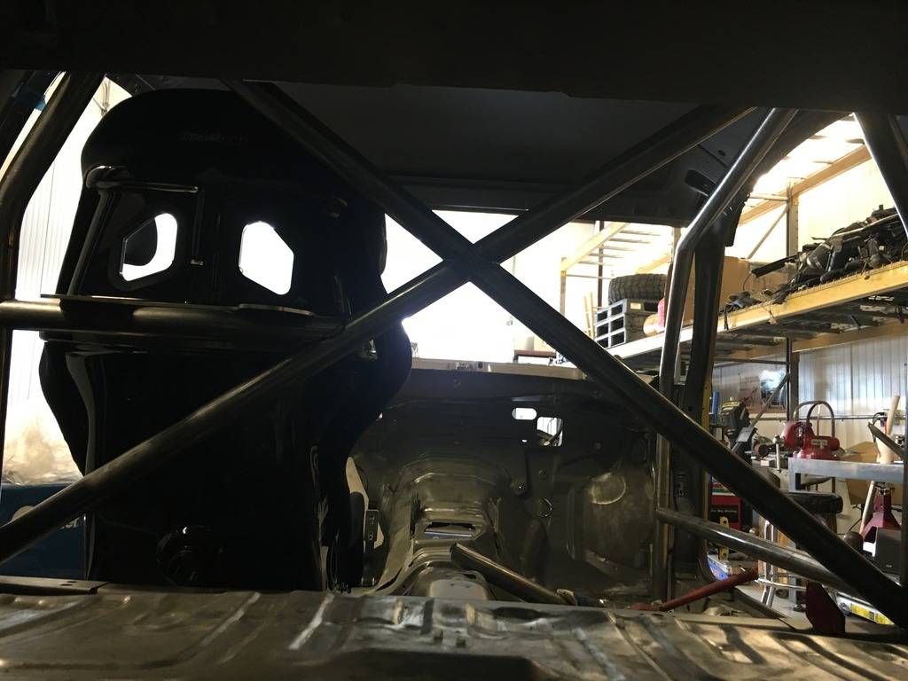

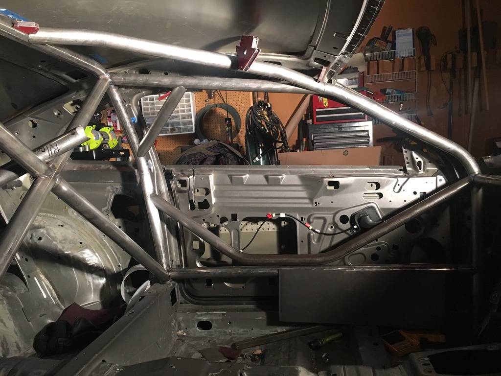

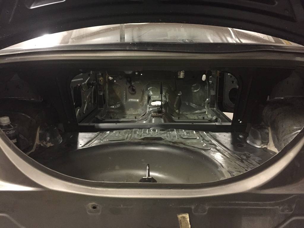

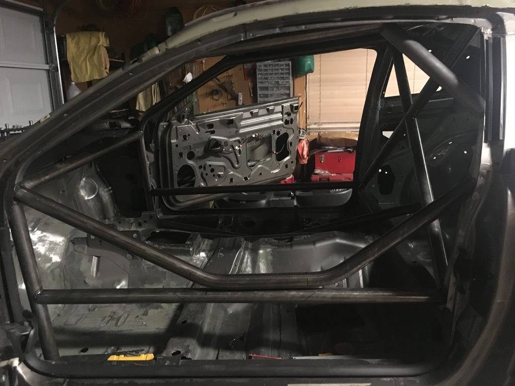

      Need some input, can't decide what to do with the rear roll cage bars, what do you guys think?

      I'm really interested in seeing what changes you make on the IRS. I'm really interested in adapting one into my car.
      As for the cage, $.02 from a non-expert nobody- I've always liked the idea of the cross bar between the two rear shock mounts, with bars from the B-pillar main hoop extending down to the same bar. To me, it would provide the rigidity to the chassis, nicely support the main hoop, and would still allow something of a crush zone in the rear of the car.

      I'll definently keep you updated about the IRS. I think the first thing I'll be doing is some kind of an adjustable sway bar that mounts in the trunk. Since there aren't a lot of options for sway bars for the IRS, i think that's where I'll start and go from there.

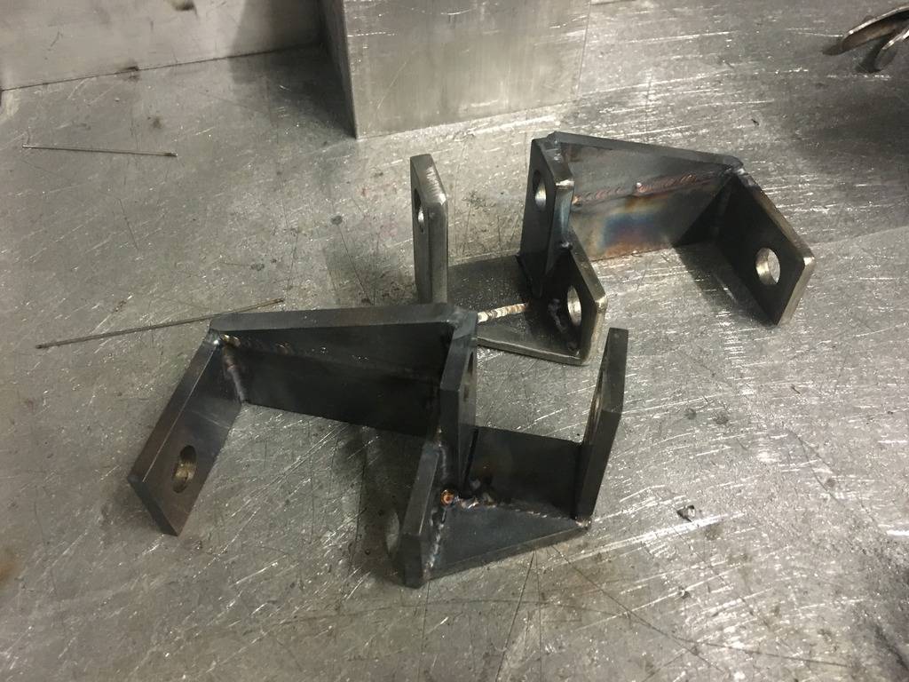

      I've been thinking the same thing about the roll cage, but I've been struggling with finding a way to make the mounting plates. I'm making them out of 3/16" steel plate and don't have the equipment to bend it into the shapes I need. Made some negatives of where I'm mounting the plates and brought them to a sheet metal shop to have them bend up some test pieces. Once I get those back I'll weld them in and finish the back section.
      May 2016
      12
      I'm a little concerned with the way the cross bars will look. I mounted my main hoop a little further back than most people do, so I'm worried that the angle will look weird mounting to the shock towers.

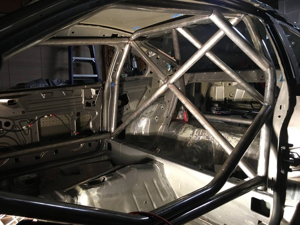

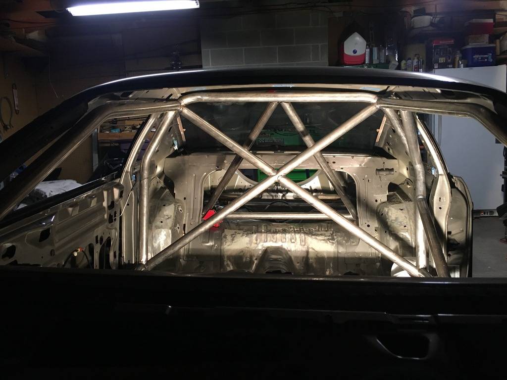

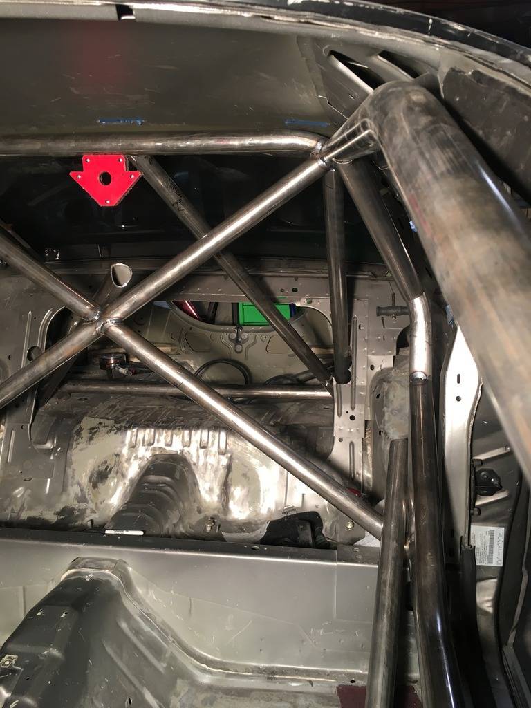

      Update, cage is coming along, been killing it with these notches!
      One side of the rear mocked up
      First overhead bar ready for tacking

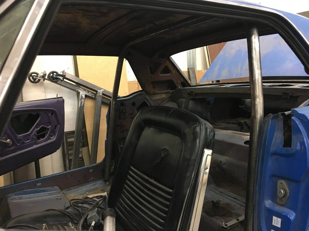

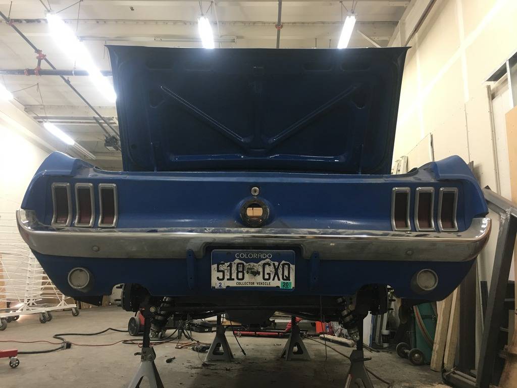

      Also, here's a little side project that I'm working on. Building up a '67 Mustang for some CAM T. The owner wanted to do a TCI full suspension kit, a roll bar and he just decided to do a mini tub as well. I'll update as I make progress. 2 cars at once has been tough, but working on his gets me motivated.
      Started on the roll bar last weekend. He's not sure how far he wants to take it, so we are going to do the tub first and then finish the cage/bar
