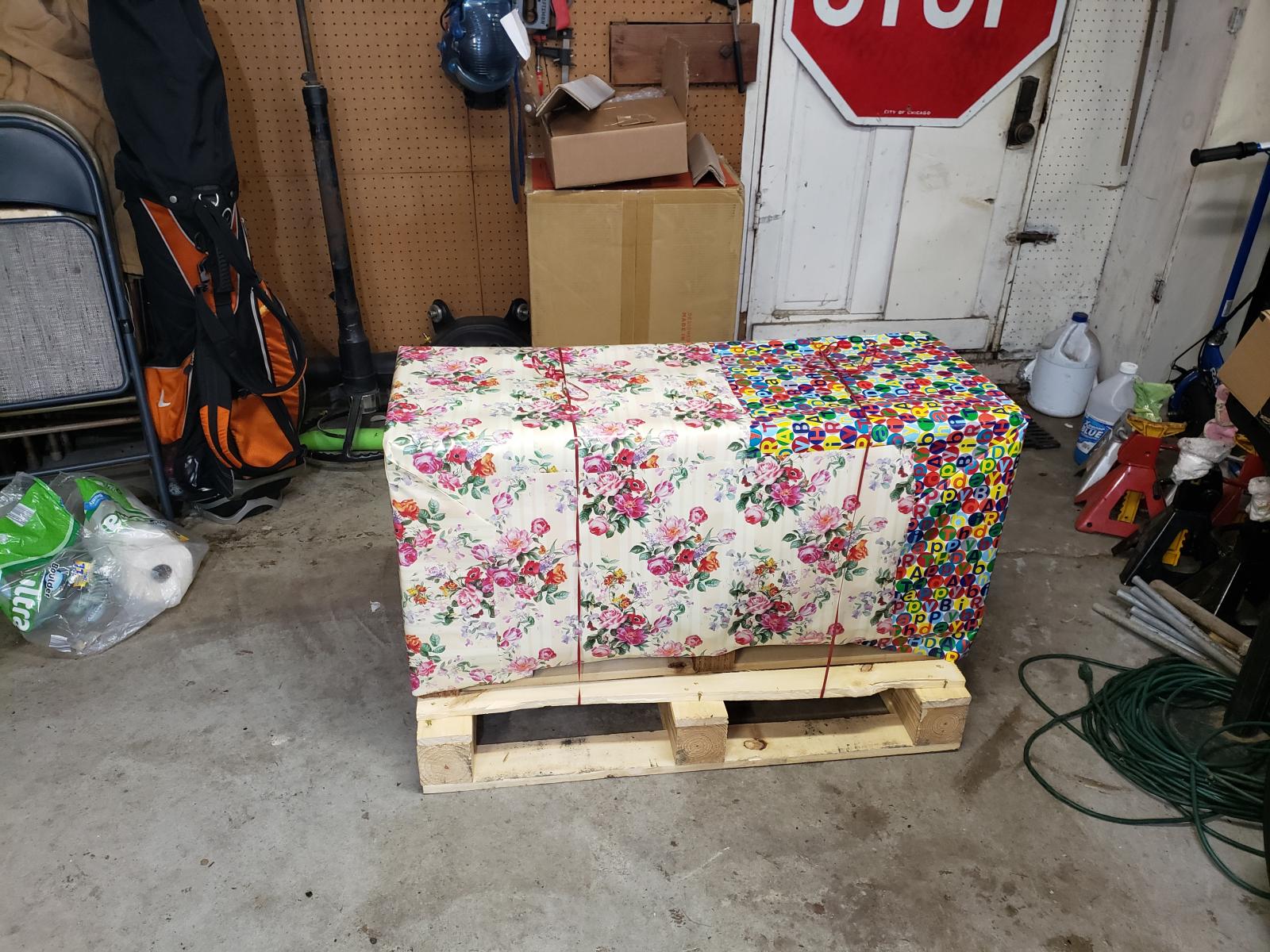

      Just a little update, nothing major. I have been incredibly busy and have not had much time. I was able to clean up the LS engine that I got. I opened up the ring gaps, put in a BTR stage 3 positive displacement cam, LS7 lifters, new oil pump, new water pump, Bought an LSA blower and put a 2.5 griptech pulley on it.
      Also about two weeks ago the tremec t56 magnum arrived. I wrapped it up and gave it to my wife as a present for her birthday. Last birthday she got a LS engine, for mothers day, she got a LSA super charger( a super mom deserves a super charger), and this birthday she got the trans..lol.. I hope in the spring to have the body dropped back on.

      SWEET!It looks Nice!
