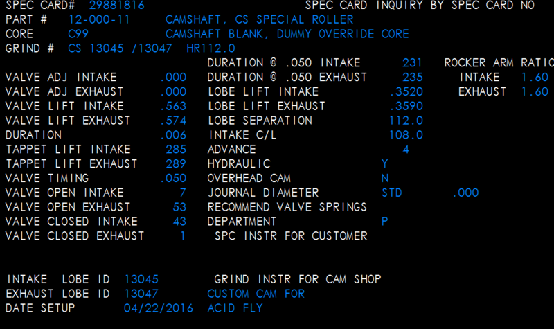

      Ordered up parts for my build, wanted to get some input and power guesses from you guys. I'm hoping for 450 to the wheels. The car is a 5sp with 4:11s maybe around 3500lbs.
      AFR 195 with 64cc chambers
      COMP Cams Ultra Pro Magnum Rockers 1.6
      5.7 Scat I beam rods
      Icon flat top pistons
      RPM Performer intake
      Hooker headers
      Compression should be around 10:7:1
      Custom grind cam

      Think u will be around 400 at the wheels. 383 with AFR 210, CR 10.8, 242/248 600 lift roller made 412 through turbo 400
      Jun 2006
      Katy,TX
      1,678
      Pretty mild roller to get 400-450 at the wheels.
