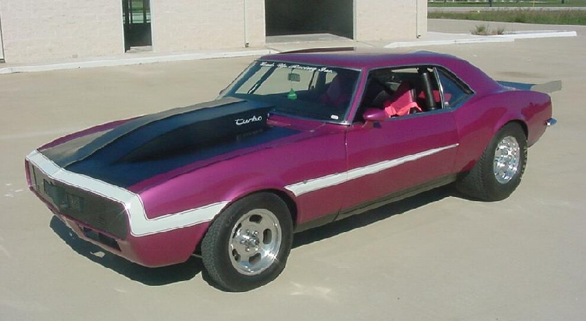

      "Hi". My car is a '68 Camaro with twin turbo MoTown block 6" rod, solid roller 406 stroker with twin PT-52 turbos, HKS Wastegates, CarbShop blow-through, HKS SSQV BOV, etc. Aeromotive A1000 and regulator. The headers are from Kooks, but were modded to fit, I designed all the rest while my cousin at LG Motorsports welded all the tubing together. 720rwhp at 6psi. Normal boost is 9.7 so go figure. Glad to meet you guys.

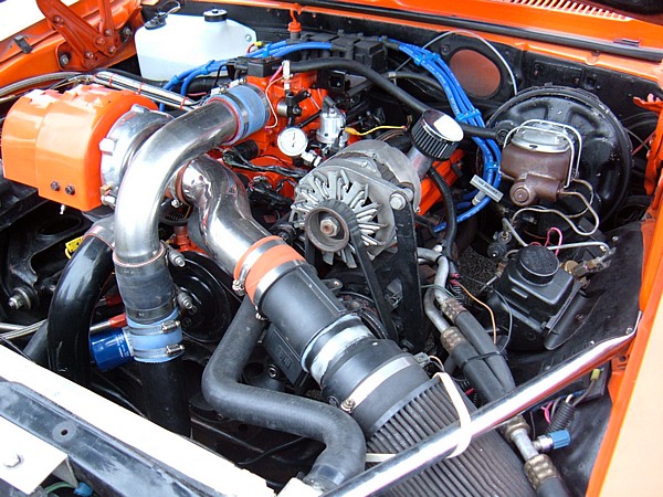

      I have a Buick Grand National transplant in my 69. Have a TE-45A turbo, 80# injectors and a front mount intercooler. Hard to fit it all in but worth the trouble. Best ET to date is 10.83
