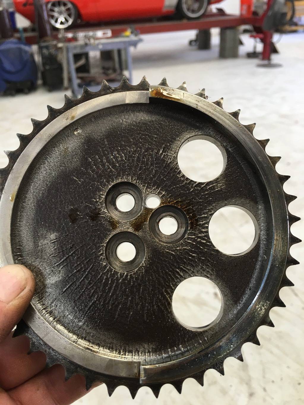

      I was curious if I had the wrong timing gear. The old one we took out has 50/50 high low and this one that's in there now has a high spot that I can feel. I'm not sure if I've got an earlier gen 1 gear in there.

      Gen 2 gear will have the raised portion for the sensor that goes 180 degrees around the gear, same as Gen 3, but the timing marks are different. Here is a Gen 3 gear and looks very close to the Gen 2, but has three bolts. The Gen 2 is a single bolt gear.
