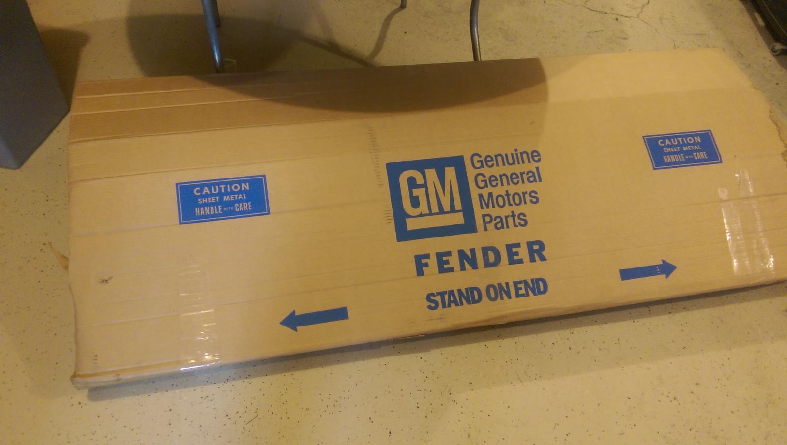

      These fenders have been sitting in my parents basement since '92 along with a new GM header panel. Bolted the front fender on with the AMD inner fenders - I was surprised how well they went together. Kept on moving and added the header and lower front valance panel. Then the final moment - the hood . Obviously I squared up the front end and had some gapping issues. Who woulda thought?
