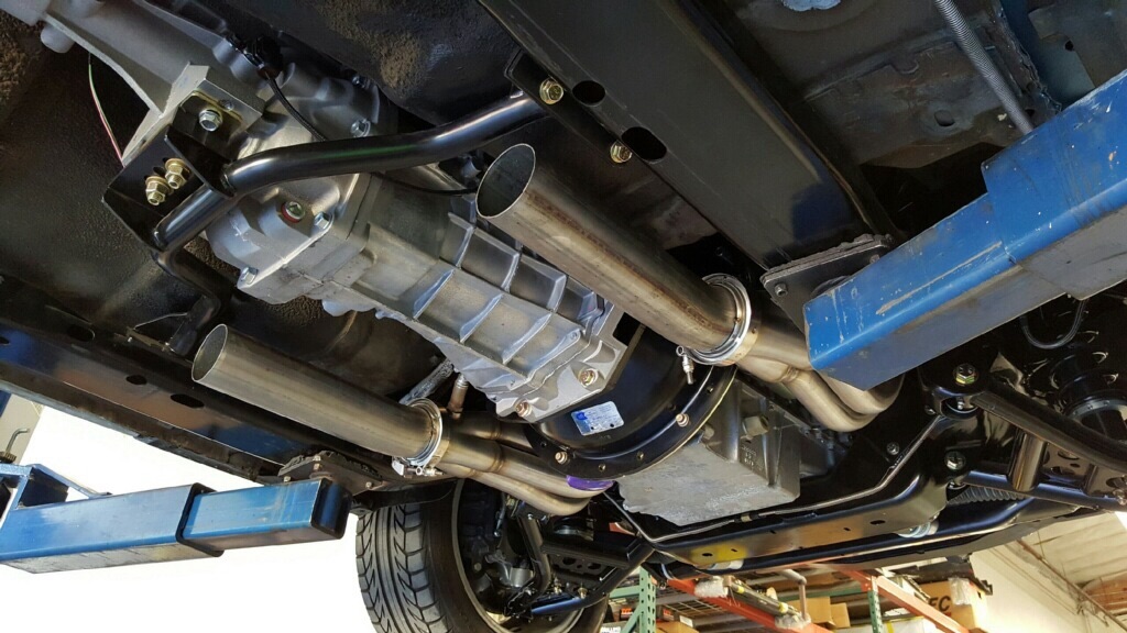

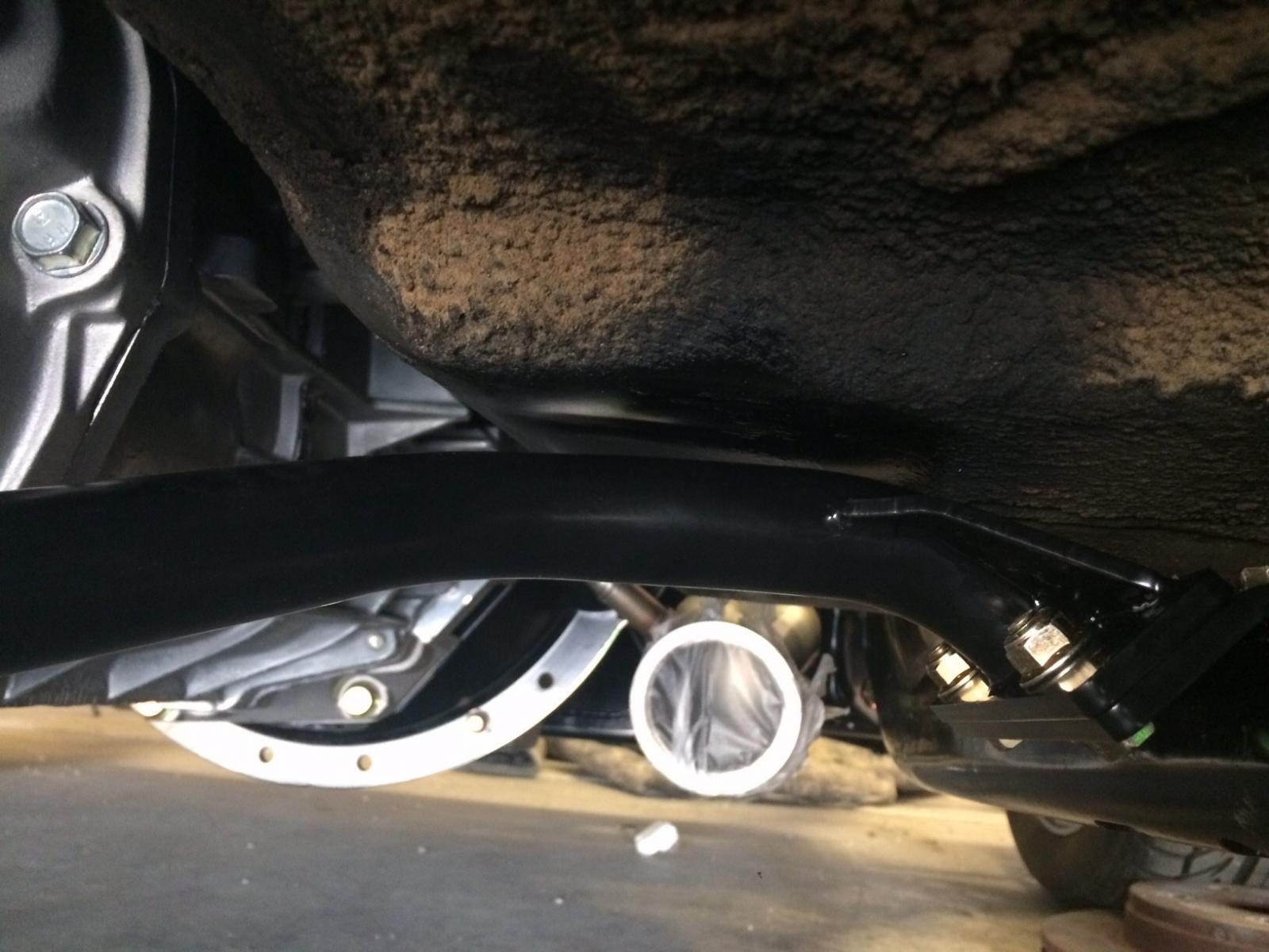

      Quote Originally Posted by badazz81z28 View Post
      Attachment 125615Attachment 125616I have Marks crossmember and DSE frame and all I cut was the hole for the shifter plus a few inches forward. Up near the front I just massaged the floor pan.
      I bought one of these cross members, but I'm not sure it fits. Did you have to massage the floor to the insides of the mounting points?

      Quote Originally Posted by Alponcho View Post
      No, it touches the floor but no massaging. Are you using solid body bushings? If you're using rubber bushings, that could be your problem.
      I'm using solid, standard height body bushings. It seems like the bar is a good 1/2" too tall (maybe a bit more) in area where it traverses the floor. Did you have to wedge yours in place on one side and push up to make it work? Not sure I can do that in my situation. It looks like I'll have to cut the floor, or flat plane the top of the crossmember to make it fit.

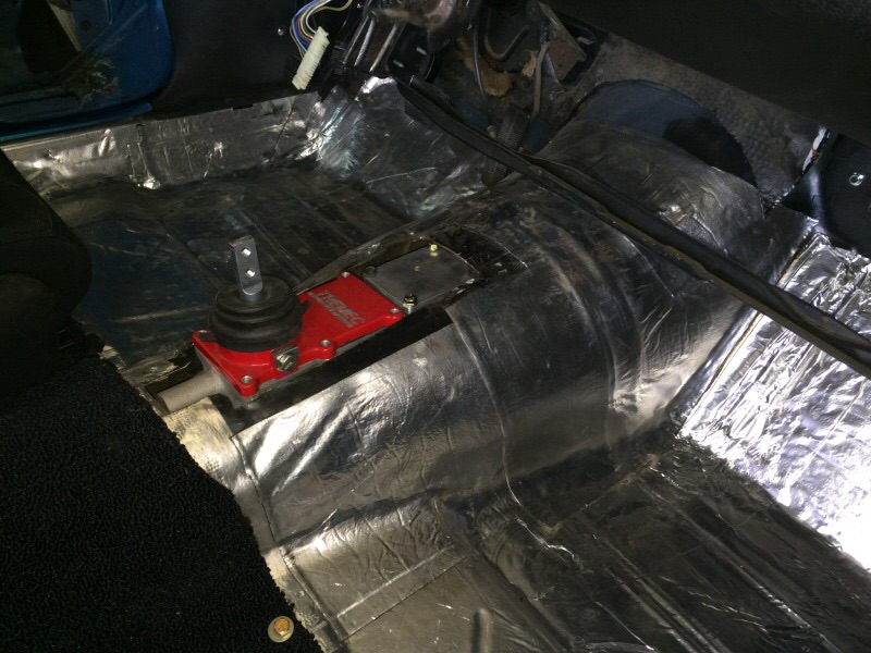

      I put the T-56 in my Trans Am with an IA2 535 motor. I run DSE 1/2 height mounts and a Quadra-link on the back. Here's a link to the build...
      http://www.lateral-g.net/forums/showthread.php4?t=51065
      I spoke with Stacy at DSE and she said that they mod the tunnel on all T-56 2nd gens. You can stuff it in there without doing so but your driveline angles will not be correct. You can see that I raised mine about 2" and then dropped it off right at the tail end of the transmission. I cut out the tunnel and got the drive angles right and then built the new tunnel to fit the correct alignment.
      And to get my crossmember in, I did have to massage the floor with a BFH. I put a 74 floor in the car since that was the only entire floorpan I could order.

      DSE raises the tunnel for a cleaner install. If you do what I did, the shifter sticks above the floor as you can see in my pics, if you fully cut you can make it above and more smooth. My trans angle downward is the same as DSEs car

      Spoke with Craig who sold me the crossmember. He said they were designed to fit a 3" exhaust so they would be tight. Anyways, not sure I can get enough clearance using a hammer on the floor. Might have to cut the floor. I guess another option would be to slice the crossmember along the top and then top plate it.
    17. #37
      Jun 2010
      Deployed
      3,377
      It is snug, but it will fit. Slide it in from the back some, not angle it up there like in your pic. Also Try installing just the crossmember and then lift the trans and slide the trans mount in.

      Jul 2013
      N. Scottsdale
      422
      Turned out that we needed more room in the tunnel after all. Ended up adjusting the floor with a wooden block and a floor jack. Plenty of room now. Crossmember fit right in after that. Nice piece.
