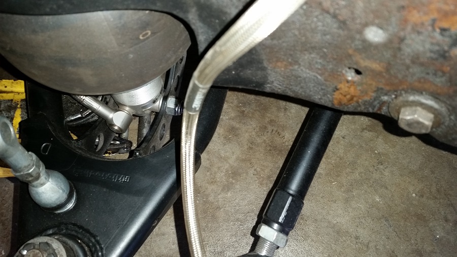

      I realize this has been beat to death but I'm opening my own thread giving my real world experience thus far with the ridetech Tru Turn system. I'm copying and pasting this from another members thread. There have been more than a few people with fitment issues in the wheel house. I have worked around this with inner wheel house mods. We already knew this would be necessary. The issues I am having now are with a huge loss in turning radius and tire/wheel too far back in wheel opening with the UCA's/LCA's that ridetech provided at their built in +3.8 caster angle...and with added shims to give me more + caster.
      Now that I have the car on the road....clearly some of issues that glr0212, cwylie, and others are having, I am having as well. The car is now fairly useless in parking lot conditions.
      My set up:
      69 Camaro
      Full height frame bushings
      Frame specs good. Checked on frame machine. Son works for body shop.
      Full Ridetech suspension....Muscle Bar, TQ Air springs, Tru turn, everything
      Tobins rotors/hub from Kore 3
      18X9.5 wheels with 5.75" bs up front
      275/35/18's
      Caster +5 Camber -1.5 Toe in: 1/16"
      Delphi 670 box
      67 Camaro 5.8" pitman/idler
      I worked around the clearance issues on the inner wheel house but clearly either I was shipped the wrong control arms or this system pushes the wheel way back in the wheel opening which in my opinion looks stupid. I was already concerned about the clearance (side to side) issue prior to ordering wheels so I went with a 9.5 and an 5.75" offset that would give me a 1/4" of clearance on both sides of center with the narrower wheel.
      I also am running into an issue with hitting the Muscle bar, either direction at full lock. Actually, I don't imagine I am even close to full lock. And, the steering stops are on the wrong side of the LCA for Ridetechs steering arms. After a call into their tech group, I was told that I must use factory Camaro steering arm to utilize the built in steering stops. I would have to fabricate my own stops. Irregardless, if I do add the stops to prevent hitting the Muscle bar, I will loose a huge amount off turning radius with this system. The other issue, the rear of the front tire does rub the inner wheel house on occasions while turning, leaving rubber. Eventually this will wear through.
      While this system may be great for the guy that enjoys an occasional auto cross, it is nearly useless as it stands on my car for every day driving unless I maintain a straight line...and I don't live in Kansas. Lol. I have to make at least two stabs at entering any parking spots. I don't imagine the Auto Cross I wanted to compete in at Springfield in May will even be an option now. Those tight parking lot turns wont allow it. For what we spent on this system...well, I'm at a loss of words. Lol.
      As my system stands:
      You will lose turning radius with this system!
      You will have to modify your wheel house for clearance with 275's....but we already know that.
      And at almost 8 grand into this system, I have earned the right to complain! I am literally so frustrated at this point, that I about to gut this stuff and start over.
      Provided pictures are of the drivers side onlyName:  20151224_104925b.jpg
Size:  171.9 KBName:  20151224_103303b.jpg
Size:  114.1 KBName:  20151224_103405b.jpg
Size:  173.9 KBName:  20151224_103913b.jpg

      I have no problem notching my frame to get my turning radius....but where does that leave me with the sway bar and the tire rub I'm experiencing at the rear of the tires to the wheel house. I'd have to move the mounting point back and come up with a shorter sway bar arm for the Muscle bar in order to clear the wheel at full lock. What I feel needs to happen is the wheel/tire should be centered in wheel opening...moving wheel/tire up to an inch forward would probably clear the Muscle bar. I really think I have been shipped the wrong control arms. Ordered these through Matt at MCB. Hopefully he still has the original invoice. Not sure how to tell what was actually sent verses what the invoice says was sent. What a conundrum!

      Hmm...I thought (or maybe assumed) the Ridetch UCA/LCA's moved the lower ball joint forward to offset the effects of the increased caster...is that not the case? Did the part numbers for the arms match those in the instructions? Is it even possible to install the arms incorrectly left to right? Have you called the guys at ridetech?
      It's what I does.

      Quote Originally Posted by Apogee View Post
      Tobin,
      That's what I assumed, thought I flipped the sides but they are clearly marked with a D (drivers side) and P (passenger side). Yes, I called and spoke to a tech twice but I can't remember his name. I showed him the same pictures I posted of the driver side only earlier in this post.

      David Pozzi pointed out to me that there was a possible change in design some time around 2013 to correct the placement of the tire in the wheel opening. Still trying to get that confirmation. My package was delivered around that time frame and I may have been subject to their first run of products. Sucks to not have time to have thrown all of this together and actually drive it day after day to find the issues I am just now finding out. Hopefully ridetech will help me out. Come on Bret!

      After much digging. I'm fairly certain I got an early production run of this product.
      Ii have no problem trading your current lowers in for a set of the newest version lowers with the balljoint position moved slightly forward if thats what it takes. We routinely make revisions like this in the interest of continual improvement. These running changes (with any of our products) are not kept secret by any means, but are rarely significant enough to warrant any "official" media announcement. In reality, we had no need to move the lower balljoint forward until we started running upwards of 7 degrees of caster. When we started running that much caster we also started lightening up on the camber, now running about .5 neg. We run a 275-35/18 tire on a 18x10 wheel with a 5.75 backspace on the 48 Hour Camaro BUT, its on a 67 not a 69.

      Kyle, my issue is not a side to side clearance issue (other than hitting the Muscle bar). My issue was the tires being too far back in the wheel opening, often times touching the rear section of the wheel house. By moving the ball joint forward that will move the entire wheel forward as well, possibly giving me the clearance I will need to clear the Muscle Bar at full lock. Hopefully. Bret is helping me out. I should've been more assertive with my last call in to tech and asked for Bret himself. Wish I could remember who I spoke with. I normally write this stuff down.

      The new control arms corrected my issue. My wheels are now centered in the wheel opening and the tires just kiss the sway bar equal amounts....nothing I can't correct with the addition of stops. No where near the wheels now. Thanks ridetech!
