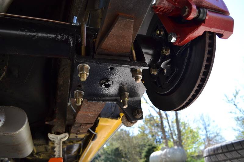

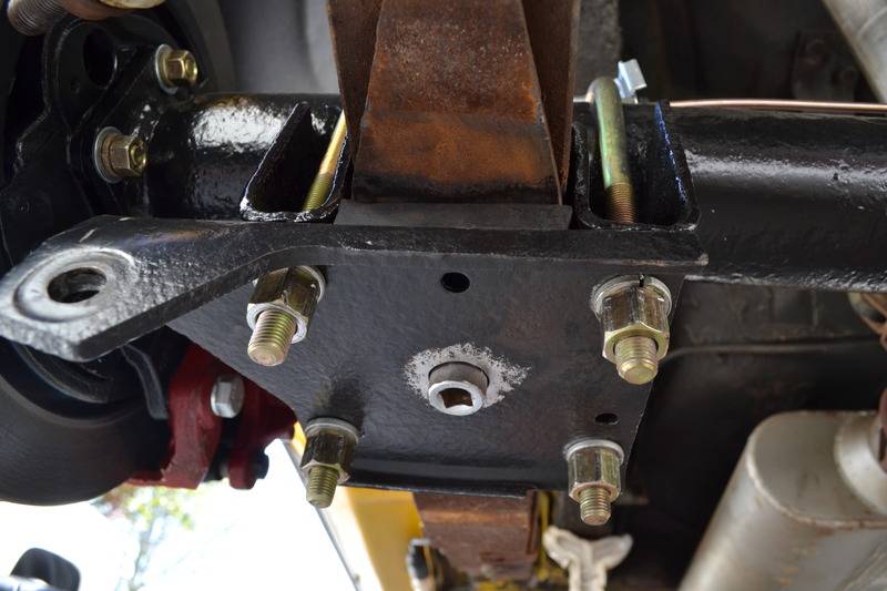

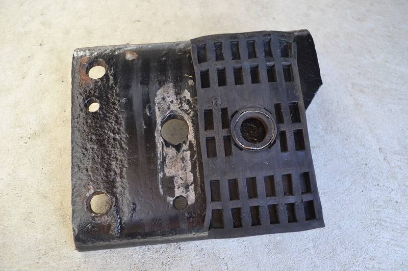

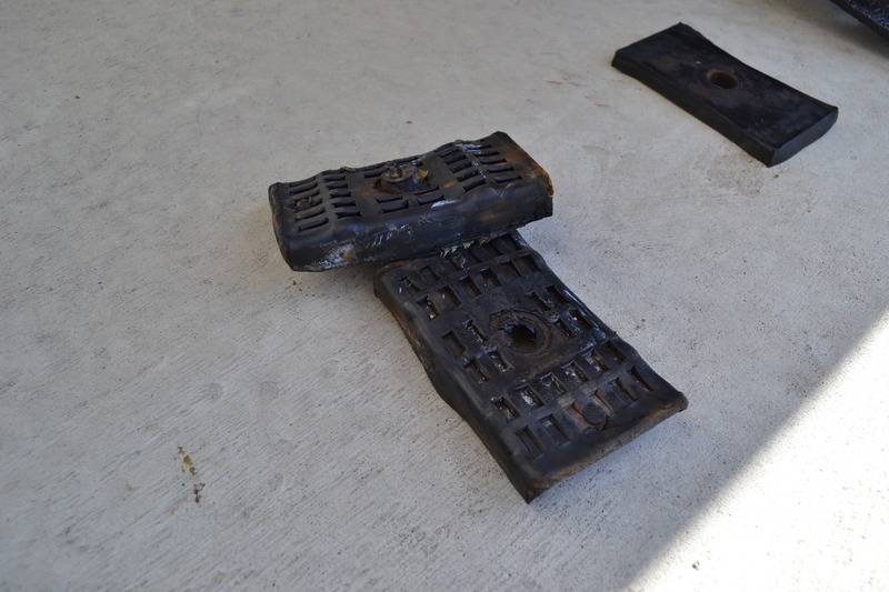

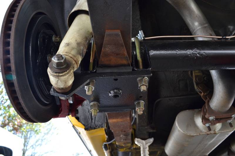

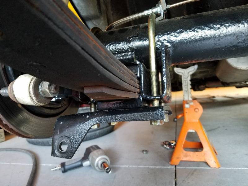

      The original pads didn't work out either, the rear end was still sliding around on the leaf springs. I just couldn't get enough squish to the pads to keep the rear end in place I guess, the shock plates were touching the leaf spring perches, so I couldn't tighten them any more...
      My dad had the idea to use some old sockets to center and keep the rear end from sliding, so I gave it a shot.
      You can see how much I would have had to open up the hole in the shock plate to fit these A/M pads....terrible.
      Originals all beat up now...
      Finished...
      And, probably shouldn't have drove much when the rear end was all jacked up like that...haha

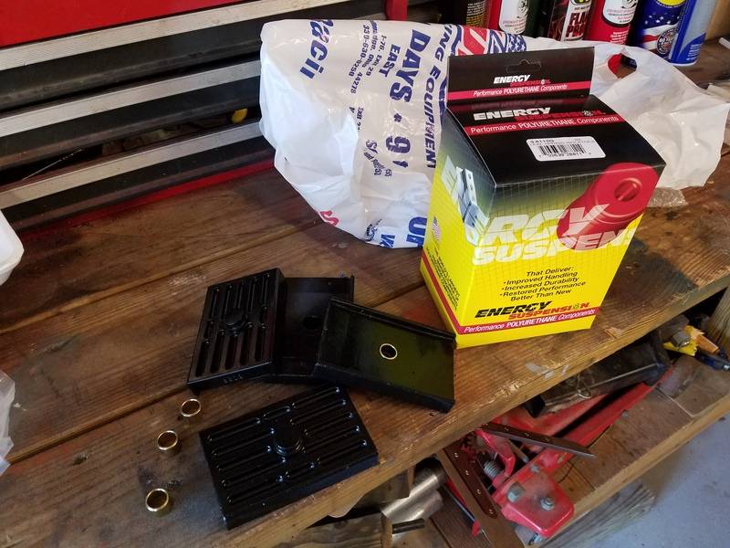

      - update -
      Been enjoying the car as much as I can! Finally was able to hit up my first cruise-in of the year. Up till then, I was mostly just driving it to work, and running errands in it.
      The vibration got worse though, to the point where I just parked the car until I could tackle the next thing on the list of possibilities....those pads.
      Ran to Summit and got some polyurethane ones...

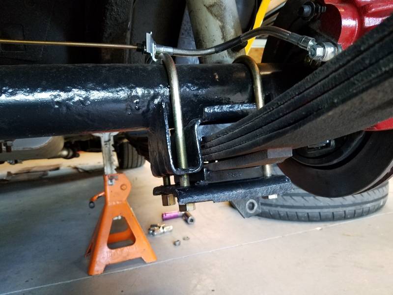

      Finally got a good "clamp", so hopefully the rear end doesn't move anymore. (I cut those sockets back out)

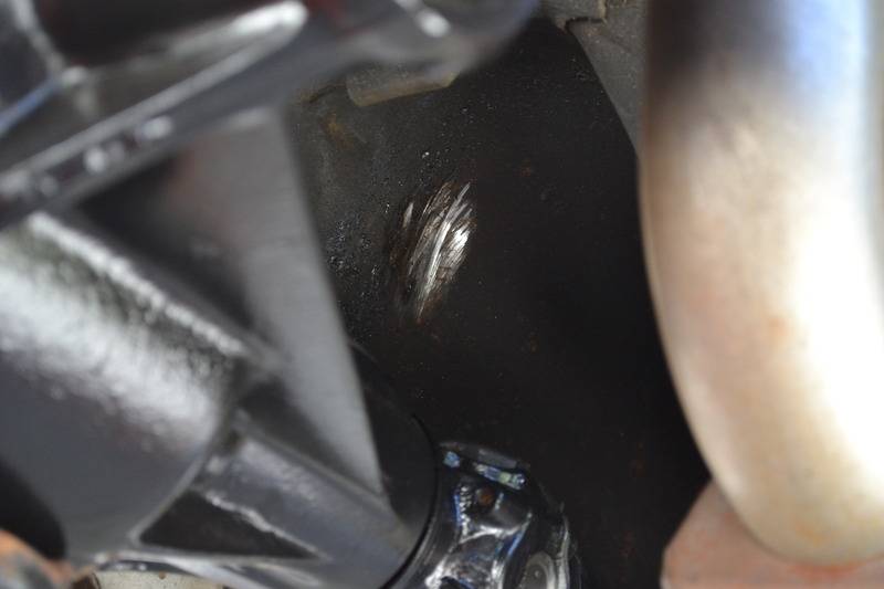

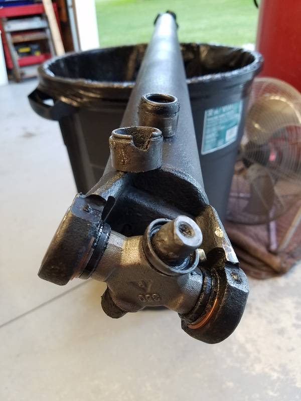

      Didn't help the vibration I've been chasing though, so on to the next item...pinion angle. Trying to research it, but there's a bunch of contradictory stuff. As of now, my angles aren't matching, the trans is pointed down a little over 3 degrees, and the rear end is pointed up a little over a degree and a half. Some say the angles need to match, but in order to do that, I'd need to tilt the rear end up even more than it is, and some say it needs to be pointed down as it is. Maybe tilt the trans up, by shimming the mount?
      My brand new conversion u-joint DID take quite a beating though, so I'm sure that didn't help the issue. I figure this happened when I drove with the rear end out of whack for those few miles, then the vibration all this time did it in...

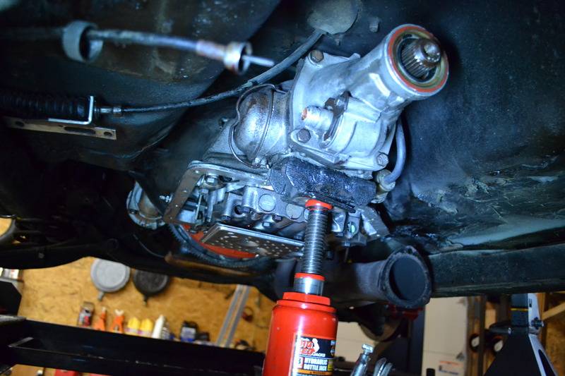

      Did you also change your trans. mount pad ? if still the same from your page 2, should be big part of your vibration issue. This one is worn out...

      It very well could be. I didn't change anything when doing the trans swap, whatever it came with is what I used, I just bolted it in and went.
      I didn't have this vibration last year though, but maybe the new rear end is pitched differently than the BOP 10 bolt. I'm going to replace that u-joint this morning, and throw some shims at the mount to get the angle measurements a little closer to matching, see what that does.

      Shimming that trans seems to have done the trick! That, and a new u-joint, and the vibration is gone. It MAY have a little shimmy when taking off, but I can't say for sure. It IS a 48 year old car with all original suspension, so I'm not holding my standards too high. haha

      Not sure how I feel about having all those shims under the trans mount like that though, so if I ever have to mess with that rear end again, I think I'll buy the shims and do it from back there.

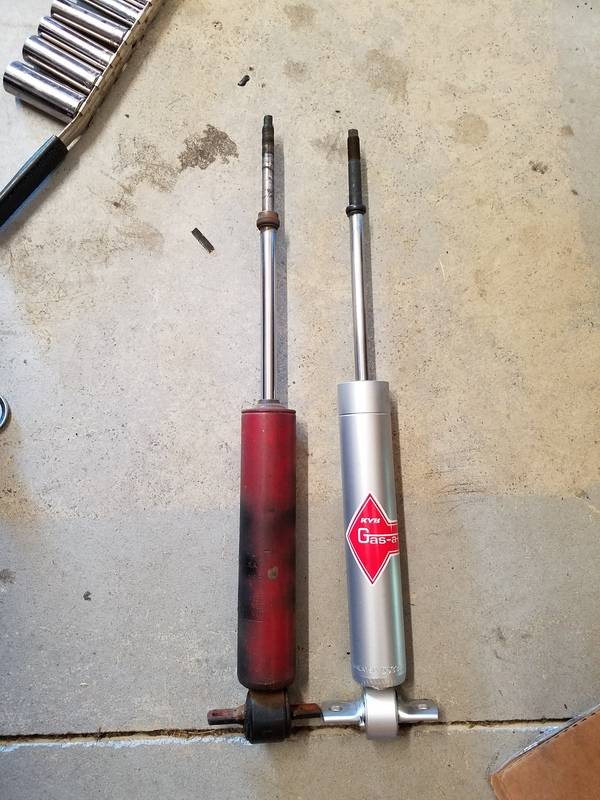

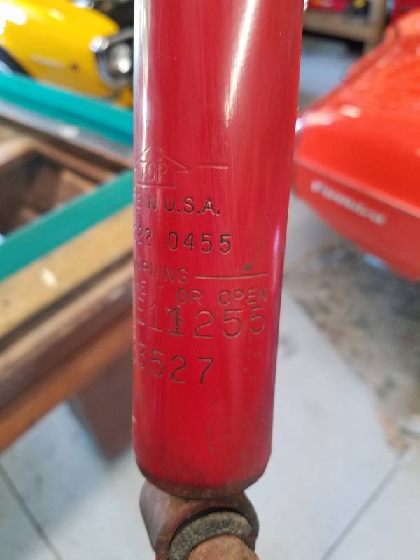

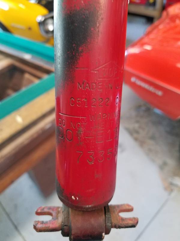

      I've been enjoying the car all season long, and one glaring issue that needed attended to, was the shock situation. My tires rub in the front quite frequently over large dips in the road, and sometimes when cornering hard.
      I'm not positive, but are these original shocks??
      Either way...they were worn, and needed to be replaced. Having big plans for the suspension eventually, I didn't want to spend a whole lot of money on shocks now, only to replace them in a few years. So, I went with some $32 KYB's.
      Still not as stiff as I'd like, but I wasn't expecting coil-over performance from a $32 shock. They DID improve the steering and handling feel quite a bit, and it doesn't rub on certain places that I drive. Still can't escape rubbing on the big dips in the road though, but it is what it is....

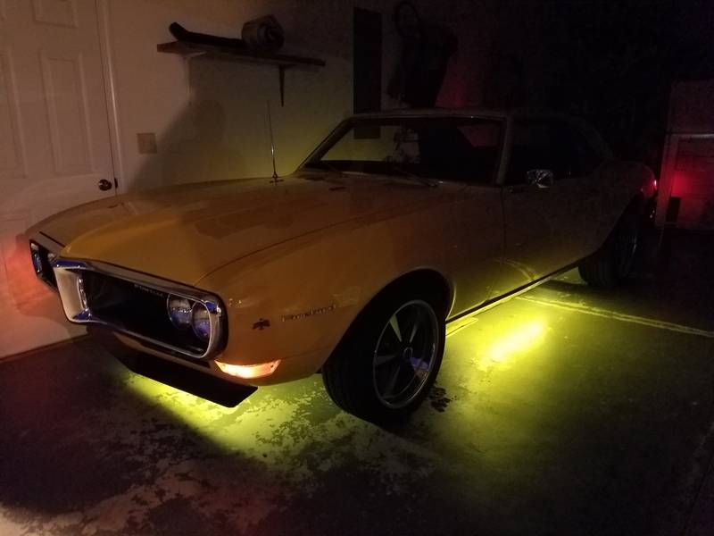

      Oh, and I keep forgetting to show you guys....
      What do you think? Should I leave the yellow Street Glow neons on the car?? hahahaha

    13. #53

      Fast & Furious light style ... yeah back in 2001 ... Sweet ride !

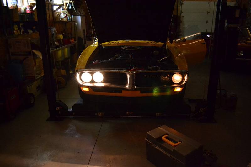

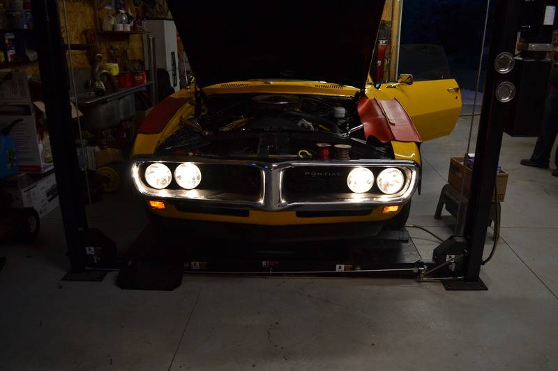

      I did finally get some halogen headlights though, driving the car at night has been a death wish!! I wanted to get some cool HID's or LED's off eBay or something, but it's hard to trust that cheap, Chinese crap, so I just got some Wagners from NAPA. Can't wait to see how they do on the road!
      I'm told these old T-3's can go for a decent amount of money too? The driver side high beam was out, and I'm not sure why the driver side low beam was so dim like that, but the passenger side high beam is fine.
