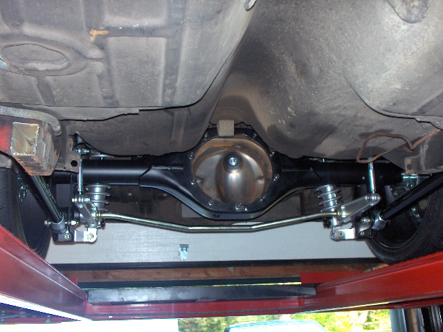

      Just for clarification, I consider the "pumpkin" to be the removable gear assembly sometimes also called the third member which is bolted into the rear end center housing. There is only one 9" style pumpkin mount regardless of who makes the rear end housing. There are different looking 9" housings but all 9" housings have the exact same mount for the pumpkin. As for the upper mount bracket locations, if they are installed correctly they are no where near the pumpkin but may be welded to the center housing rather than the axle tube. Here is a pic from early in my build showing the rear end housing shortly after it was installed. I just noticed that that the top pic really doesn't show the upper mount brackets but the second one does. In any case the upper mounts are nowhere near the pumpkin but are welded to the center housing.

      What I was referring to was that the mount was not on the tube like it would be on a 12 bolt. What I was wandering is if the mount being higher if that effects the geometry at all. Or did you remove material from the mount so that height was the same as the right side. I hope that was more clear.

      Actually Steve, you pictured exactly what I was talking about- thanks for showing those pics. One ear is half on the axle tube and half on the bulged portion of the center section, and the other is mounted entirely on the bulged section on the other side. Is this how others are mounting the tabs as well? Steve- did you have to modify the ears in any way so they all sit at the same height? And there are lots of different styles, what i meant by this is the fab styles that are out there. Also, that does not look like a ridetech 4 link. It might not matter since they similar, but since thats what I have it'd be best to reference those installs.

      OK now I understand. If you look close at the pic, yes the driver side upper mount bracket is physically shorter, BUT both upper mounts are located exactly the same distance from the axle's horizontal center line to the center line of the link bolts and the same distance from each axle end. What is offset in the pic is the center housing which is necessary due to the design of the ring and pinion gears in the pumpkin. In fact, the G-Link kit is supplied with a welding jig which bolts to the 9" pumpkin mount bolts and locates the upper brackets in the exact position they need to be. With the jig bolted to the housing and the brackets bolted to the jig it is then a simple matter to trim both brackets until they fit the housing properly for welding into place. My 4 link is a Chassisworks G-Link but it is my understanding that the ridetech is very similar in design and I have to assume ridetech also provides a welding jig for locating their upper brackets. Don't over think this and don't measure anything from the center housing. The center housing is just a cosmetic thing and most people don't even realize that all rear end housings have an offset center section. What is critical is the location of the link bars relative to the axle center line and each end.
