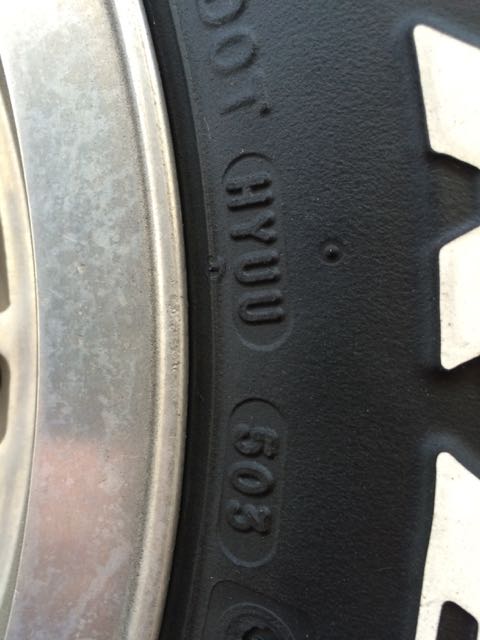

      They came with my '75 /'78 TA when I got it a year ago. They seem fine although I haven't really pushed the car e.g. drag racing or autocross. I have a fully upgraded to the max suspension (except for large brakes) and they seem to handle and grip pretty well. I don't think these tires are made anymore. I have actually been trying to find someone who can tell me exactly when mine were made because the DOT date code on them is 503. All my research says that these are before year 2000 and maybe even the 1980s but they look almost new. Are there any tire pros out there who can help?

      Shoot the full DOT number. Looks like you have the middle numberof the DOT.
      The date code looks like it had screws or rivets holding the date code on the mold and a 4 digit code. Any tire made before 2000 will be 3 digit. I dont believe the Indy was made before 2000 But Ill need to check.
      They date them by week number and year.

      If you pan down in the second pic you most likely see the actual date code.
      Ill try to get a good pic of a DOT date code and post it up.

      Here is the entire DOT line DOT HYUU 503 The 503 is surrounded by a raised "oval" so I don't think it's incomplete. On one of the tires, there is a small 1/8" chip out of the raised white "Firestone" and another small "chip" out of the sidewall right next to it. Hope this clears it up for anyone who really knows this stuff (far better than me)

      A Firestone guy climbed under with a light, the whole number was on the back side (non raised white letter side) told me they're from 2004. Guess they sat a long time before they were put on this car to sell it to me.

      Fwiw the tire linked in post one are entirely different than those really old ones in post two. Those need to be replaced. And nearly every post in this thread is about those old ass tire, not the OPs tires. Also firestone has used the indy moniker on many different tire, like goodyear uses the term eagle.
