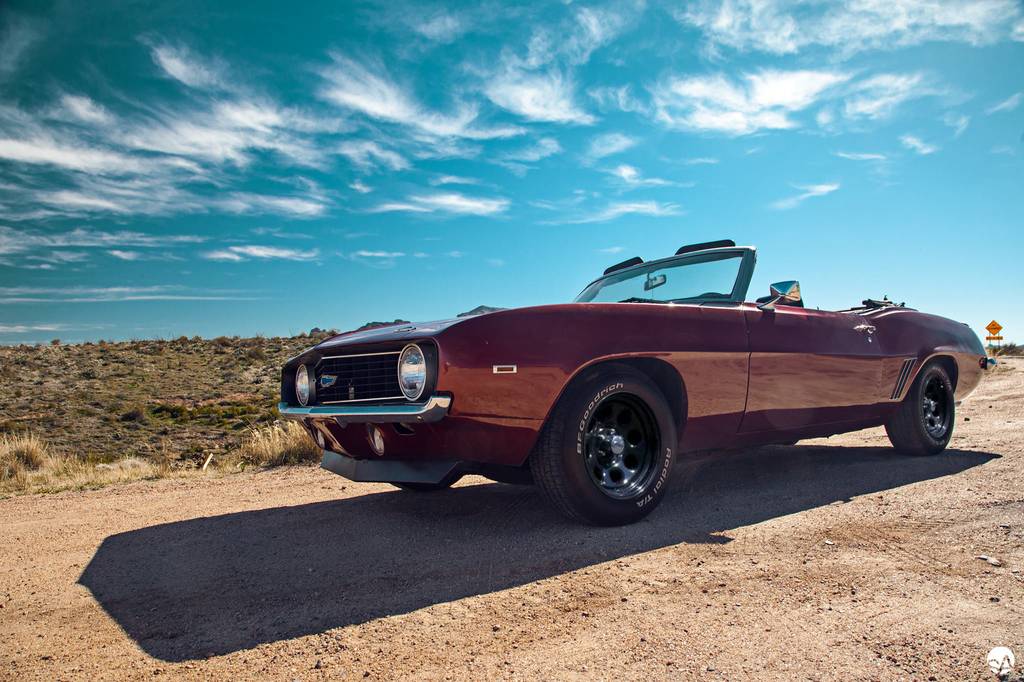

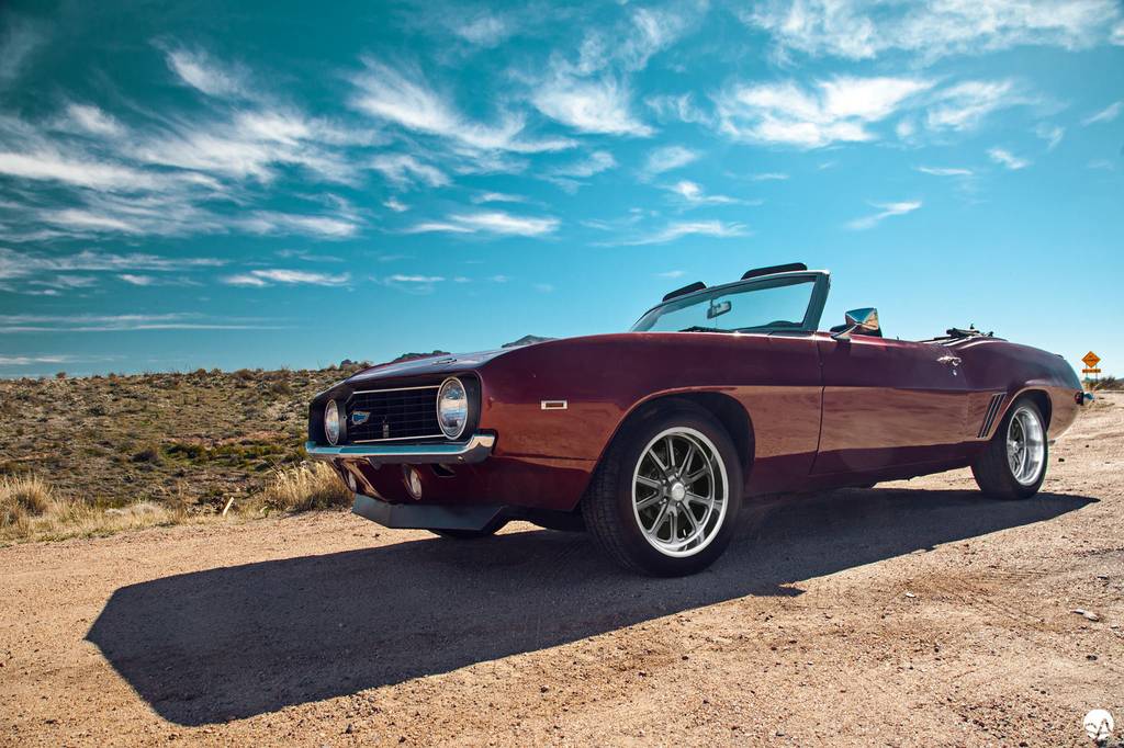

      A couple quick photoshops.
      Original:
      US Mag Rambler 111's:
      8 hole 15" (Cragar soft 8 style):
      8 hole in a 17" or 18":
      Feb 2016
      4
      Damn thats really cool thanks for doing that really helps me get a perspective on the look!
