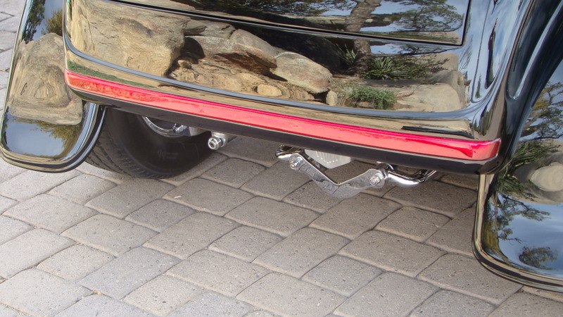

      This is what I did with my all steel 32 ford coupe, we made a custom metal box and inserted into the body. Made a wood plug made out of oak and shaped it to the contour of the body leaving a 1/8 gap top and bottom in order for the lens to be pulled over the wood buck. I then took it to a sign shop in Phoenix picked out a color of lens that I liked. They then heated the lens to form over the buck. I had to buy a full 4 X 8 sheet of plastic which made a total of three taillights. Broke the first one trimming the corners. Second ones in the coupe and still have a back up. I would say visit your local Commercial Sign shop.
