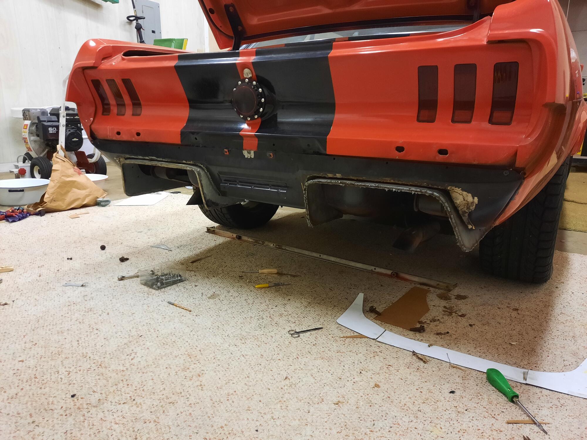

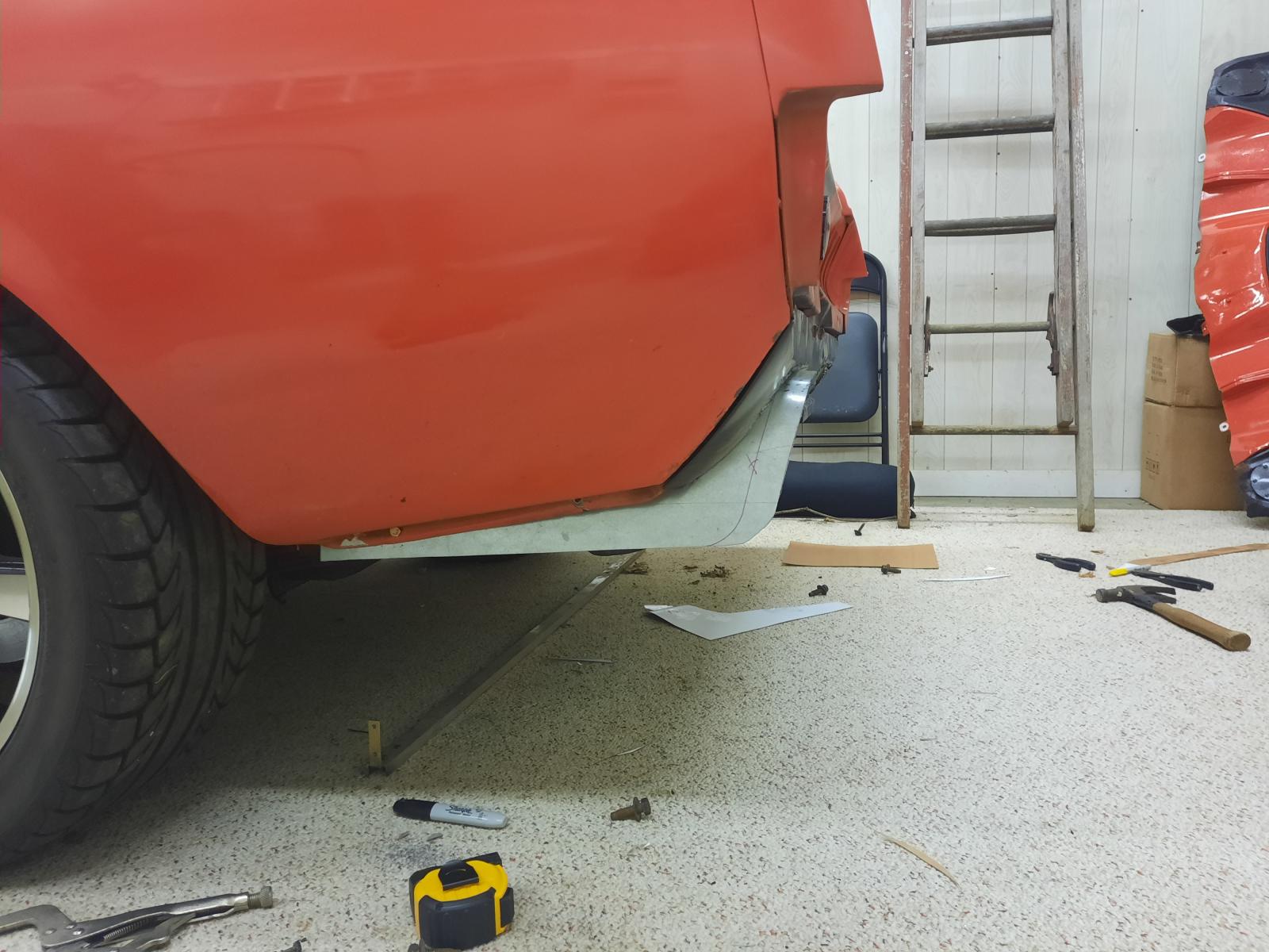

      Just an update; my other rear valance got me by, I was trying to achieve a certain look with it but feel like I never nailed it. It didn't help that it broke when I was taking it off to make the adjustments I wanted. It was uneven and kinda sagging. It broke and kinda just fell apart. So more reason to get this valance right. My plan is to get the one side done first and then copy it on the other side. The templates are all made out of cardboard so I can just use the same ones for the reverse.
    4. #144
      Nov 2015
      121

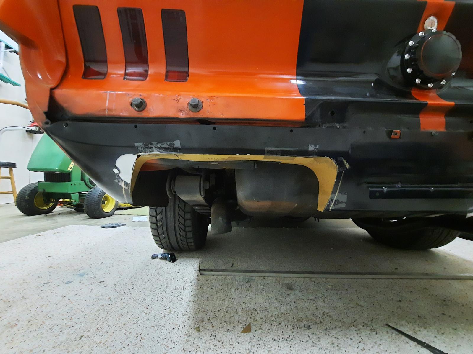

      This is the progress made on the rear valance. As you can see the cardboard is going to represent a piece of metal that will slope downward underneath the gas tank. The exhaust is currently underneath the cardboard piece. I am going to cut the exhaust and make it so it will come the cardboard piece. Use that as a template and then cut it and weld it to the existing valance. Then unfortunately I will only be halfway done.

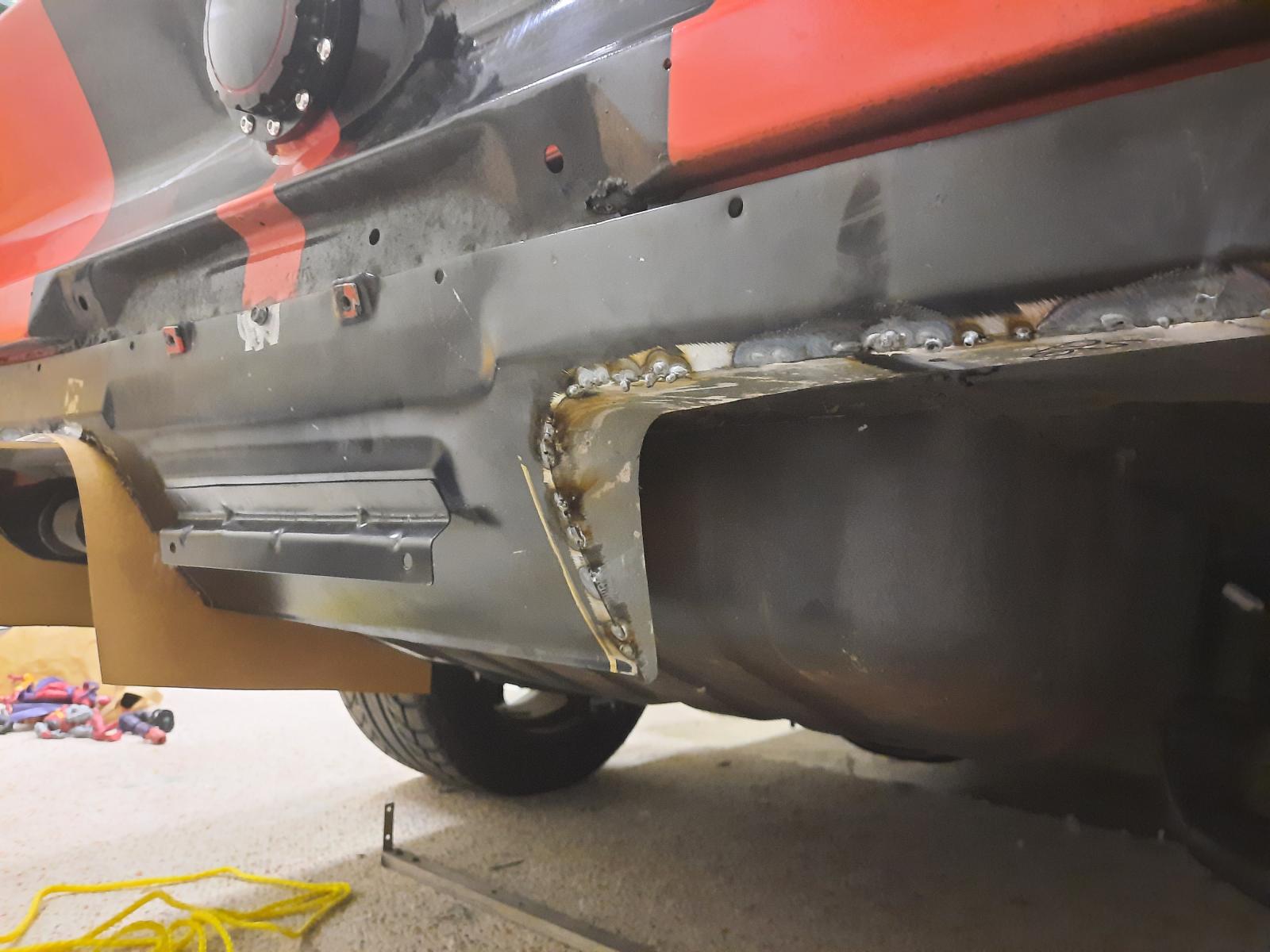

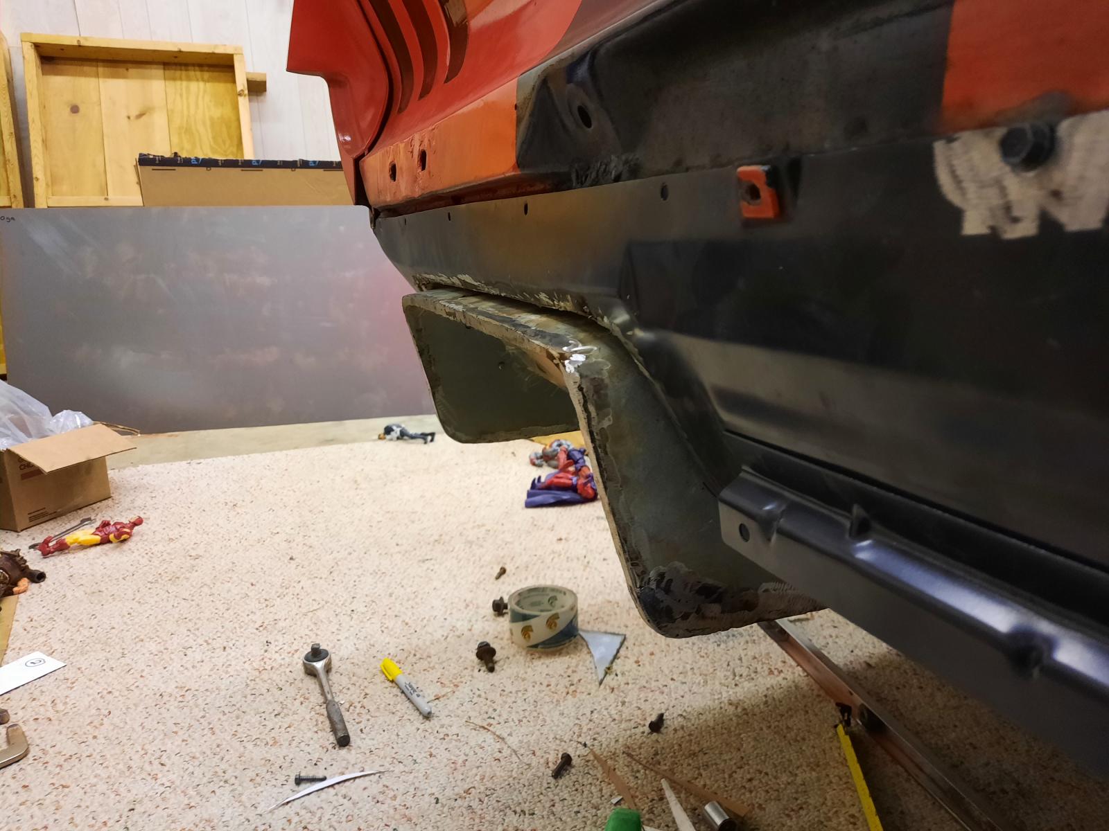

      This is the progress on the rear valance. I finished the passenger side, and then created a panel (based off the cardboard template above) to more closely replicate a diffuser. The exhaust hangs below the diffuser as of now, but I am going to cut a hole in the panel and make it so the exhaust is flush with the panels. I think I will also make a little fin on each side, not totally sure how big I will make it though. Then I have to make a spot for the rear back up light. It's the same light from my previous valance. I will have to make another template for it to fit. The problem I am having is how close to the gas tank it will be, so for it to be flush I will have to build a housing for it. The light will go in the middle underneath the license plate.

      Please do not take this as criticism, I like the look a lot, but is the front side of the middle rounded bits that hides the fuel tank open? it seems to me this could act like sealed scoop, and trap air under the car. I remember Honda's having problems with this back in the early 2000's that's why you always see large holes in the back bumpers. This would probably not be an issue until you were going 100mph+ and even then would only cause resistance. love the car though, you have come a long way in a short time.
