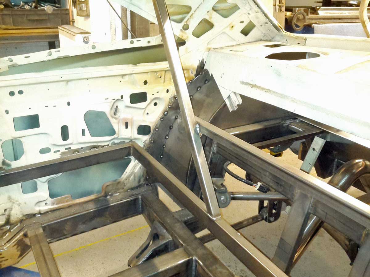

      Very cool project !! Love all the fab work your doing !!
    3. #23
      McKinney, TX
      1,623
      Nice fab work! This is going to be very nice

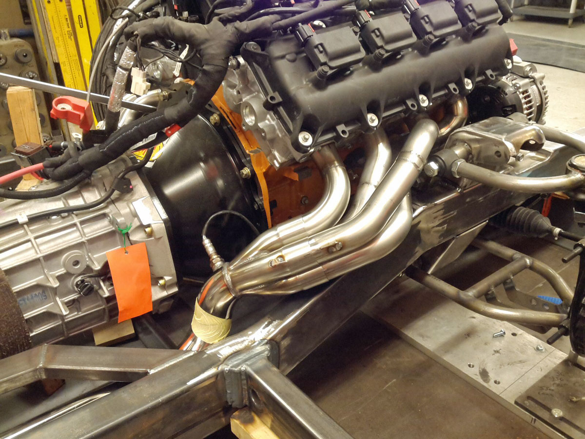

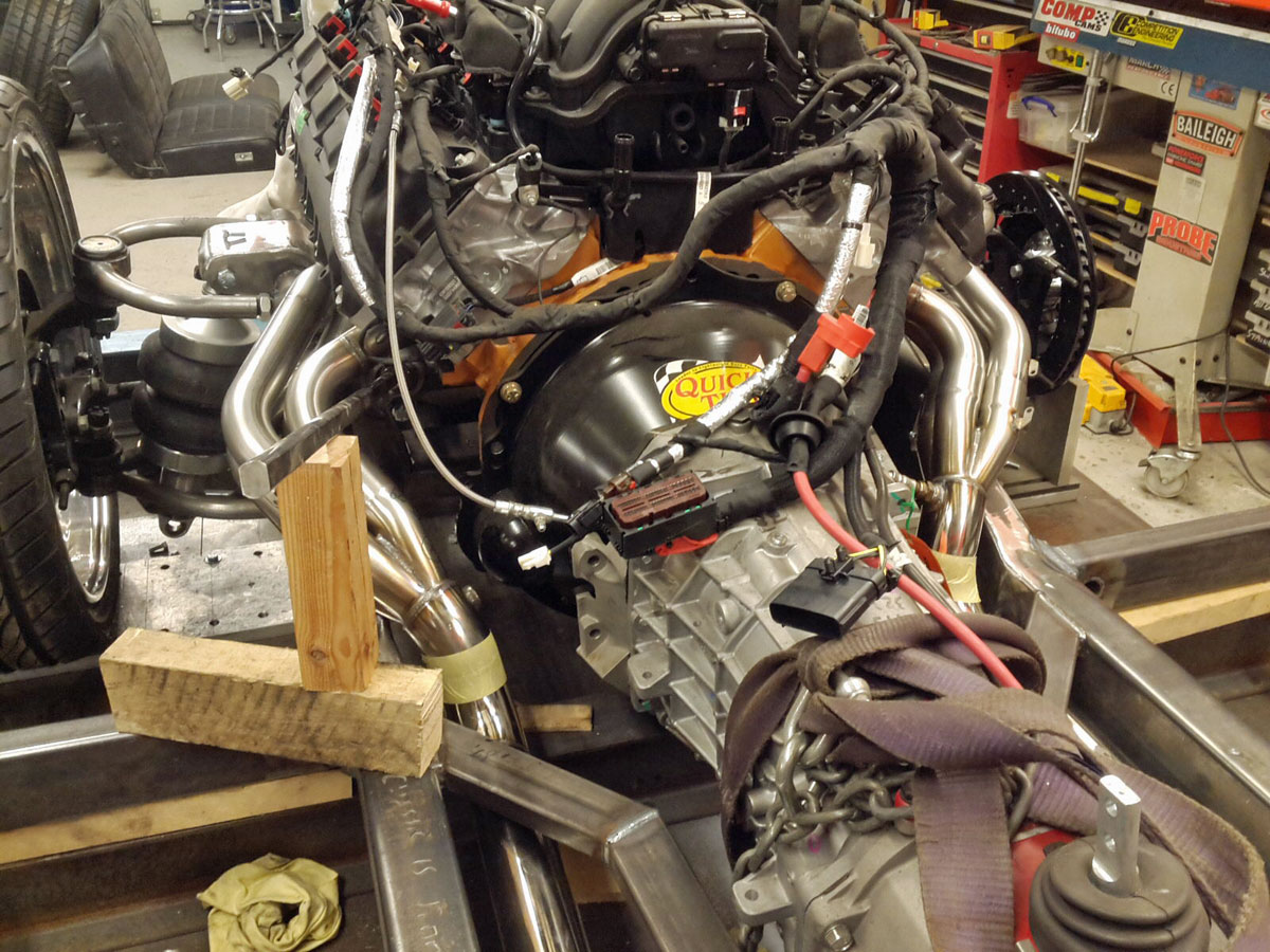

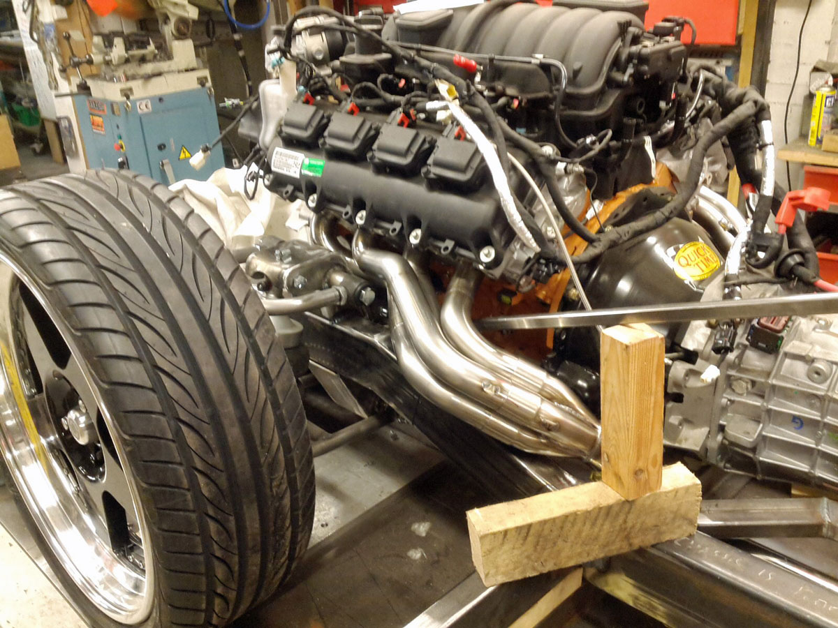

      made some headers

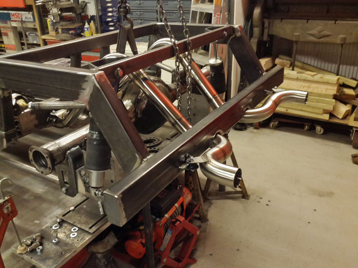

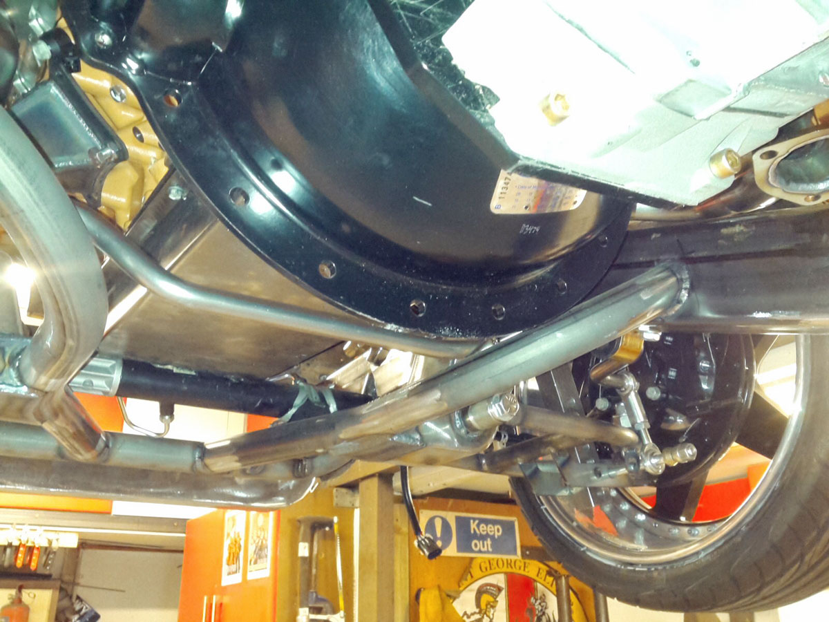

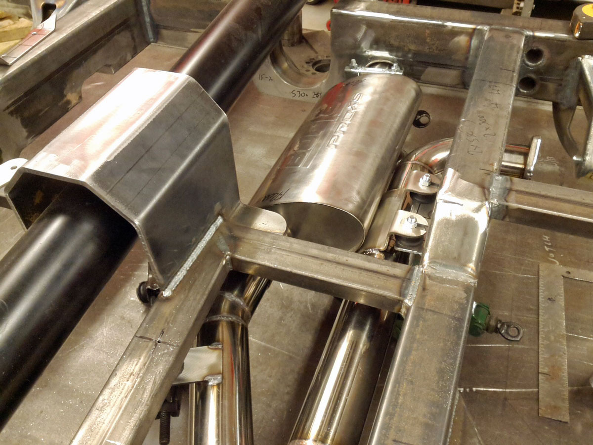

      and the exhaust

      any moper guru,s reading this.we have hit a snag with the engine and box.
      engines a gen 3 6.4 hemi.
      gearbox is a tremec six speed with a Lakewood(quicktime) bellhousing.we cant find out what starter motor fits.the company who supplied the engine,supplied a starter that didn't fit.we think it was for an original bell housing.
      the company who sold us the gearbox and bell housing didn't really know what starer to use but gave us a link to one that should.
      it didn't
      weve tried getting in contact with Lakewood but they have no contact details as they are part of the holley group.
      we,ve phoned the holley tech helpline,only to be told someone would contact us back.they never do.
      anyone help.ive nearly finished this car and still we don't know what we need.its a pain as we have to ship from the states,and it gets expensive buying parts by guessing

      Might be worth using the Qa1 extended length ball joints(1 inch) to allow for a better angle on your upper A-Arm and allowing for the top of the tire to toe in that out. Did this with my Spindles in the top position. Makes quite a difference. Parallel arms are not so great with the shortness of the upper arm.
      Great build. Ill PM when I fly over next! I haul parts back and forth all the time. Friends/Family in Lincolnshire!

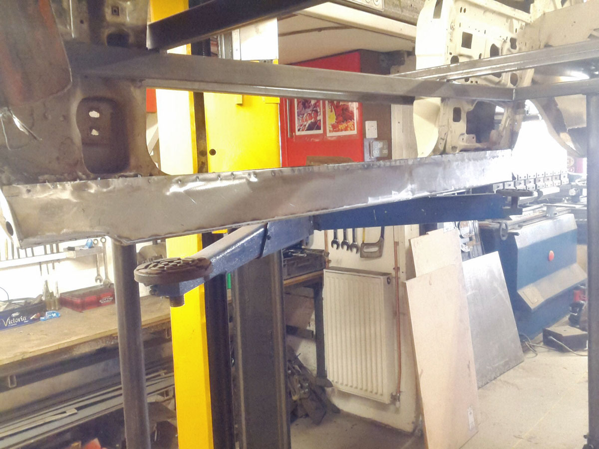

      some more of the build

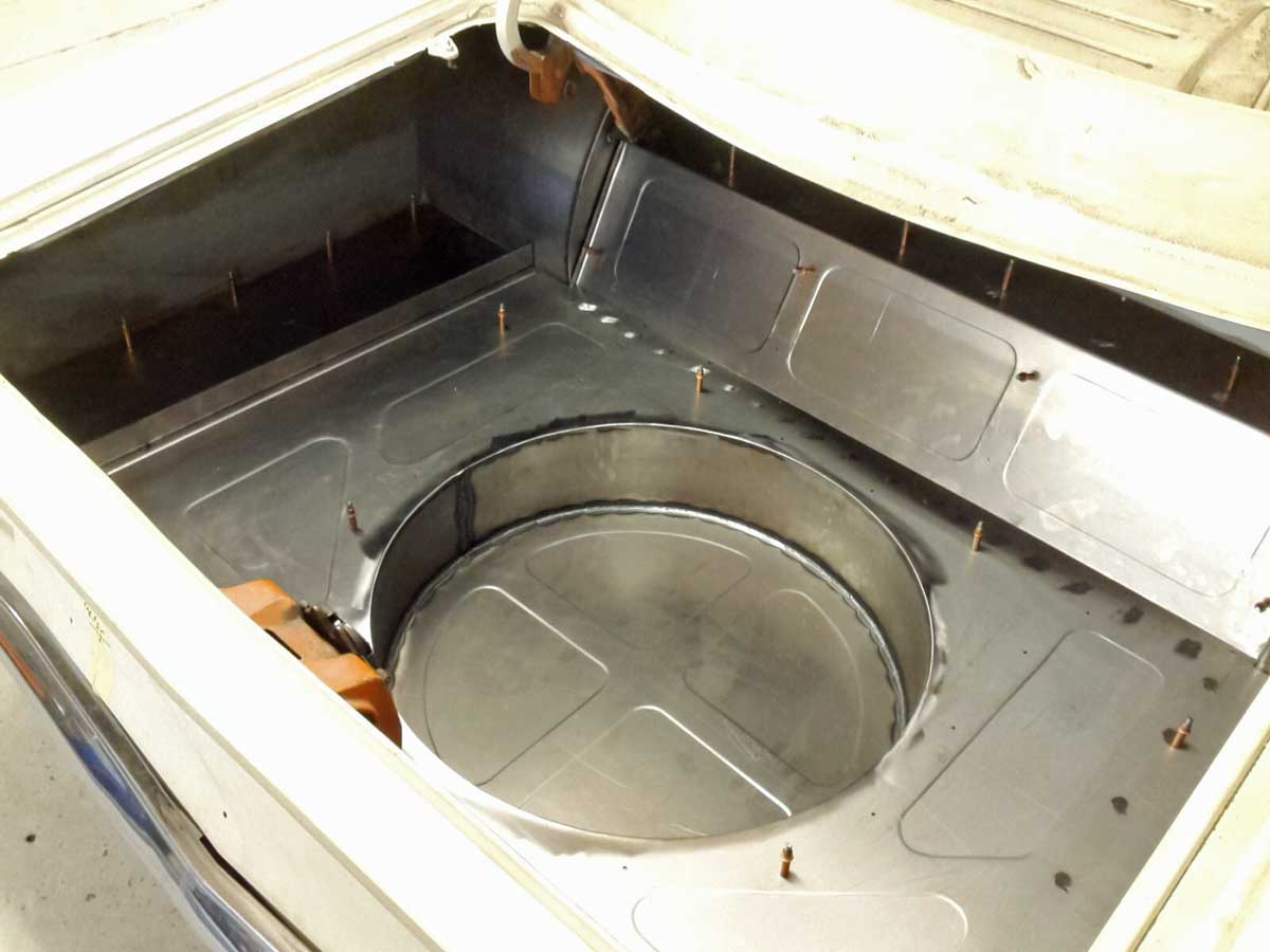

      cut the old floor pan out

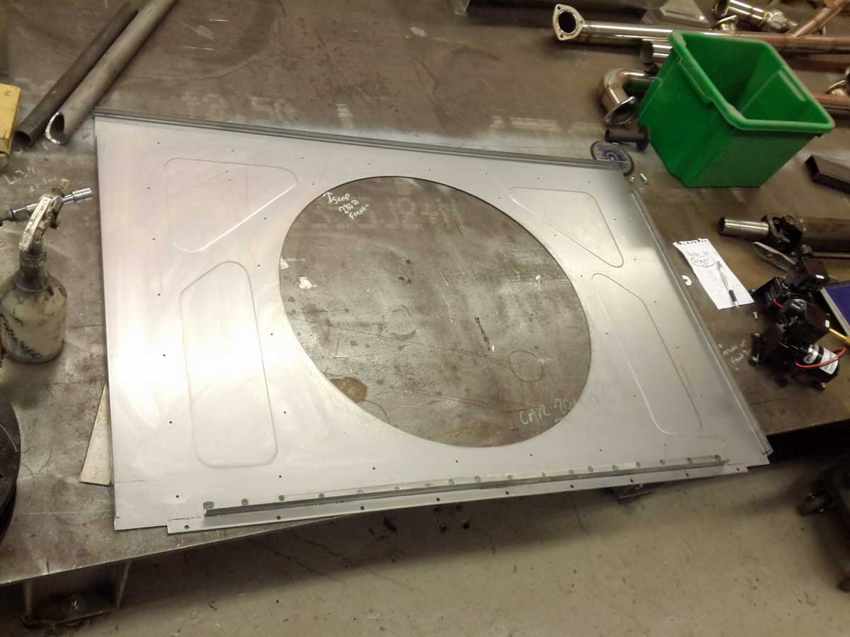

      and made some smooth covers for the inner seal area

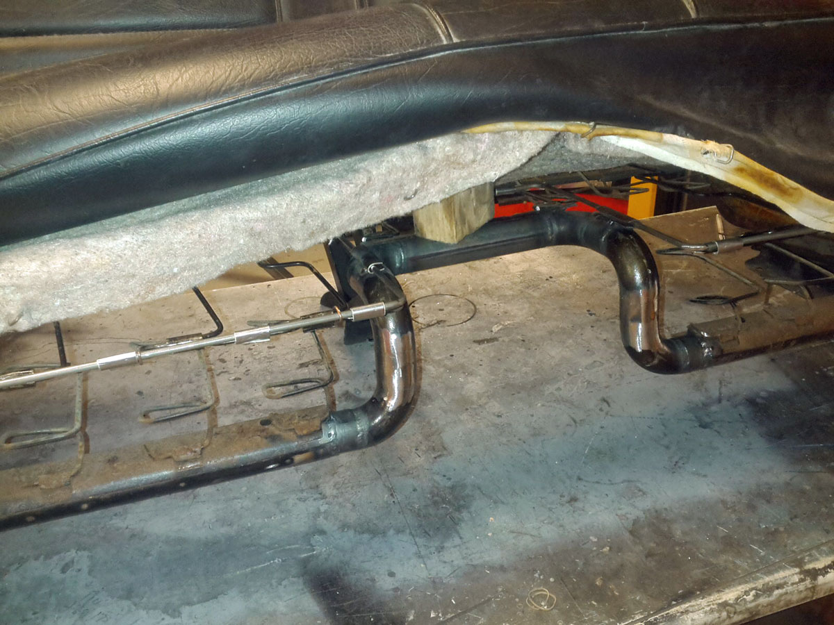

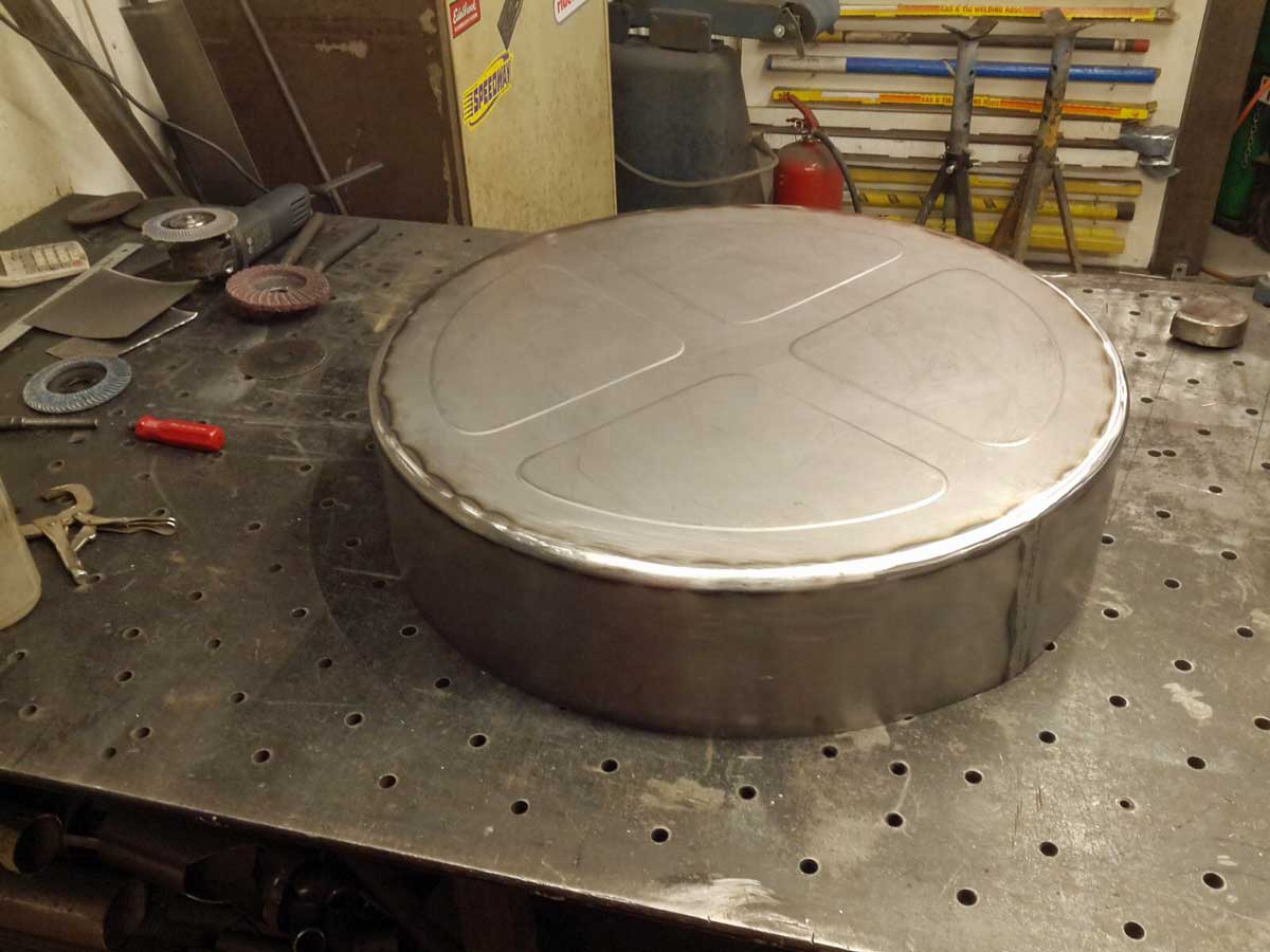

      also did a small mod on the bench seat

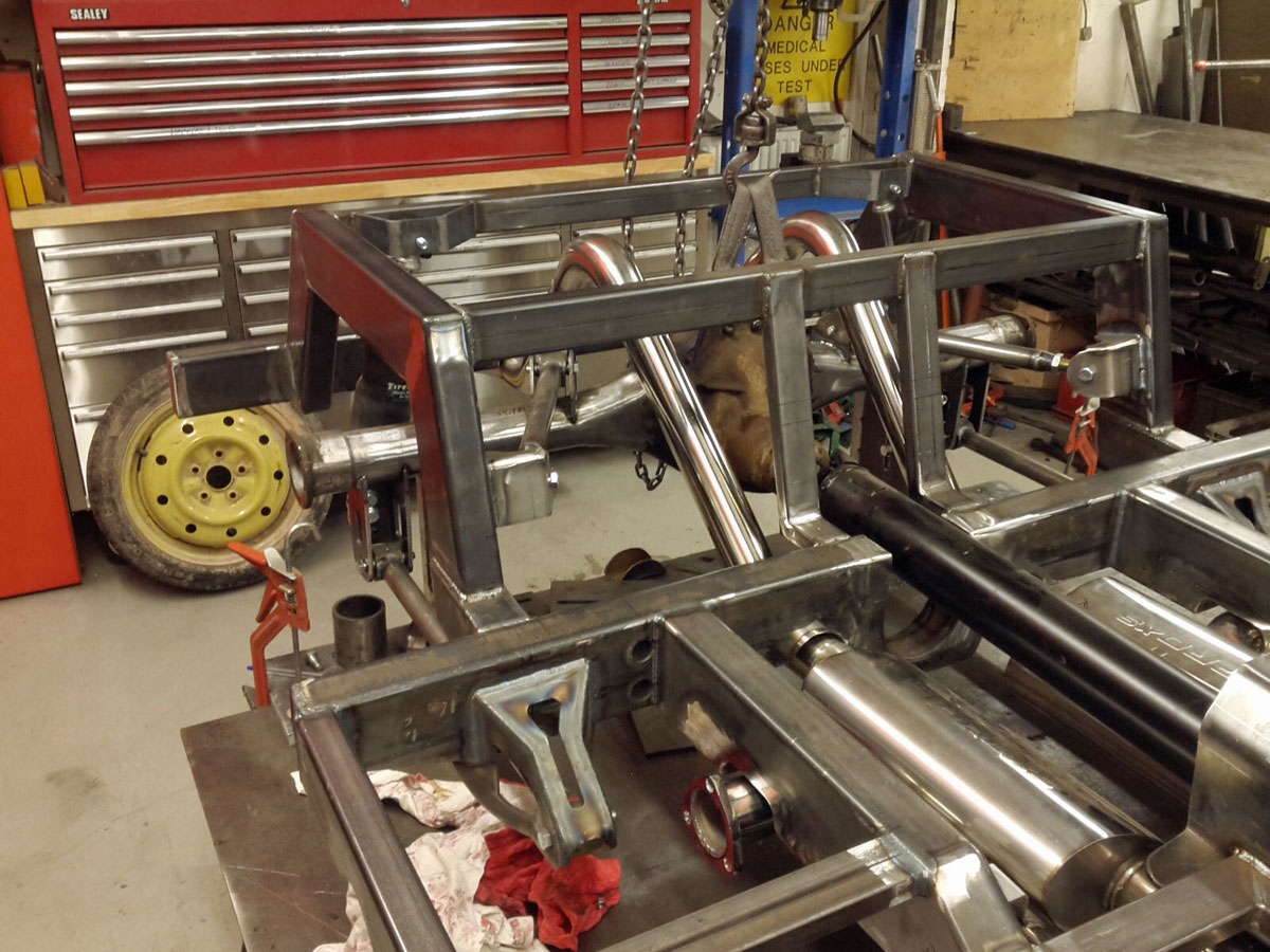

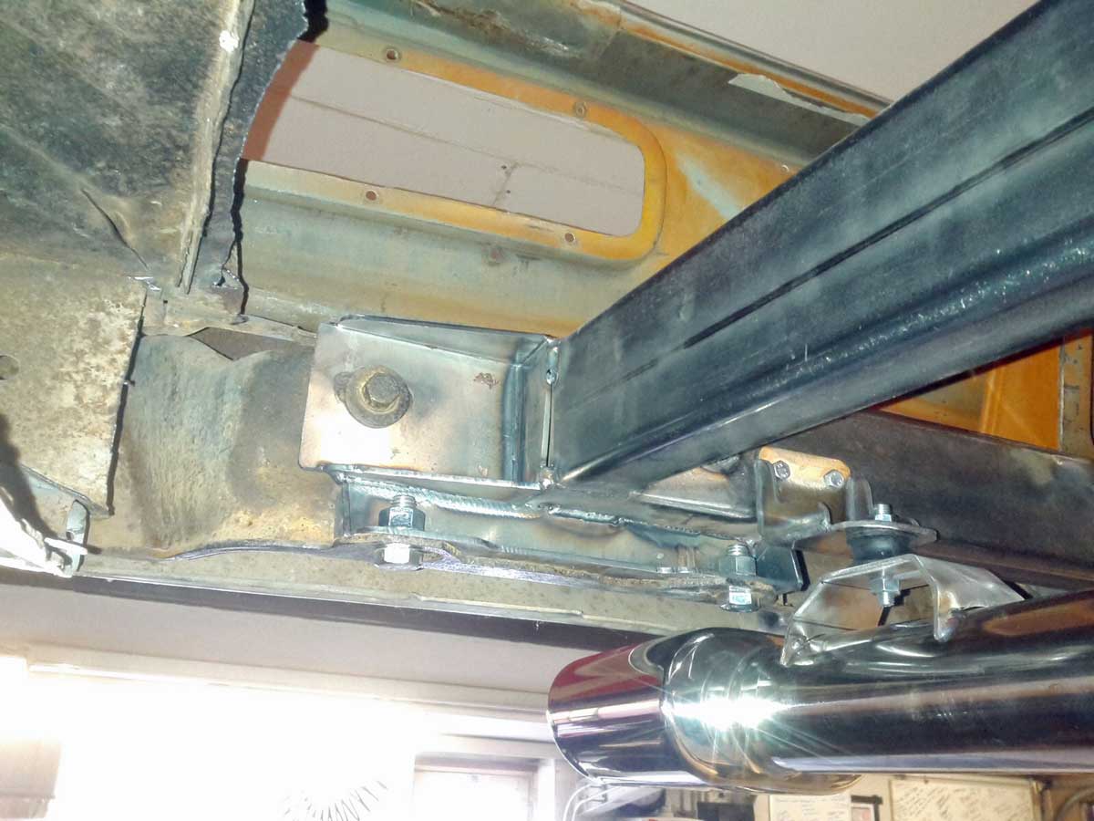

      car had had a smash at some point.this is the rear.doesnt look to bad but most of the boot floor had creased up.this is also the mounting point for the rear bumper.changed this over so the bumper bolts to the chassis now
      rear exhaust hangers
      and how it all goes together

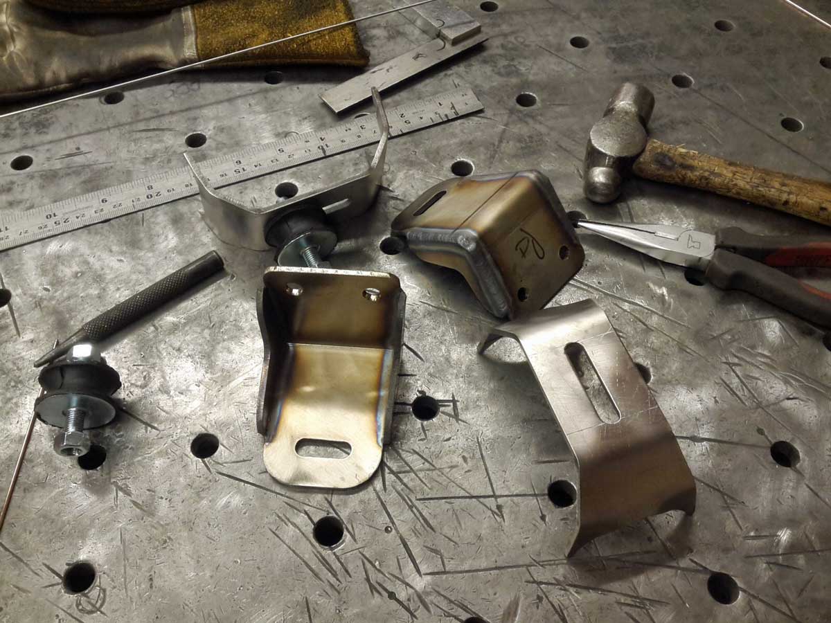

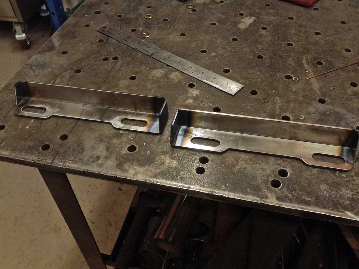

      tinwork for the rear

      awesome stuff,can you post a pic of your beadroller?? mine could never take that deepth into the metal
